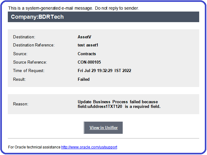

The Reverse Auto-populate (RAP) email messages will notify your if the RAP fails, during runtime, and include the following details for better traceability:
Note: The Reverse Auto-population (RAP) option can take place between different elements, if the option is included for those elements.
For Source Business Process and Destination Business Process:
- Destination Reference with BP Record number (Destination Reference: Where you have the field with a value that can change through RAP.)
- Source with Source BP Name (Source Reference: Where you have the field with a value that you can change, and as a result, update the Destination through RAP.)
- Source Reference with Source Record number
For Source Business Process and Destination P6 Activity Sheet:
- Destination Reference with P6 Activity ID (
uuu_P6ActivityId) - Source with Source BP Name
For Source Business Process and Destination Asset:
- Destination Reference with Asset Name (
uuu_asset_name) - Source with Source BP Name
For Source Business Process and Destination Planning:
- Destination Reference with Planning Item (
uuu_planning_item), if feasible - Source with Source BP Name
For Source Business Process and Destination Shell:
- Destination Reference with Shell
The following is a sample of an RAP email message that displays the changes done when a data element is reverse auto-populated.
