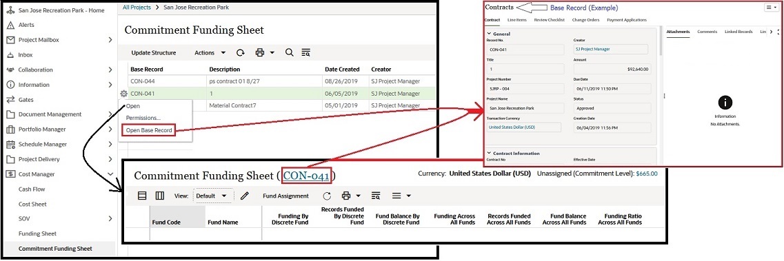

Opening a Base Record Business Process from Commitment Funding Sheet Log
You can open a base record BP by one of the following methods:
- Opening the commitment funding sheet and then clicking the BP link (<Base Record Name BP>) in title.
- Clicking, or hovering over, a row (base record) to activate the gear menu ( ) and clicking Open Base Record.
The following explains the elements of a base record BP.

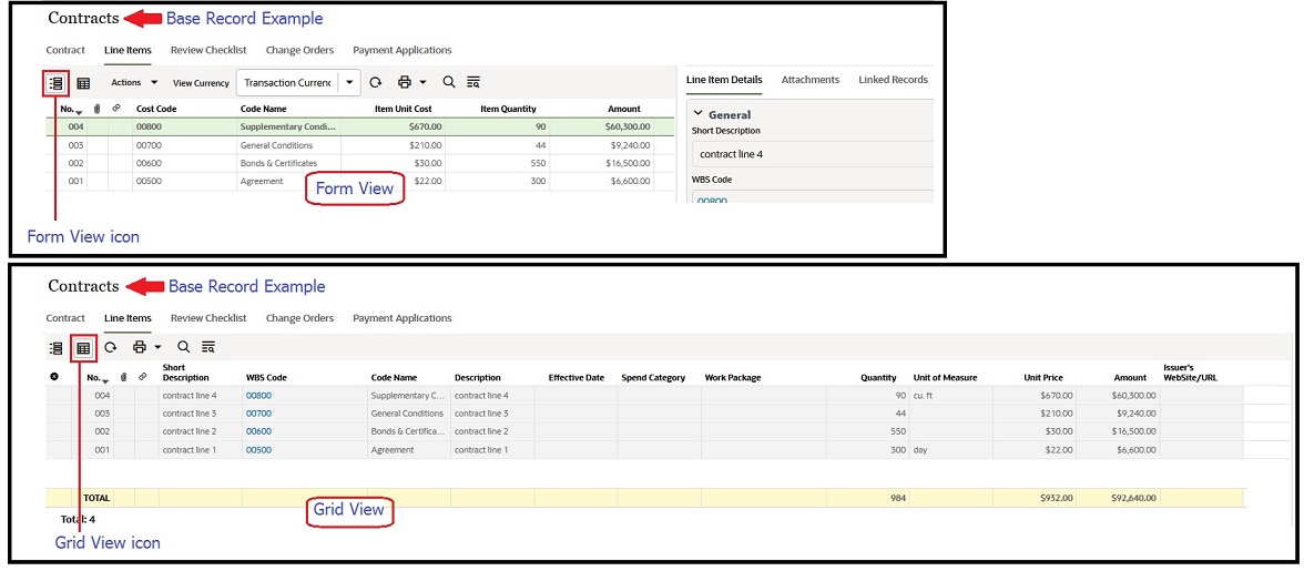

Line Items tab
| Line Item Details tab
