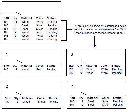

Sometimes, however, creating a record for every line item is cumbersome. You can end up with 17 records that differ in only one aspect, such as a color. For cases like this, you can group line items for auto-creation to create fewer generated records. In a simple example for a lumber yard order, you might have doors made of wood or steel, both in colors of white and red. You could group the line items according to the material (wood or steel) and color (red or white) to create fewer work order records.
