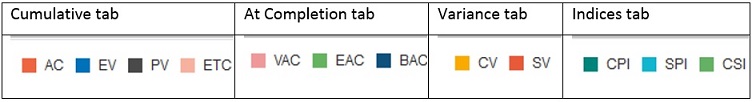

- Related EV metrics labels based on the tab. For example, in the Cumulative tab, the columns show PV, EV, AC, ETC, RC, CPI, and SPI.
The middle section of the EVA sheet contains the following tabs:
- Cumulative
- Incremental (only applicable to period based graph.)
- At Completion
- Variance
- Indices
Depending on the tab that you select, you get the pertinent graph.
Curve Picker: Filter curves you want to view by selecting or deselecting the colored boxes in the legend.
