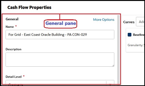

Project or Shell Cash Flow Properties (General Pane)
The following explains the fields under the General block. The next topic explains the fields under the General block: More Options.
Note: The red asterisk next to a field box indicates that the field is a required field. You will not be able to save your changes without entering a value in that field.
Under the General block, you can manage the following cash flow properties:
- Name
Enter a unique name for the curve in the Name field.
- Description
(Optional) Enter a brief description in the Description field.
- Detail Level
Select a detail level option from the Detail Level box. The selected option determines the level-of-data the cash flow curves will display. Choose one:
