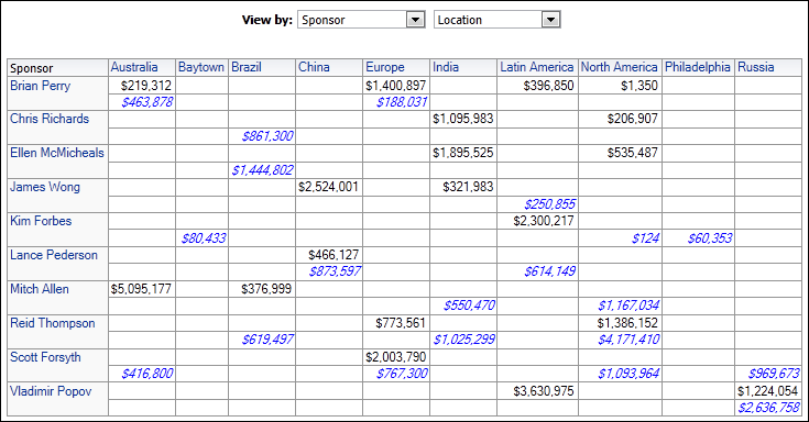

Purpose
The pivot table shows proposed and committed costs broken down by the project codes you select in the View by lists. Use the left view by list to select the project code to be used on the left side of the table. Use the right View by list to select the project code to be used across the top of the table.

Proposed Cost is displayed in blue italicized text. Committed Cost is displayed in black text.
