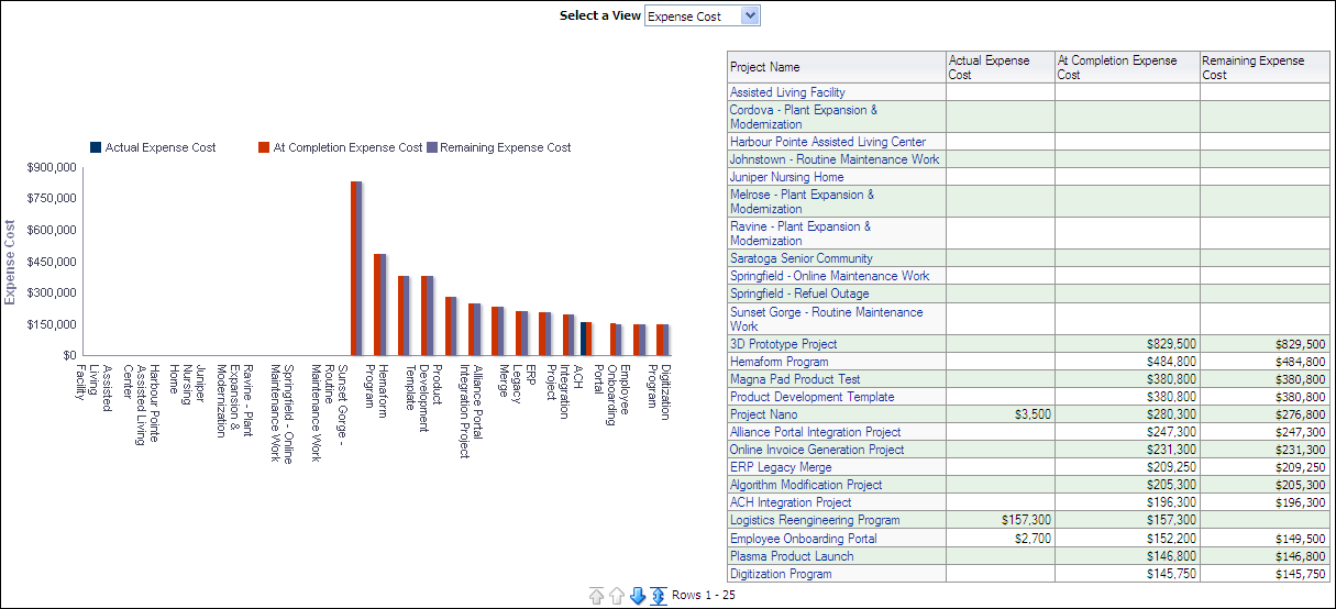

Use the Select a View list to determine how project cost information displays. The available views are:
- Expense Cost
- Labor Cost
- Nonlabor Cost
- Material Cost
- Total Cost
The bar chart and the pivot table show the same data. There are bars and columns for:
- Actual <Cost Type> Cost
- At Completion <Cost Type> Cost
- Remaining <Cost Type> Cost
In the bar chart, the x-axis shows Projects. The y-axis shows the cost type selected in the Select a View list. Hover over a bar on the chart to see specific data. The table contains columns for the same data broken down by project name.
