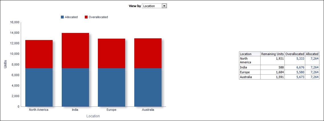

Allocation by Code Section
Purpose
The stacked bar chart shows a stacked bar for each resource code showing Allocated Units and Overallocated units. Use the View by list to select a resource code. The available codes are:
- Classification
- Location
- Plant
- Department
The x-axis shows the resource code selected in the View by list. The y-axis shows allocation Units. Hover over a bar to show specific data.
The table breaks down unit data based on the resource code selected in the View by list.
The table contains columns for:
- Remaining Units
- Overallocated
- Allocated
Table rows are determined by the View by list selection.
