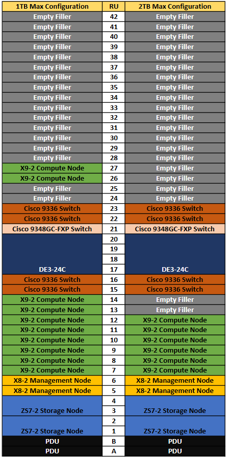

Maximium Configuration for 15kVA PDU Racks
This section describes the maximum number of compute nodes, and their locations for Oracle Private Cloud Appliance 2.4.4 Racks equipped with 15 kVA power distribution units.
                           10 — Maximum compute nodes with 512GB and/or 1TB memory configuration
                           6 — Maximum compute nodes with 2TB memory configuration
Figure 11-1 Maximium Configuration for 15kVA PDU Racks

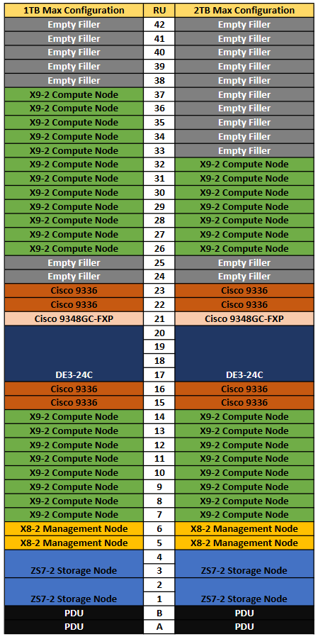

Maximium Configuration for 22kVA PDU Racks
This section describes the maximum number of compute nodes, and their locations for Oracle Private Cloud Appliance 2.4.4 Racks equipped with 22 kVA power distribution units.
                           20 — Maximum compute nodes with 512GB and/or 1TB memory configuration
                           15 — Maximum compute nodes with 2TB memory configuration
Figure 11-2 Maximium Configuration for 22kVA PDU Racks
Maximium Configuration for 24kVA PDU Racks
This section describes the maximum number of compute nodes, and their locations for Oracle Private Cloud Appliance 2.4.4 Racks equipped with 24 kVA power distribution units.
                           22 — Maximum compute nodes with 512GB and/or 1TB memory configuration
                           17 — Maximum compute nodes with 2TB memory configuration
Figure 11-3 Maximium Configuration for 24kVA PDU Racks
