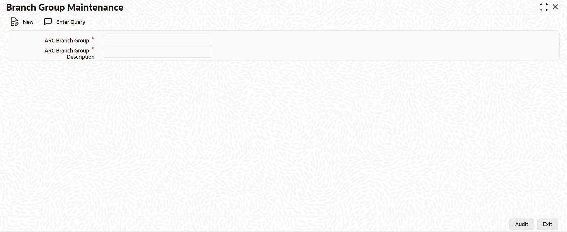

l Section 4.3.10, "ARC Branch Group Maintenance"

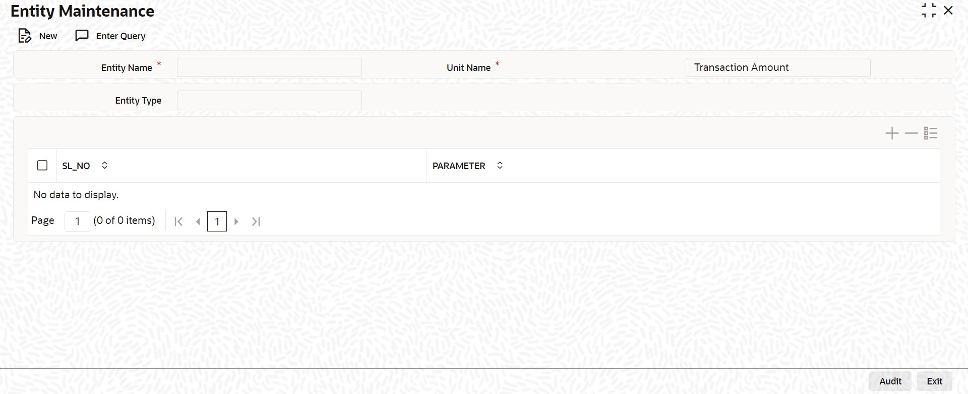

l Section 4.3.11, "Entity Maintenance"

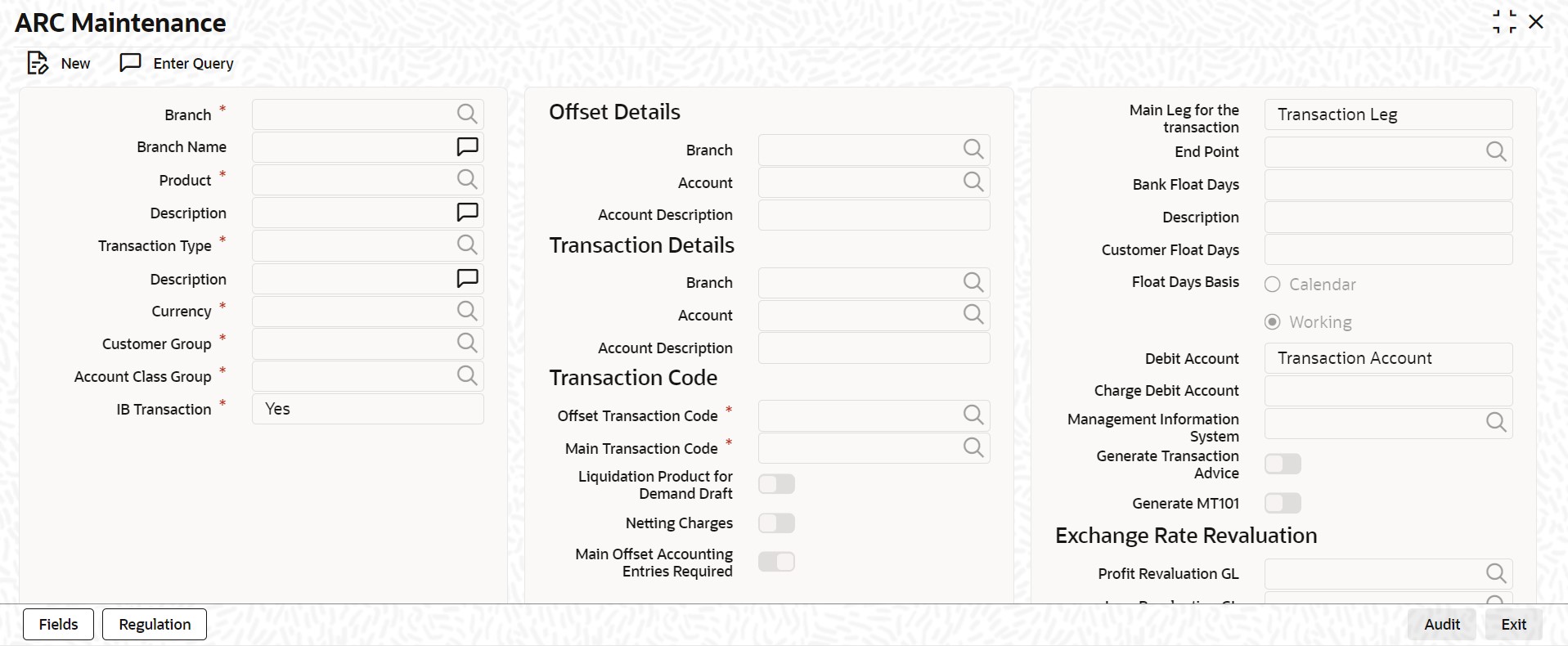

4.3.1 Invoke ‘ARC Maintenance’ screen
The ‘ARC Maintenance’ screen allows you to maintain these details for any utility product against which you process utility payments made by customers in favour of a specific utility provider.
Through this screen you can perform the following tasks while posting accounting entries related to utility payment transactions involving a utility product in Oracle FLEXCUBE:
l Specify the Accounting entry definition
l Indicate the Exchange Rate specifications for any charges
l Capture the Charges that should be levied.
You can invoke this screen by typing ‘IFDATMMN’ in the field at the top right corner of the Application tool bar and clicking on the adjoining arrow button.
The accounts details and charges details (or ARC details) can be specified to be applicable either for an account class or a product type. You need to indicate this in the ARC Maintenance screen.
If you are maintaining ARC details for a utility product and a specific utility provider (or institution), the ARC details maintained in this screen will be used for posting entries for the utility product, Institution ID and currency code combination. The institution ID is the identification of the utility provider that will be the recipient of the utility payment being made by customers.
You must maintain ARC details for each specific utility provider for whom you process customer payments made in favor of the utility provider. A unique, single set of ARC details must be maintained for each utility provider. You can, however, associate a utility product with many different ARC details sets. Therefore, you can use a particular utility product to process payments made in favor of any utility provider, but you must maintain distinct ARC details for each individual utility provider.
Since the ARC related detail are maintained at the Head Office of your bank, the details that you specify in this screen will be made applicable to all the branches of your bank.
Product
While maintaining the ARC details for a utility provider, you have to indicate the particular product that would be used to process payments made by customers in favor of the utility provider, from the available list. Each product in Oracle FLEXCUBE is identified with a unique four character alphanumeric code. You can indicate the appropriate utility product.
Currency
You must indicate the currency in which the utility provider would accept utility payments made in favor of the utility provider involving the selected utility product.
For each currency in which the utility provider accepts utility payments made in favor of the utility provider, you must maintain a separate set of ARC details in this screen.
Customer Group
Specify the customer group to define charges. This adjoining option list displays all valid customer groups maintained in the system. You can choose the appropriate one. Input to this field is mandatory.
Account Class Group
Select the account class group from the adjoining option list.
Note
If ARC is maintained for an account class group, then the charges computed is applicable for all the account classes defined under that account class group,

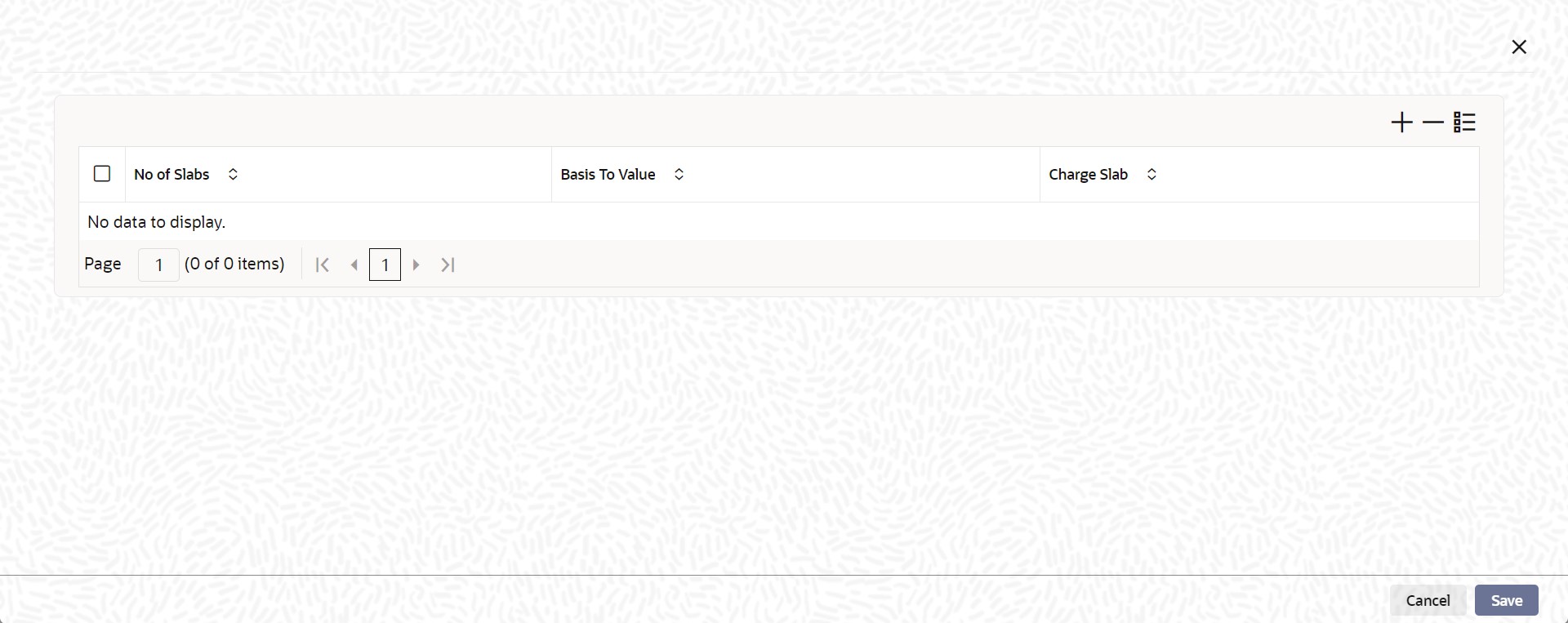

Slab Type
Select whether the Charge computation has to be over different Amount Slabs or Tiers (0-100 @ 10, 101-500 @ 15 etc.).

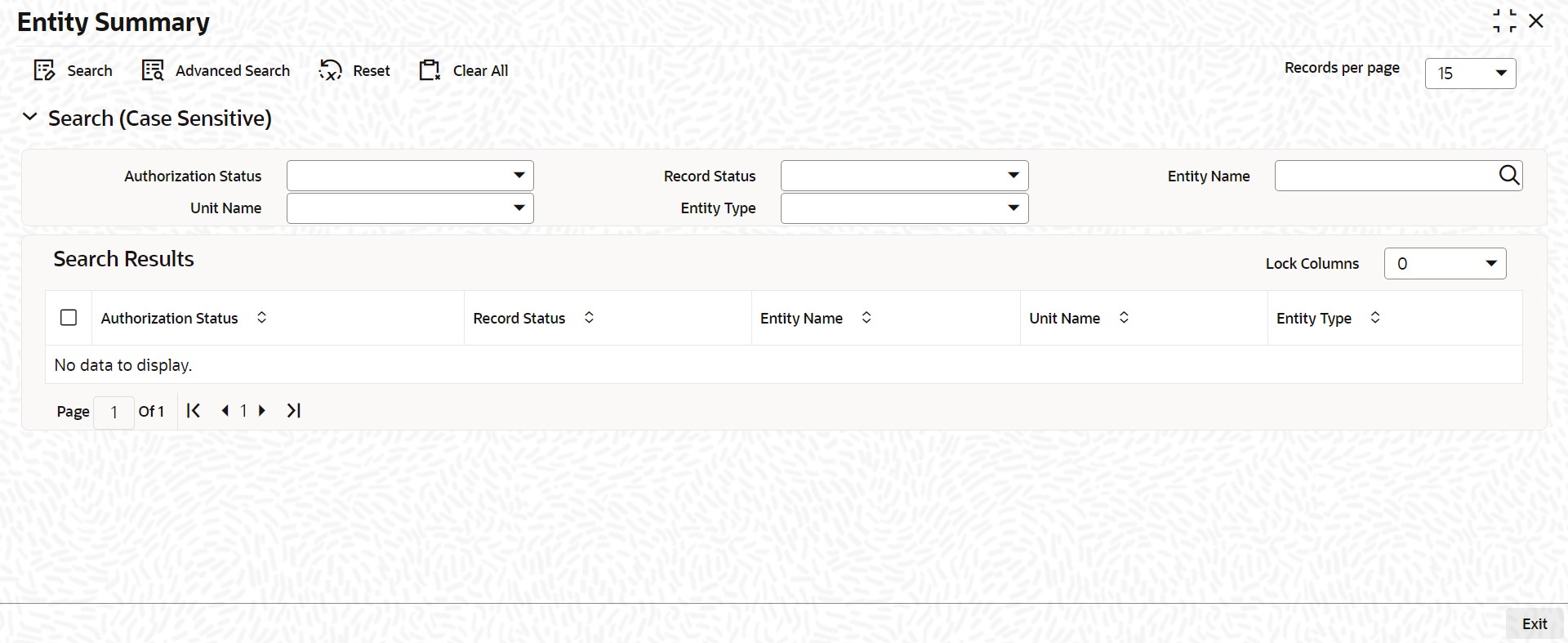

Entity Name
The field is enabled if ‘System Entity’ is selected in the ‘Basis’ field. Select the Entity Name, from the adjoining option list. The list of values are populated from the ‘Entity Maintenance’ screen (STDENMNT). Further details on the ‘Entity Maintenance’ screen is provided in subsequent sections of this chapter.

Slab Type
Select the Slab Type as Slab or Tier from the drop down list. If Slab Type is Slab or Tier, then provide the slab or tier details in the slab or tier sub-screen by clicking S button.
In this screen, you need to specify the number of slabs, the basis to value, and charge slab details.
4.3.10 ARC Branch Group Maintenance
To define branch groups which are equivalent to cities or regions that the bank operates in, invoke the ‘ARC Branch Group Maintenance’ screen by typing ‘STDBRGMT’ in the field at the top right corner of the application tool bar and clicking the adjoining arrow button.
Specify the following details in this screen:
ARC Branch Group
Specify a group code to identify a group of branches.
ARC Branch Group Description
Specify a description for the branch group.
After specifying the necessary details in the ‘ARC Branch Group Maintenance’ screen, all the ARC branch groups are displayed in the Branch Parameter Maintenance’ screen (STDBRANC). Select the branch group from the ‘ARC Branch Group field. For more information on the Branch Parameters Maintenance screen, refer section 5 ‘Branch Parameters’ in the Core Service module.
4.3.11 Entity Maintenance
In the ARC Maintenance screen, fees or charges as a percentage of the transaction amount can be calculated for transactions exceeding the restriction amount. To calculate this fee or charge, you need to select ‘System Entity’ in the ‘Basis Field’ in the ARC Maintenance screen. Thereafter, the ‘Entity Name’ field is enabled which displays values obtained from the ‘Entity Maintenance’ screen. You can invoke this screen by typing ‘STDENMNT’ in the field at the top right corner of the application tool bar and clicking the adjoining arrow button.
Specify the following in this screen:
Entity Name
Specify the entity name to be considered for Fee Maintenance.
Unit Name
Select a value for charge consideration from the drop down list. The value provided in the drop down list are as follows:
l Exceeded Amount
l Transaction Amount
During ARC Maintenance, the following scenarios are considered if exceeded amount is selected:
l If the transaction is not exceeding the restriction utilization, then the value provided is 0.
l If the transaction is exceeding the restriction utilization partially, then the portion of the transaction amount which exceeds the restriction amount, is provided.
During ARC Maintenance, the following scenarios are considered if transaction amount is selected
l If the transaction is exceeding the restriction utilization partially, then the transaction amount is provided.
l If the transaction is exceeding the restriction utilization fully, then the transaction amount is provided.
Entity Type
Select the Entity Type from the drop down list. The values provided in the drop down list are as follows:
l Null
l Restriction Code
Parameter
Select the Parameter if ‘Restriction Code’ is selected in the Entity Type field, from the adjoining option list. All active restriction codes as maintained in the system are displayed in this field. For more information on restriction code maintenance, refer to the section ‘Restriction Amount Maintenance’ in the Core Services Module.
4.3.11.1 Viewing Entity Types
You can view the entity types in the ‘Entity Summary’ screen. You can invoke this screen by typing ‘STSENMNT’ in the field at the top right corner of the application tool bar and clicking the adjoining arrow button.
You can search for entity types by specifying values in the following fields:
l Authorization Status
l Record Status
l Entity Name
l Unit Name
l Entity Type
On updating these details and clicking the ‘Search’ button, the following columns are populated:
l Record Status
l Entity Name
l Unit Name
l Entity Type
