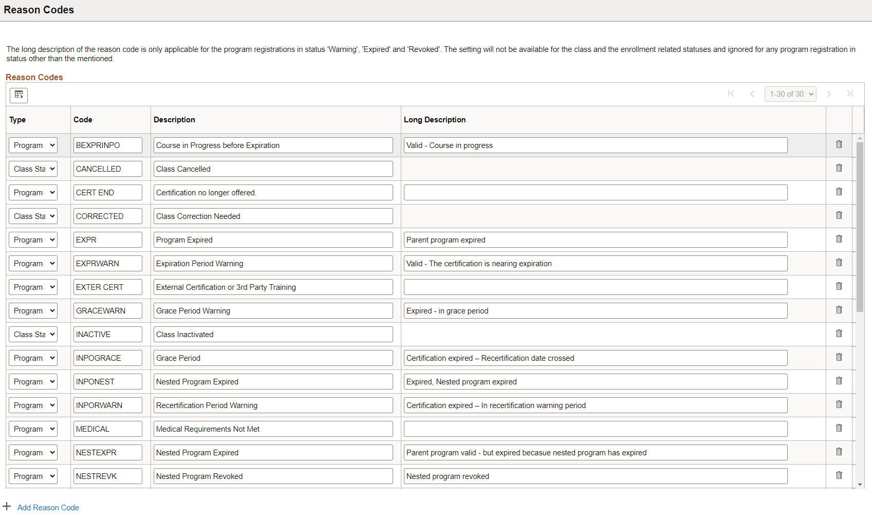

Use the Reason Codes page (LM_RSNCD_TBL) to define reasons for changing program and class statuses.
Navigation:
Set Up ELM > Catalog > Reason Codes
This example illustrates the fields and controls on the Reason Codes page.
Reason Codes page
Use this page to define reason codes that you select when updating a learner's program or class status
Field or Control
Description
Type
Select the type of reason code:
Class: Select for class inactivation reasons.
Program: Select for program status update reasons.
Code
Enter the reason code.
Description
Enter a description for the reason code.
Long Description
Enter the detailed description for the reason code. This field is displayed only if Display Status Reason is enabled in the Install Defaults – Programs Page. The field is applicable only to certification programs in Warning, Expired or Revoked statuses.

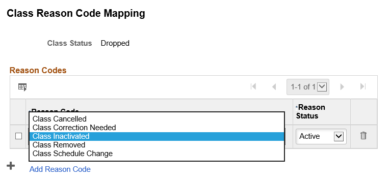

Use the Class Reason Code Mapping page (LM_CLS_RSN) for a particular class status value, to associate reasons for changing a learner's status.
Navigation:
Set Up ELM > Catalog > Class Reason Code Mapping
This example illustrates the fields and controls on the Class Reason Code Mapping page.
Class Reason Code Mapping Page
Select the reason code and reason status to associate with a given class status. The available reason codes are Class Cancelled , Class Correction Needed, Class Inactivated, Class Removed and Class Schedule Change.
