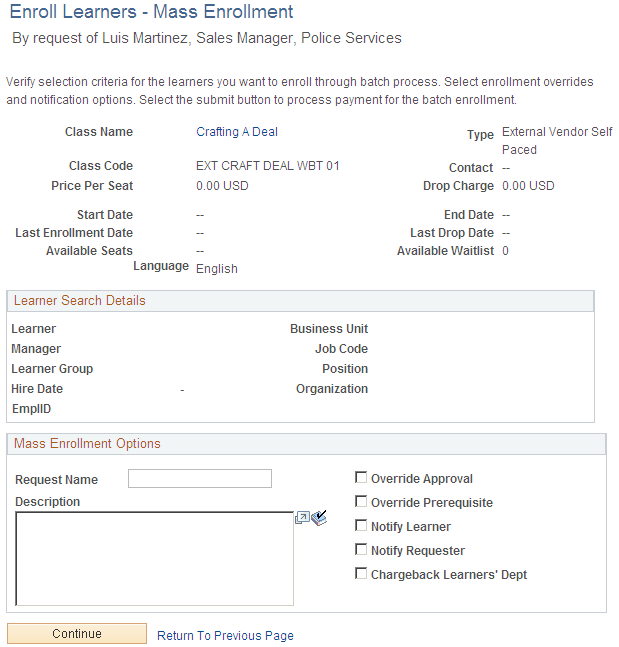

Use the Enroll Learners - Mass Enrollment page (LM_MASS_SEL_LRNR) to verify selection criteria for the learners whom you want to enroll and specify mass enrollment options such as enrollment overrides and notifications.
Navigation:
Click the Schedule Mass Enrollment button on the Group Enrollment - Warning page.
This example illustrates the fields and controls on the Enroll Learners - Mass Enrollment page.
Learner Search Details
This group box displays the search criteria that you enter on the Enroll Learners - Find Learners page.
Mass Enrollment Options
Use this group box to select mass enrollment options.
Field or Control |
Description |
Request Name |
Enter the name of the mass enrollment request. This value appears in the Description column on the Review Mass Enrollment Requests page. It is a good idea to put in an indicative label and some form of date stamp. This helps you identify the request when you review the requests later. |
Description |
Enter a description of the mass enrollment request. The system displays the information that you enter on the Review Mass Enrollment report. See Learning Reports. |
Override Approval |
Select to override manager and administrator approvals for all learners. If the class or program requires approval and you do not select this option, the system sets the enrollment or registration status for all learners to pending approval provided that the learners meet the other conditions for successful enrollment or registration. This option does not override payment approvals that the system requires when a training unit pool or purchase order has an owner assigned. |
Override Prerequisite |
Select to override required and enforced prerequisites for all learners. |
Notify Learner |
Select to send an email notification to learners informing them of their enrollment or registration statuses. When you select this check box, all learners receive a notification email regardless of whether their enrollments or registrations were successful. |
Notify Requester |
Select to send an email notification to the requester upon completion of the process. The notification includes how many learners are successfully and unsuccessfully enrolled or registered. The system generates an email that gets queued to be sent to the requester. The email provides the requester with the total number of successful and unsuccessful enrollments or registrations. |
Chargeback Learners' Dept (chargeback learners' department) |
Select to use each learner's chargeback information, rather than use the requester's chargeback information for all learners. |

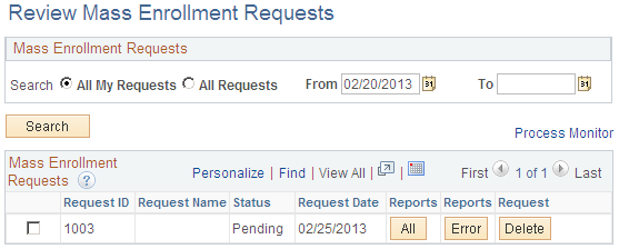

Use the Review Mass Enrollment Requests page (LM_MASS_RQST_DET) to review mass enrollment requests, delete pending requests, and view reports for processed requests.
Navigation:
This example illustrates the fields and controls on the Review Mass Enrollment Requests.
Field or Control |
Description |
Request ID |
Displays the mass enrollment confirmation ID number that the system assigned when you created the mass enrollment request. |
Description |
Displays the request name that you enter in the Request Name field on the Enroll Learners - Mass Enrollment page. |
Status |
Displays the status of the mass enrollment request. Values are: Pending: Request has not been processed. The system processes all requests with a Pending status when you run the Process Mass Enrollment Application Engine process (LM_MASS_ENRL). Processed: Request is processed. |
Request Date |
Displays the date on which you made the mass enrollment request. |
All |
Click to run the Review Mass Enrollment report. This version of the report displays all successful and unsuccessful enrollments or registrations. Note: You access and view the generated report using Report Manager (). |
Error |
Click to run the Review Mass Enrollment report. This version of the report displays only the unsuccessful enrollments or registrations. Note: You access and view the generated report using Report Manager (). |
Delete |
Click to delete an unprocessed request. You cannot delete processed requests. |
