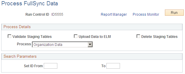

Use the Process FullSync Data page (LM_RNCTL_FULL_LOAD) to run the Process FullSync Data (LM_LD_STGDAT ) Application Engine process to validate full sync data in the staging table, load validated data into Enterprise Learning Management, and delete data from the staging tables.
Navigation:
This example illustrates the fields and controls on the Process FullSync Data page.
You can validate data, load validated data into Enterprise Learning Management, and delete data in the staging tables in separate processes or at the same time. The process runs in this order, for all selected check boxes: validate, upload, and delete.

Validate Staging Tables |
Select to validate the imported data. The process looks for data with missing required values and missing rows. For example, a person record with no name record or an employment record with no job record. The system stamps all valid data with a status of valid, and reports all errors in the process scheduler log. |
Upload Data to ELM |
Select to move validated data from the staging tables to the Enterprise Learning Management application tables. Note: The system loads all valid data, including data that is future effective-dated. However, learners who are future effective-dated do not appear in the Internal Learners search page until their effective date is current. |
Process |
Select the type of data to validate, load, or delete. Your selection here may cause other data entry fields to display on this page. |
SetID From and SetID To |
These fields appear only when you select Organization Data in the Process field. Enter the lowest and highest SetID values that you want to process. |
Employee ID From and Employee ID To |
These fields appear only when you select Person Data in the Process field. Enter the lowest and highest employee ID values that you want to process. Create unique employee ID ranges and run these ranges in separate processes, being mindful of the human resource database's collation sequence (for example, how it sorts data). The process is designed to run multithreaded, utilizing temporary tables to reduce contention. The groups of IDs must be unique have no overlap. Note: Consider having a technical person use SQL queries to verify that the ID ranges are unique and encompass all employee IDs. To identify your system's employee ID range, use the following SQL statements: SELECT MIN(LM_HR_EMPLID), MAX(LM_HR_EMPLID) FROM PS_LM_STG_PRS —for person load, and SELECT MIN(LM_HR_EMPLID), MAX(LM_HR_EMPLID) FROM PS_LM_STG_PRS_ATT —for workforce load. |
Delete Staging Tables |
Select to delete the full sync data from the staging tables. This option uses a truncate command on supported platforms, and uses a delete command otherwise. Note: For organizations with large database volumes of approximately 50,000 employees or more, and no truncate support, have a database administrator drop and recreate the staging tables. Dropping and recreating the tables is more efficient than using the delete command. |

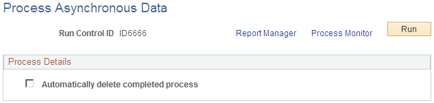

Use the Process Asynchronous Data page (LM_RNCTL_ASYNC) to run the Process Asynchronous Data (LM_LD_ASYNC) Application Engine process to validate asynchronous data in the staging tables, load validated data into Enterprise Learning Management, and delete data from the staging tables.
Navigation:
This example illustrates the fields and controls on the Process Asynchronous Data page.
When you process asynchronous data, the system automatically validates all data in the staging table and loads the validated data. To have the system delete the incremental sync data in the staging table after it loads the data, select the check box labeled Automatically delete completed process.
