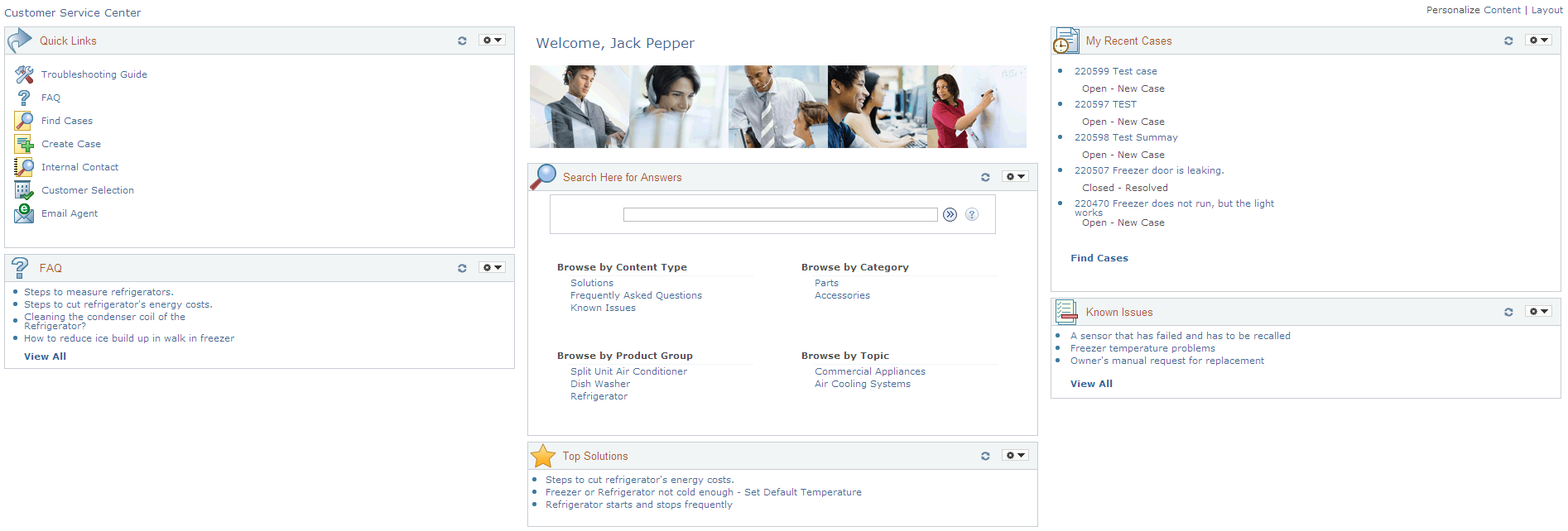

This example illustrates the fields and controls on the Customer Service Center home page.

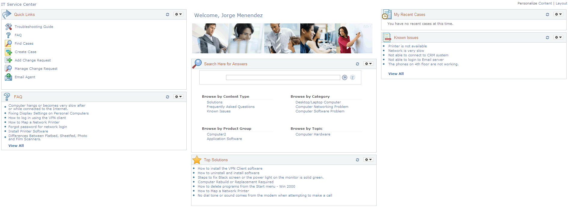

Use the IT Service Center home page to select a PeopleSoft Help Desk self-service application transaction.
Navigation:
  • IT Service Center
  • Employee Self Service > Help Desk > IT Service Center
This example illustrates the fields and controls on the IT Service Center home page.

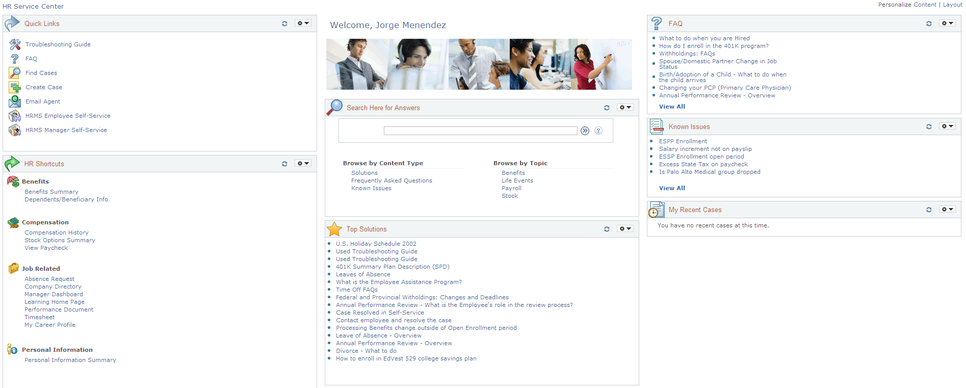

Use the HR Service Center home page to select a PeopleSoft HR Help Desk self-service application transaction.
Navigation:
  • HR Service Center
  • Employee Self Service > HR Help Desk > HR Service Center
This example illustrates the fields and controls on the HR Service Center home page.

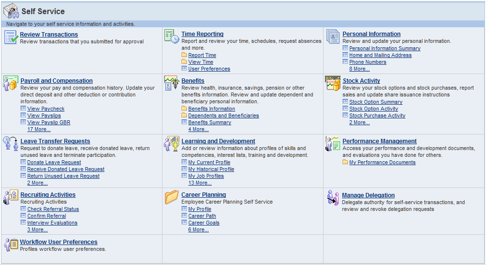

This example illustrates the fields and controls on the HCM Employee Self-Service Home page (PeopleSoft HCM).
Self Service home page (PeopleSoft HCM)

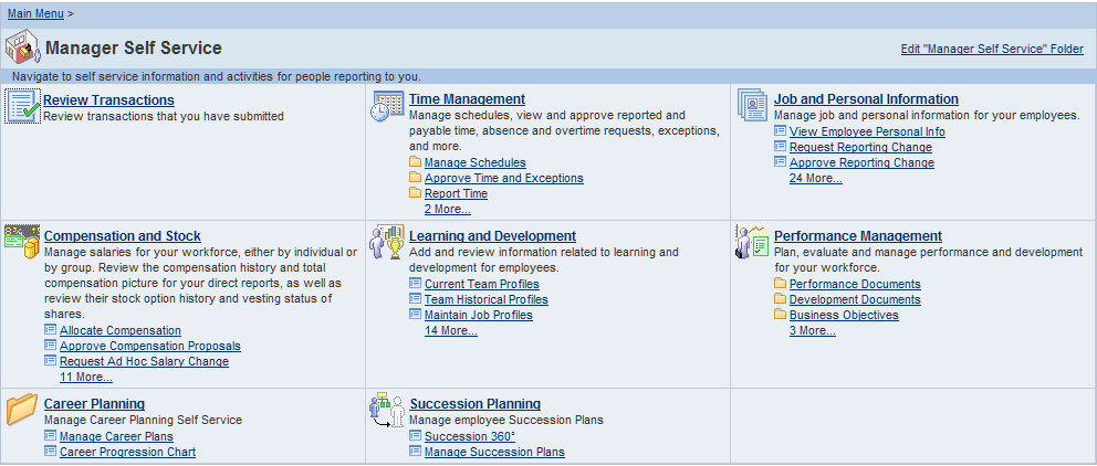

Use the HCM Manager Self-Service home page to select a manager self-service application transaction in PeopleSoft HCM.
Navigation:
  • Click the HCM Employee Self-Service link in the Quick Links section on the HR Service Center home page.
  • Employee Self Service > HR Help Desk > HCM Employee Self-Service
This example illustrates the fields and controls on the Manager Self-Service home page (PeopleSoft HCM).
Manager Self Service home page (PeopleSoft HCM)
Click the links on these pages to access self-service transactions in PeopleSoft HCM.

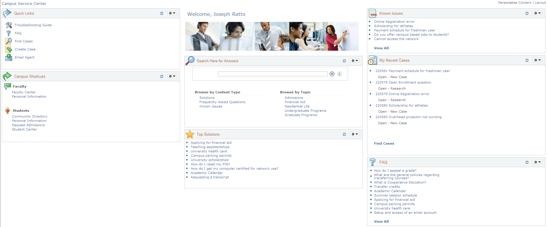

Use the Campus Service Center home page to select a PeopleSoft Service Center for Higher Education self-service application transaction.
Navigation:
  • Campus Service Center
  • Service Center > Campus Service Center
This example illustrates the fields and controls on the Campus Service Center home page.

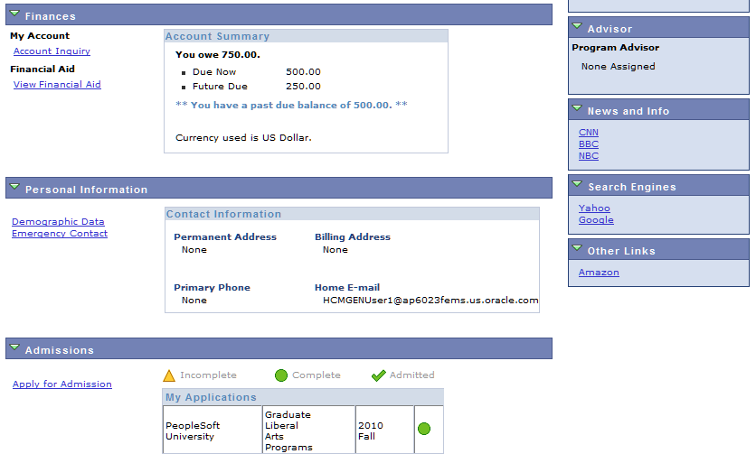

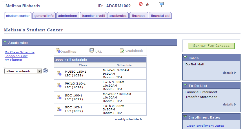

This example illustrates the fields and controls on the Student Center page (1 of 2) [PeopleSoft Campus Solutions].
This example illustrates the fields and controls on the Student Center page (2 of 2) [PeopleSoft Campus Solutions].
Click the links on this page to access self-service transactions in PeopleSoft Campus Solutions.

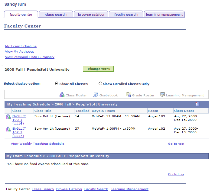

Navigation:
Click the Faculty Center link in the Campus Shortcuts section on the Campus Service Center home page.
This example illustrates the fields and controls on the Faculty Center home page (PeopleSoft Campus Solutions).

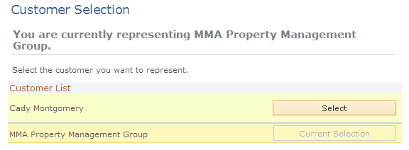

Use the Customer Selection page (CUST_SELECT) to select a customer to represent in PeopleSoft Customer Service Center and Campus Service Center self-service application transactions.
Navigation:
Service Center > Customer Selection
This example illustrates the fields and controls on the Customer Selection page.
Use this page if you have more than one role in Customer Service Center or Campus Service Center. Click the Select button to choose the role that you wish to be used when accessing a Service Center for Higher Education self-service case.
If you have multiple roles and you do not access this page to select the desired role to be used for Customer Service Center or Campus Service Center self-service cases, the system will default your role by using the first role found for you in this hierarchy:
  • Worker.
  • Consumer (Constituent).
  • Company Contact.
