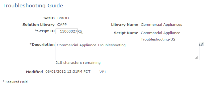

Use the Troubleshooting Guide page (RBT_TGUIDE_SETUP) to identify troubleshooting guide scripts that customers can access through self-service applications.
Navigation:
This example illustrates the fields and controls on the Troubleshooting Guide page.
Field or Control |
Description |
Script ID |
Select the script to run when the self-service application user selects the solution library. Because each library is associated with a single script, you must create additional libraries for each script that you want to make available to self-service application users on the Customer Care - Troubleshooting Guide page. |

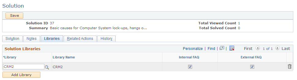

Use the Solution - Libraries page (RC_SOLN_LIBRARY) to create solution libraries.
Navigation:
This example illustrates the fields and controls on the Solution - Libraries page.
Select the External FAQ check box to make the solution available to self-service users as a Frequently Asked Question.
Solution libraries are set up in a similar manner across many PeopleSoft CRM applications.
