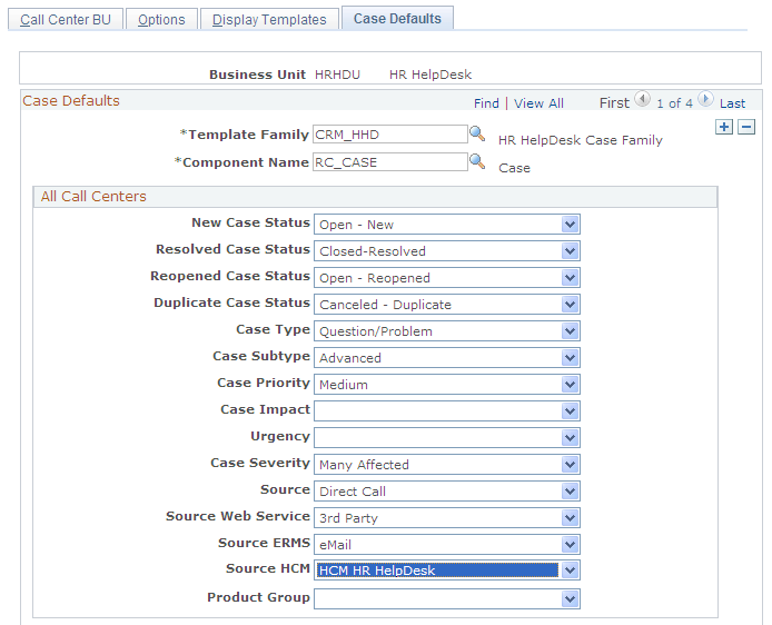

Use the Case Defaults page to configure a default case source for the business unit for which you want to enable the automatic case creation.
For example, if you are enabling automatic case creation for the business unit HRHDU, edit the record for HRHDU business unit to set the value of Source HCM field to HCM HR HelpDesk
Navigation:
This example illustrates the fields and controls on the Case Defaults page. You can find definitions for the fields and controls later on this page.

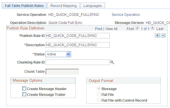

Access the Full Data Publish Rules page and edit the full data publish rule configured for the HD_QUICK_CODE_FULLSYNC service operation and make the changes listed below:
Enter HD_QUICK_CODE_FULLSYNC in the Publish Rule ID and Description fields.
Select Active in the Status field.
Clear the Create Message Reader and Create Message Trailer check boxes.
Navigation: Enterprise Components, Integration Definitions, Full Data Publish Rules
This example illustrates the Full data publish rules configuration for automatic case creation.

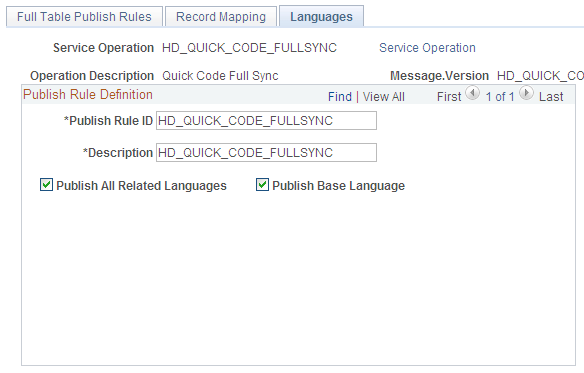

Click the Languages tab of the Full Data Publish Rules page and select the following check boxes:
Publish All Related Languages
Publish Base Language
This example illustrates the Full data publish rules - Languages configuration for automatic case creation.

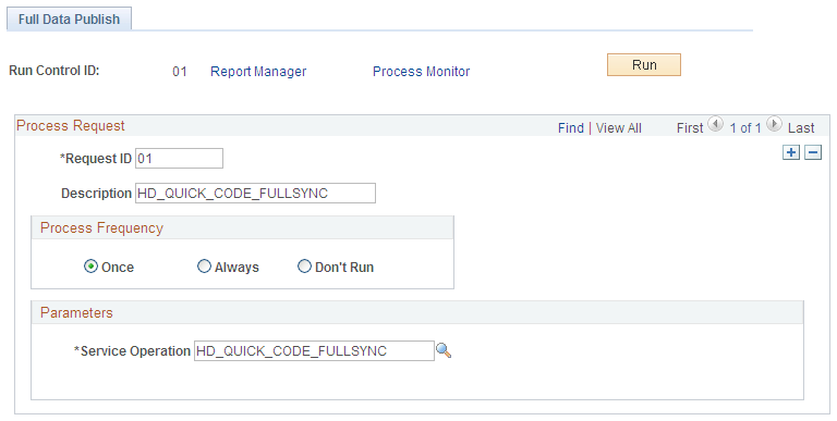

Access the Full Data Publish page and add a new run control for the HD_QUICK_CODE_FULLSYNC service operation.
Enter an identifier in the Request ID field.
Select Once in the Process Frequency check box.
Search and select HD_QUICK_CODE_FULLSYNC in the Service Operation field.
Navigation: Enterprise Components, Integration Definitions, Initiate Processes, Full Data Publish
This example illustrates the Full Data Publish page.
Click the Run button and check the Process Monitor to see if the Full Data Publish process (EOP_PUBLISHT) is completed successfully.

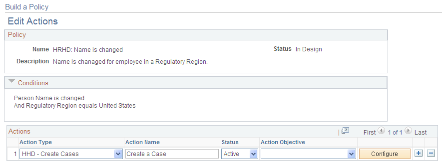

Open the AAF policy for the automatic case creation in design mode.
Navigation: Enterprise Components, Active Analytics Framework, Policies, Manage Policies.
Click the Edit Actions button in the Actions section. This opens up the Edit Actions page.
This example illustrates configuring the actions on the Edit Actions page.

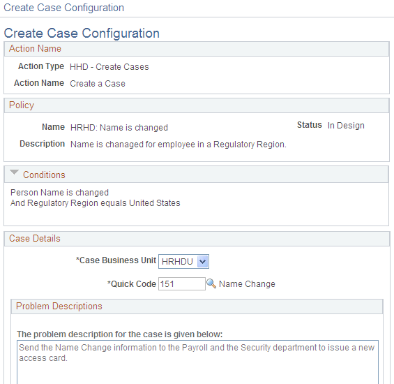

On the Edit Actions page, click the Configure button in the Actions section. This opens the Create Case Configuration page.
This example illustrates the Create Case Configuration page. You can search and select quick codes on this page.
Select HRHDU in the Case Business Unit field and search for quick codes in the Quick Code field. Verify whether all configured quick codes in CRM are listed.
