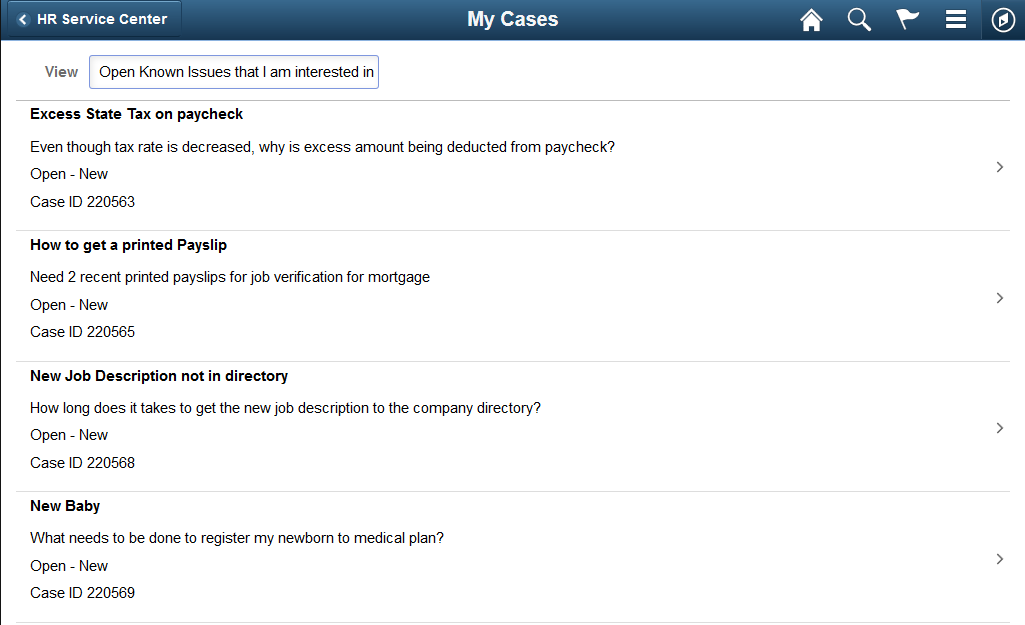

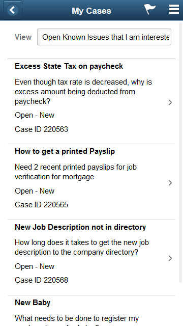

The predefined searches available are:
All known issues that I am interested in
All cases that I am the contact for
All my cases
All my cases related to Program/Service
All my open cases
Cases that I reported for others
Open known issues that I am interested in
Open cases that I am the contact for
Open cases that I reported for others
Navigation:
Click the My Cases tile available on the HR Service Center dashboard.
Click the My Cases button available on the Case Submitted page.
Note: My open cases is the default view when the employee clicks on the My Cases tile and is taken to the corresponding page.
This example illustrates the fields and controls on the My Cases page for the tablet.
This example illustrates the fields and controls on the My Cases page for the smartphone.

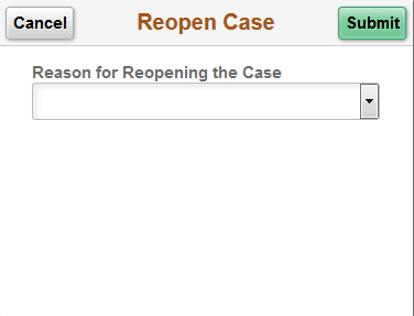

Reopen Case |
Click the Reopen Case button to reopen cases that are closed. User is allowed to reopen a case based on configuration settings. If user is not allowed to reopen case, then the Reopen Case button is not displayed in the Case Details page. On clicking this button, user is presented with a Reopen Case modal window (RC_SS_REOPEN_SCF). |
This example illustrates the fields and controls on the Reopen Case modal window.
Field or Control |
Description |
Reason for reopening the case |
Select one of the predefined reasons for reopening the case from the drop-down list box. The available reasons include the following:
If the user wants to enter a free-form text reason, select ‘Other’, and enter the reason in the Details field. |
Submit |
Click this button to reopen the case. When the user clicks this button, the system changes the case status to the value that is specified in the Reopen Case Status field on the Case Details page. |

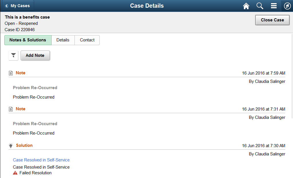

Case Details Page: Notes and Solutions Tab
Use Case Details page: Notes and Solutions tab (RC_SS_UPDATES_FL) to view the most recent Notes and Solutions added to the case by the agent or employee (or an eligible case contact). User can view the solution summary, description, and status. User can add a Note or select a view that shows only notes, solutions or both. It is also possible to attach one or more files to the note.
Navigation:
On the Case Details page, click the Notes and Solutions tab.
This example illustrates the fields and controls on the Case Details Page: Notes and Solutions tab for the tablet.

Click the solution summary to view the details corresponding to that solution. User is also provided with an option to email the solution to themselves or others; and can view how many people find this solution as helpful.

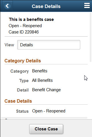

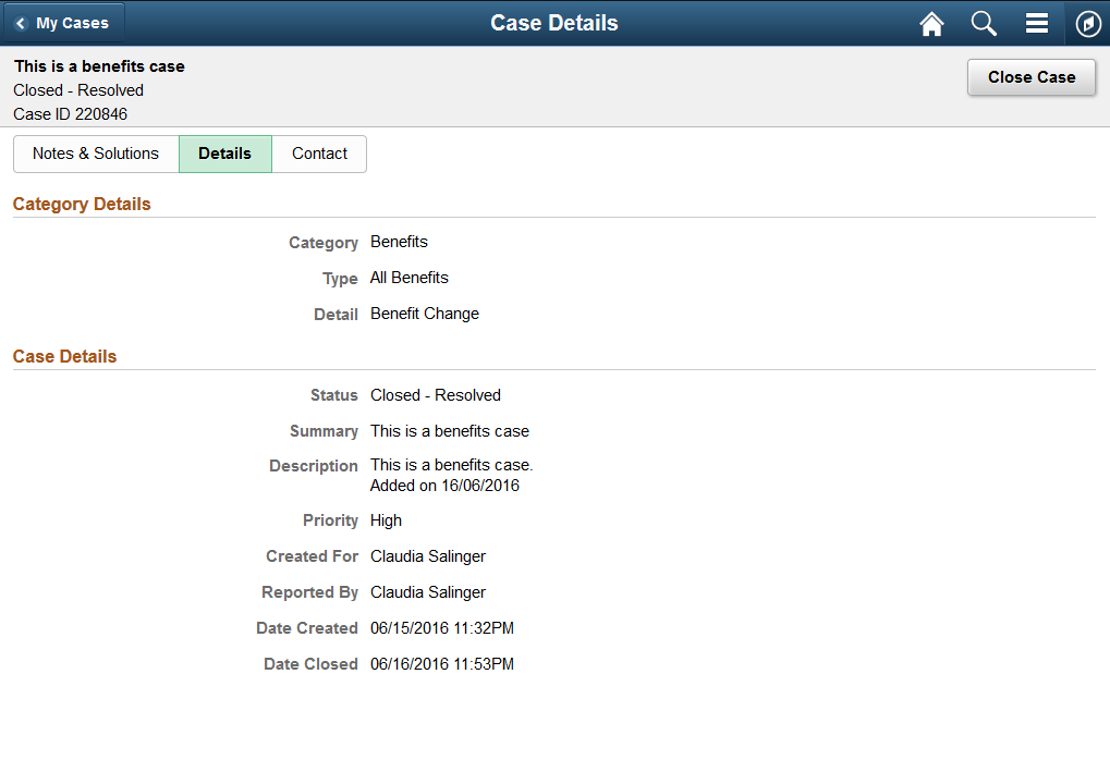

Case Details Page: Details Tab
Use Case Details page: Details tab (RC_SS_DETAILS_FL) to view the case details such as category, status, summary, and the like.
Navigation:
On the Case Details page, click the Details tab.
This example illustrates the fields and controls on the Case Details page: Details tab for the tablet.
This example illustrates the fields and controls on the Case Details page: Details for the smartphone.

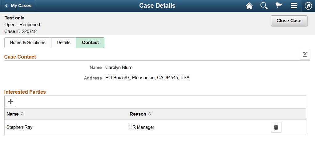

Case Details Page: Contact tab
Use the Case Details Page: Contact tab (RC_SS_CONTACT_FL) to view the contact person for the particular case and allows the employee to edit the case contact. User can add or remove interested parties to their case. The tab also displays the interested parties added by the user or agent.
Navigation:
On the Case Details page, click the Contact tab.
This example illustrates the fields and controls on the Case Details Page: Contact tab for the tablet.
This example illustrates the fields and controls on the Case Details Page: Contact for the smartphone

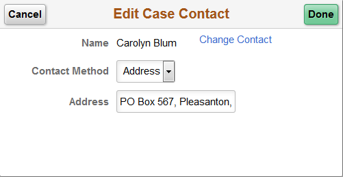

Click this button to go to the Edit Case Contact modal window (RC_SS_HD_CNTC_SCF), wherein user can change the contact details such as phone number, email, or address specified for a case. You can also select another employee as case contact and modify their contact details. |
This example illustrates the fields and controls on the Edit Case Contact modal window.
You can change contact information when you are creating a new case or viewing an existing case.
On the Create Case page, the Change Contact link is available only until the case is submitted. After submitting the case, use the Edit Case Details Page to change the contact information.

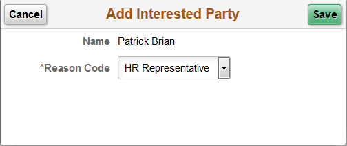

Click the Add Interested Party button to select the employee and go to the Add Interested Party modal window (RC_SS_INTPARTY_SCF).
Select the reason for adding the interested party, and click the Save button to add an interested party to the case.
