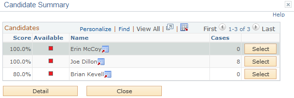

Use the Candidate Summary page (RF_ASSIGN_DET_SEC) to review the group member search result (detail view).
You can select a group member that you can assign to a service order or a case from here as well.
Navigation:
  • On the Service Order - Activities page in PeopleSoft FieldService, click the Suggest Group Member button.
    Click the Detail link if the Candidate Summary page appears.
  • On the Case page in PeopleSoft Support or HelpDesk, click the Suggest an Agent button.
  • On the Dispatch Board page, click the Suggest Group Member button.
This example illustrates the fields and controls on the Candidate Summary page.
The Candidate Summary page lists the members in the provider group who matched at least one assignment criteria value on the case or service order, or all provider group members if you select the Display Provider Groups and Group Members with no Criteria Matches check box on the Assignment Setup page. For support and help desk cases, the system shows the number of open cases that are currently assigned to each group member on the list.
Note: You must specify a provider group on the case or service order before performing a search on group members.
Field or Control
Description
Detail
Click to access the Candidate Detail page and view the assignment weight factors that are used to calculate the total fit scores.

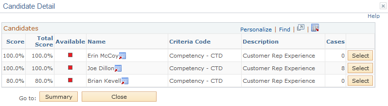

Use the Candidate Detail page (RF_ASSIGN_LIST_SEC) to review the group member search result (summary view) and select group members that you can assign to a service order or a case.
Navigation:
    Click the Summary link if the Candidate Detail page appears.
This example illustrates the fields and controls on the Candidate Detail page.
Field or Control
Description
Summary
Click to return to the Candidate Summary page.
Criteria Code
Displays the assignment criterion on the case or service order that the candidate matched. Associate values for each criteria code with workers on the Assign Criteria page in the Worker component.
