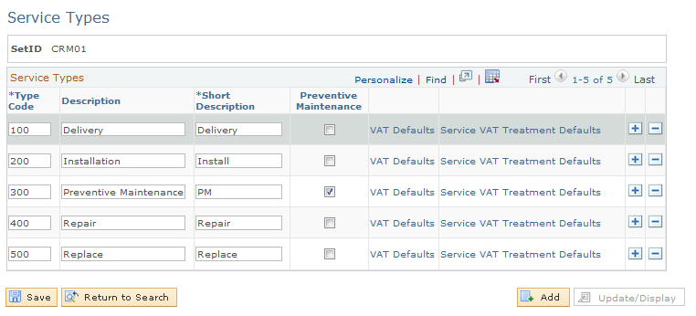

This example illustrates the fields and controls on the Service Types page.
Service Types
Lists the service types that are defined for the specified setID.

Type Code |
Enter a code to identify the service in the system. You can use up to eight alphanumeric characters. |
Description and Short Description |
Enter the long and short descriptions for the service type. When you reference a service type on a service, the value that is entered for short description appears on the Service page. |
Preventive Maintenance |
Select to indicate that services that belong to this service type are eligible for preventive maintenance functionality in PeopleSoft Integrated FieldService. The system issues a warning if you clear the Preventive Maintenance check box for service types (namely to change service types back to a regular, non-preventive maintenance kind) under which services are already defined. You can then decide whether to let the system automatically delete all preventive maintenance-related information from the associated services or leave these service records intact for manual update in the future. |
