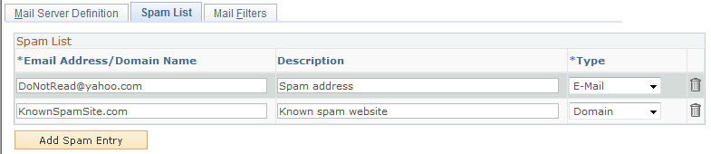

Use the Spam List page (RB_SPAM_LIST_DEFN) to set up address-based and domain-based filters.
Navigation:
Set Up CRM > Product Related > Multichannel Definitions > Email > Define Servers and Security > System Parameters/Defaults > Spam List
This example illustrates the fields and controls on the Spam List page. You can find definitions for the fields and controls later on this page.
Spam List page
Field or Control
Description
Email Address/Domain Name
Enter a full email address or a domain name from which you want to block all email.
Type
Select Email or Domain to indicate the type of address being blocked.
Note: To activate the filters that you set up on this page, access the Mail Filters page and ensure that the delivered SYS_SPAM_LIST filter is active.

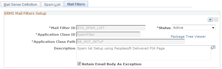

Use the Mail Filters page (RB_ERMS_SETUP) to activate the filters that you set up on the Spam List page, and apply your own custom email filters.
Navigation:
Set Up CRM > Product Related > Multichannel Definitions > Email > Define Servers and Security > System Parameters/Defaults > Mail Filters
This example illustrates the fields and controls on the Mail Filters page. You can find definitions for the fields and controls later on this page.
Mail Filters page
Field or Control
Description
Mail Filter ID and Description
Enter a name and description for your custom mail filter.
PeopleSoft delivers a mail filter with the ID SYS_SPAM_LIST. This filter blocks email from the addresses and domains that you enter on the Spam List page. You cannot edit or delete the data for this filter.
Status
Select to activate the mail filter. The email addresses and domain filters that you set up on the Spam List page are active only if you activate the SYS_SPAM_LIST filter here.
Application Class ID, Package Tree Viewer, and Application Class Path
Enter the ID and path for an application class that performs custom mail filtering. Click the Package Tree Viewer link to access the Application Packages Lookup page, where you can browse for application classes and select one to use.
Retain Email Body As Exception
Select to have the ERMS mail reader process to save the text of any email that has been blocked by this filter. The blocked email is not routed for handling, but an administrator can review the blocked emails on the Exception Email Details page.
If this option is cleared, you can still review summary information about the email on the Mail Reader Process Log page, but you will not be able to view the email's body text.
