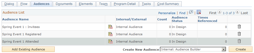

RYE_AUDIENCE |
Use to select existing audiences for the dialog or to define new audiences. |

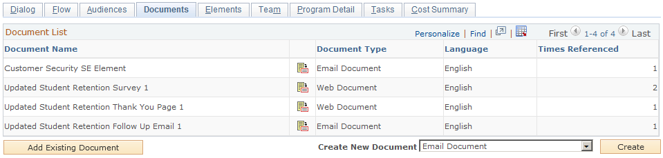

RYE_DOCUMENTS |
Use to associate existing documents with the dialog or to define new documents. |

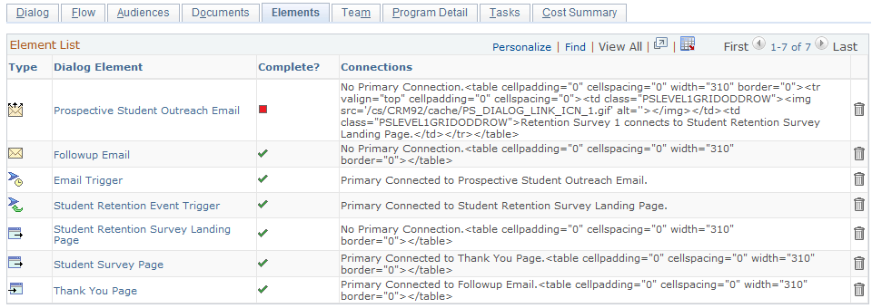

RYE_ELEMENTS |
Use to manage the objects in the Dialog Designer interface. |

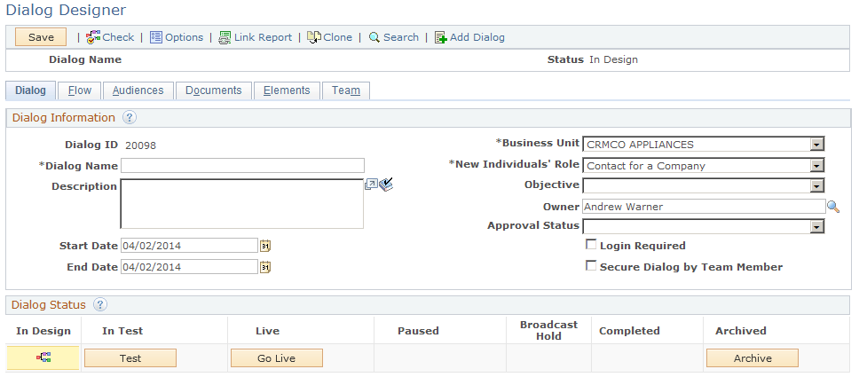

Use the Dialog Designer - Dialog page (RY_DIALOG) to use to specify general information about a dialog.
Navigation:
. Click the Add Dialog button on the Dialog Designer page.
Note: When creating dialogs you should not attempt to work on the same dialog using multiple open browsers, as this can cause data inconsistency.
This example illustrates the fields and controls on the Dialog Designer - Dialog page.
Field or Control |
Description |
Business Unit |
Specify the business unit under which the dialog will reside. Note: The business unit of the dialog dictates which audiences and documents can be used with the dialog. By default, the business unit is the one that has been specified in User Preferences. |
Dialog Name |
Specify a name for the dialog. Names can contain a maximum of 75 characters and must be unique. |
Description |
Specify a brief description of the dialog. You can include up to 254 characters. |
Objective |
The dialog's purpose. This field is only available when PeopleSoft Marketing has also been licensed; the available objectives correspond to Marketing objectives. The available values are dependent on the Business Unit that has been entered for the dialog. |
New Individuals' Role |
Denotes the marketing role that a new user (individual or organization) is assigned when created if no information exists to place the user in a specific role. The values are dependent on roles defined during the setup of marketing roles; default delivered values are Consumer, Contact for a Company, Worker, and Person of Interest. Use Consumer if the dialog is business-to-consumer (aimed at individuals who have no associated organization). Use Contact for a Company if the dialog is business-to-business (usually aimed at individuals who are contacts for an organization). If Contact is specified, be sure that the associated organization has been identified and defined before creating the dialog. If the contact is for a company, a Company field must exist on a document somewhere in the dialog. The system looks for a match for the specified company in the database, using the predefined matching rules. If more than one match is found, the system associates the new contact with the first match. If no match is found, both the contact and the company are created. Use Worker if the dialog is aimed at employees of your organization. Be aware that, despite the field's label, if you choose Worker, you will only be able to update existing users, not create new ones. This is because new workers should not be inserted via the Online Marketing application, but rather via more appropriate sources such as PeopleSoft HCM. Use Person of Interest if the dialog is aimed at persons of interest to your organization who are not employees (for example, contractors or former employees who have retired). You cannot create new users if you choose this option. If you need to change the role after the dialog has launched, you can place the dialog in Paused or Broadcast Hold state, change the role, then change the state back to Live. This change will not affect any respondents who have already submitted pages, but subsequent respondents will be assigned the new role. Note: A dialog cannot target both consumers and contacts, because all individuals within a dialog need to be inserted with the same role. If, for example, you want to target both consumers and contacts with the same promotion, you can do so by cloning the dialog and executing one dialog to the consumer audience and the second to the contact audience. New organizations are automatically assigned to the Company role. Refer to the documentation on how new individuals and organizations are handled, following this section. |
Start Date |
The date at which the dialog will begin running. Note: This date is only for informational purposes and does not affect when the dialog will be running. The actual timeframe is based on the triggers in the dialog. |
End Date |
The date on which the dialog will stop running. Note: This date is only for informational purposes and does not affect when the dialog will be running. The actual timeframe is based on the triggers in the dialog. This date does not automatically shut down a dialog; the dialog must be moved to the status of Complete or Archived manually. |
Owner |
The user who owns the dialog. This field defaults to the currently logged in user, but you can change it by clicking the prompt to display a list of users. |
Approval Status |
The dialog's current approval status. The statuses are Requested, Approved, or Rejected; depending on what permissions you have, you might not see all of these statuses. Using the Approval Status is optional and can be turned on and off on the Dialog Business Unit (Set Up CRM, Business Unit Related, Dialog Definition). |
Login Required |
If this option is selected, the user must log in using Self Service before they can access the dialog's Landing Page. This is used in conjunction with the CRM/Campus Solutions integration. Note: Using the Login Required option deciphers the BO_ID for the contact, but not for the company. In order for any update to company custom profiles to take place, the company name must be present on the page. If it is not present, the data will be ignored due to the fact that matching rules are not satisfied. The company name can be set to pre-fill; if the contact is associated with one company, this is all that is required. However, if the contact is associated with multiple companies, any one of those companies will be filled in the company name field. If you want to update a different company, then you must enter the value exactly as it appears in the database (including spaces and case). If there is any mismatch in the company name between the existing company and the newly entered company name, then a new company is created. |
Dialog Status |
Displays the dialog's lifecycle, showing the different stages of development and which stage(s) the dialog can progress to. If a Live version and an Edit version exist, both versions' statuses are shown. |
Note: A new dialog always belongs to the currently active business unit. If you want the dialog to belong to multiple business units, you must create it in each one. Dialogs belonging to different business units are updated independently.

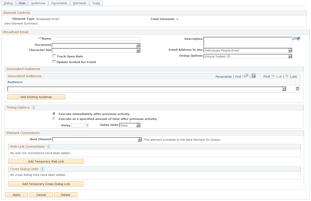

BE |
Broadcast Email |

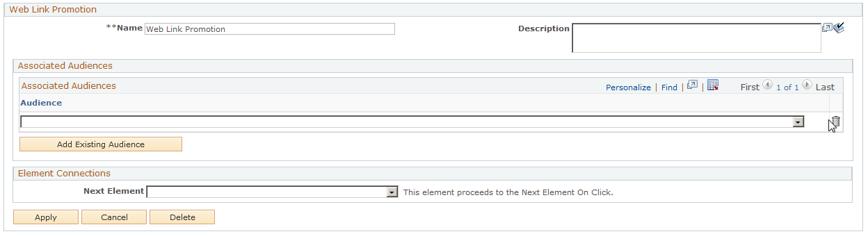

WL |
Web Link Promo |

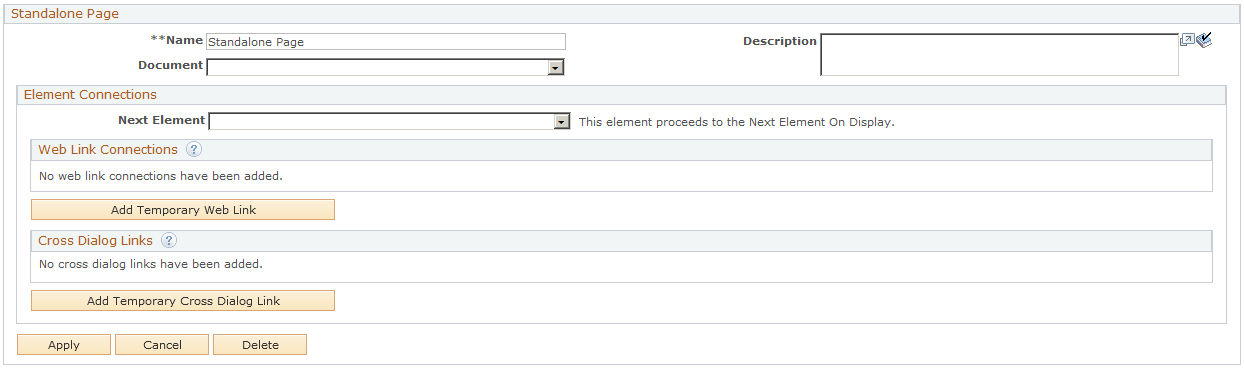

Standalone Page |
Web Link Promotion |
Broadcast Email |

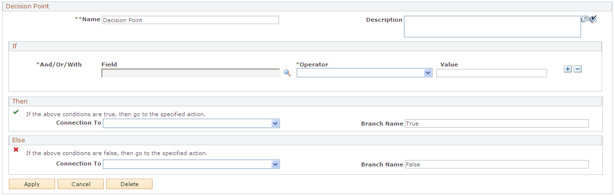

Decision Point |

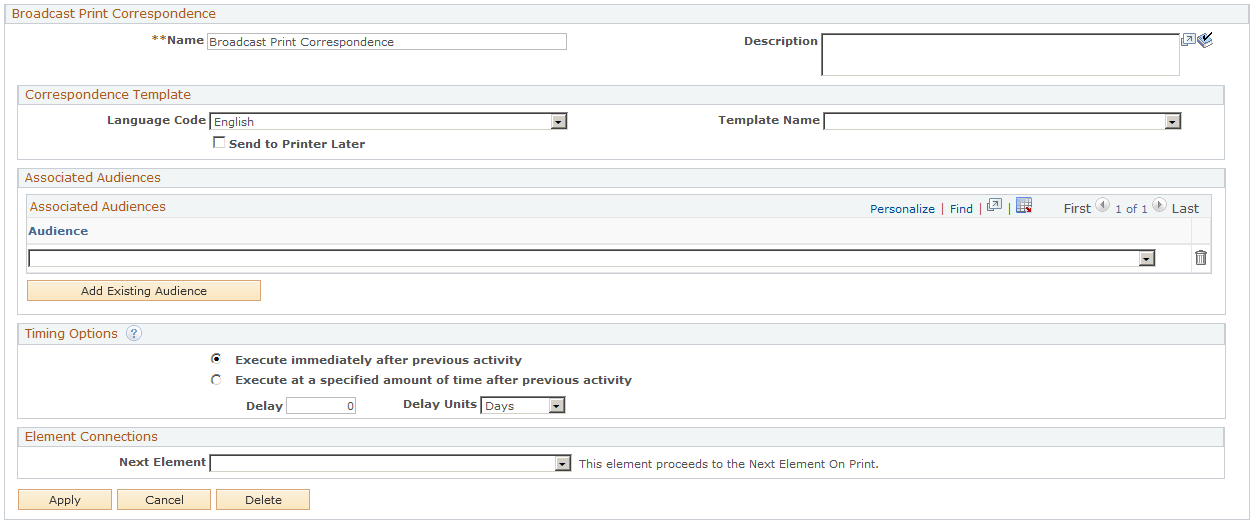

Broadcast Print Correspondence |
Single Print Correspondence |

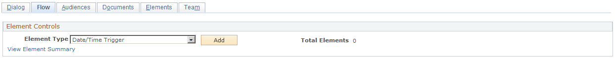

Use the Dialog Designer - Flow page (RYE_FLOW) to design the dialog flow of the dialog and define the various dialog elements.
Navigation:
Click the Flow tab on the Dialog Designer.
This example illustrates the fields and controls on the Non-Graphical Flow Designer.
Click the View Element Summary link to view the Element summary on the Elements tab.

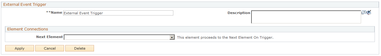

External Event Trigger
External Event triggers are used to allow an external system to trigger a dialog. The External Event Trigger represents:
A URL that can access a Landing or Standalone Page if connected directly to one of those page types.
A URL that can trigger the sending of email to an individual if connected to Single Email.
Multiple URLs if connected to a Web Link Promotion.
External Event triggers can only connect to other elements, and act as the beginning of a flow path.
This example illustrates the fields and controls on the External Event Trigger.
Field or Control |
Description |
Name |
You must specify a unique name for the trigger when you create it. |

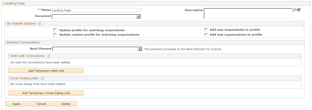

Landing Page
A Landing Page represents a beginning page in a series of web pages with which the user will interact.
You can only connect a Landing Page from a Document Web Link or an element that represents a URL connection.
Note: Documents that are associated to the Landing Page element must have a Submit button in order to be validated by the Dialog Check.
This example illustrates the fields and controls on the Landing Page.
Field or Control |
Description |
Name |
You must specify a unique name for the element when it is created. |

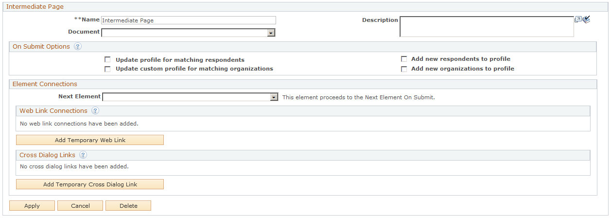

Intermediate Page
An Intermediate Page is used to connect multiple pages together. It is used in conjunction with the Landing Page, and can be followed by another Intermediate Page or a Final Page.
Note: Documents that are associated with the Intermediate Page element must have a Submit button in order to be validated by the Dialog Check.
This example illustrates the fields and controls on the Intermediate Page.

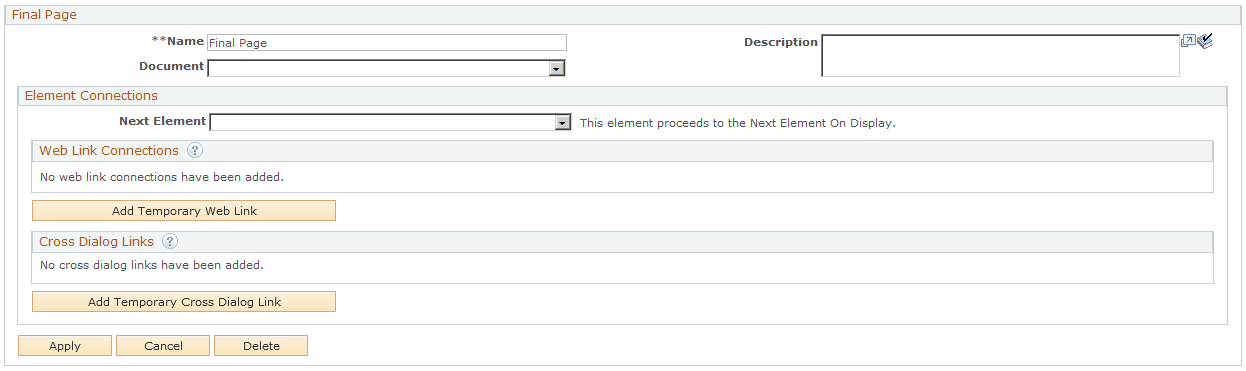

Final Page
A Final Page is used to end a path with either a lone Landing Page or a Landing Page followed by one or more Intermediate Pages. The Final Page has no On Submit button specified in its associated document, and only Web Links (from the document with which it is associated) can originate from it.
This example illustrates the fields and controls on the Final Page.
Standalone Page
A Standalone Page is a single, self-contained web page with no other pages connected to it. Standalone Pages can only be reached from web links, or elements that represent web links such as External Event Triggers or Web Link Promotions. They have no On Submit button specified in its associated document, and can only contain web links (from the documents with which they are associated).
This example illustrates the fields and controls on the Standalone Page.
Web Link Promotion
A Web Link Promotion (commonly called a “Web Link Promo”) allows users to enter the dialog from a banner ad or web link.
By specifying an audience or multiple audiences, you can use a Web Link promotion to track how users are accessing the Landing Page or Standalone Page that is connected to this element. In the Link Report, a URL is generated for every audience that is associated to a Web Link Promotion, and depending on which one a user accesses, metrics can keep track of the number of people who clicked. This functionality is useful for determining how much traffic is being generated by banner ads that are located on different websites, but that point to the same place in a dialog.
Web Link Promos can only point to a Landing Page or Standalone Page, and only an External Trigger can point to the Web Link Promo.
This example illustrates the fields and controls on the Web Link Promotion.
Field or Control |
Description |
Name |
Provide a unique name for the Web Link Promo. |
Audience |
Assign the Web Link respondents to a audience. Whenever respondents access a web page, Online Marketing tracks them by their audience to ensure accurate statistics in CRM Analytics and the Dialog Performance Report. You can specify one or more audiences. Online Marketing will generate a separate URL in the Link Report for each audience you specify. Note: In order to appear in the Audience list, audiences must be added on the Audience page. |
Add Existing Audience |
Click this button to add another row to the Audiences list so you can select another audience. |

A Broadcast Email is used to send out bulk emails based on an audience or multiple audiences.
Broadcast Email can only be reached from a Date/Time Trigger.
This example illustrates the fields and controls on the Broadcast Email page.
Field or Control |
Description |
Character Set |
Select the character set to use for the email from the available options. Note: If Character Set filtering is on for a dialog, this field will show only character sets that have been specified based on the language of the document that has been associated. |
Email Address to Use |
Specify the email address to which you want to send the email: Email or Email Alternative. |
Track Open Rate |
Select this check box to allow broadcast emails to be tracked for open rate (whether they were opened and how many times). Open rate tracking only works with HTML emails. |
Update invited for Event |
Select this check box to update the Invited value in the Event Management interface for a target after the broadcast email message is sent to that target. (In other words, you might select this check box if you are sending the target an invitation to an event, and want to update Event Management to specify that he or she was invited). Refer to the Event Management documentation for more information. |
Dedup Options |
By default, broadcast emails are deduped using the Unique System ID profile field, so each person receives only one copy of an email regardless of how many audiences he or she belongs to. You can also choose to dedup broadcast emails on the Customer ID (External ID) or Email address profile fields. |
Audience |
Select an existing audience to which to send the email. Note: In order to appear in the Audience list, audiences must be added on the Audience page. |
Click this button to specify another existing audience for the email's recipient list. |
Timing Options |
Schedule the execution of this action. You can have it execute immediately after the action that precedes it, or you can specify a delay of seconds, minutes, hours, days, weeks, or months from the previous action. Note: Once a Broadcast Email has been queued it is considered complete and the dialog flow will continue to the next element in the path. If there is a delay in the timing section, then a schedule event is created to queue the email at that later date and time. The flow will continue once the schedule event is created. |
Queue Management |
See Mailcasters. |

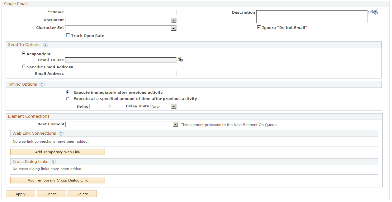

Single Email
Single Email represents sending a single email to an individual, not an audience.
This example illustrates the fields and controls on the Single Email.
Field or Control |
Description |
Character Set |
Specify the character set to use for the email. Note: If Character Set filtering is active for a dialog, this field will show only character sets that have been specified based on the language of the document that has been associated. |
Ignore “Do Not Email” |
Select this check box if you want to ignore the respondent's request not to be contacted by email (for example, you might select this option if you need to send the respondent important information about their account). |
Track Open Rate |
Select this check box to allow single emails to be tracked for open rate (whether they were opened and how many times). Open rate tracking only works with HTML emails. |
Send To Options |
These options allow you to specify the individual you want to reach with this email. You can enter a specific email address or addresses, or have the email sent to the respondent. The respondent’s email address can be obtained from profiles or from text entry elements of documents that were shown in this section of the process. Clicking the Merge button allows you to choose which profile field or document field from which to obtain the email address for the respondent. Only document fields from documents associated to the dialog will appear. Note: To specify multiple specific email addresses, the addresses must be separated by a semicolon and the string must contain no spaces (for example, address@address1;address@address2) You must be aware of the order of how documents will be accessed in your dialog. All document fields will be made available for choosing even if they come after the current element in the dialog flow. This functionality allows looping in the dialog. |
Timing Options |
Schedule the execution of this action. You can have it execute immediately after the action that precedes it, or you can specify a delay of seconds, minutes, hours, days, weeks, or months from the previous action. Note: Once a Single Email has been queued with the Email Server, it is considered complete and the dialog flow will continue to the next element in the path. If there is a delay in the timing section, the delay happens not on the queuing of the element, but on the scheduling of when a broadcast email job should be started after it has been queued. |
Queue Management |
These options are identical to those on the Broadcast Email page. See Broadcast Email. |

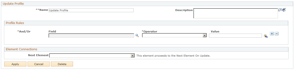

Update Profile
Update Profile allows for the update of an individual's profile information. It can use information that was either collected in documents or it can set profile fields to specific predetermined values.
This example illustrates the fields and controls on the Update Profile.
Field or Control |
Description |
Profile Rules |
Specify the profile fields to be updated. Field: Select the profile field you want to update. Operator: Select either is set to, or, for numeric attributes, you can also select Increment or Decrement. Value: Specify the field that contains the value to place in the profile. You can select a profile field or a field in the web document. . You can also enter a specific value in the Value column. (If you select the web document, it lists only the fields that are of the same type as the field selected in the Field field.) If the field is of a Date or Time type, you can use the Current Date and Current Time values to, for example, capture when a contact responded. The current date and current time are those on the database server. Note: Some operators (for example, Equal to Current Date, Equal to Current Time, Increment, and Decrement) do not allow values; in these cases the Value field is disabled. |
Decision Point
The Decision Point action allows Online Marketing to check for a specific condition and perform an action based on the result.
This example illustrates the fields and controls on the Decision Point.
Field or Control |
Description |
If |
Field: Select a field. You can choose from any field (except many rows per content fields) in the Online Marketing profiles, and entry and choice fields in this dialog’s documents. Operator: Online Marketing presents different Operators depending on the type of field selected. Value: Specify a value. When a choice question is selected in the Field column, the valid choices are listed. If the field has a Date or a Time format, you have the option to specify a particular date or time value (Current Date and Current Time are chosen in the Operator field). For example, if a contact responds after the set date/time value, you might have the dialog perform a different action. The date and time used are those on the computer running the database server. Some operators (for example, Is Empty, Is Not Empty, and Equal To/Prior To/After Current Date and Time) do not allow values; in these cases the Value field is disabled. Note: If needed, you can add multiple fields to the condition and connect them with And/Or/With functions. If you select a normal profile field, you can use either And or Or function to connect the fields. If you select a multi-row profile field, you can connect the fields using And, Or, and With functions. Please note that while using the With function, only the fields of the selected multi-row profile will be available for selection. |
Then |
Specify the connection to be made if the condition specified is true. |
Else |
Specify the connection to be made if the condition specified is false. |

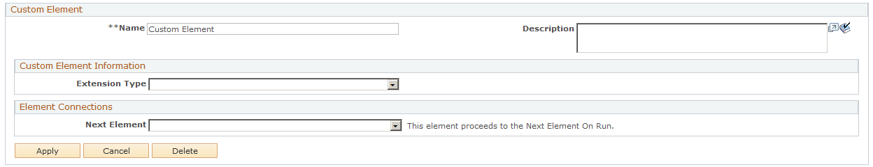

Custom Element
Custom Elements are actions that you set up to perform activities not delivered with Online Marketing.
The places where Custom Elements can be inserted in the flow are dependent on the specific Custom Element type.
This example illustrates the fields and controls on the Custom Element.
Field or Control |
Description |
Extension Type |
Select a custom extension from the available options of custom actions that are available for use. By default, Online Marketing ships with a “HelloWorld” custom action that is used for testing purposes. |
Custom Element Parameters |
Specify values for the custom element's parameters. Parameters vary by custom element, and will be preloaded after an extension is chosen. You can change the parameter value for this single instance of the extension. You can also add parameters that have not been specified when the extension was created; these parameters will be stored with this single instance of the extension and will not affect the original extension definition. You can merge in values from the dialog documents or profile fields by using the Merge button. Note: This field appears only when you have selected a custom extension from the Extension type. |
Add Parameter |
Click this button to add a new parameter to the Custom Element. Note: This button appears only when you have selected a custom extension from the Extension type. |

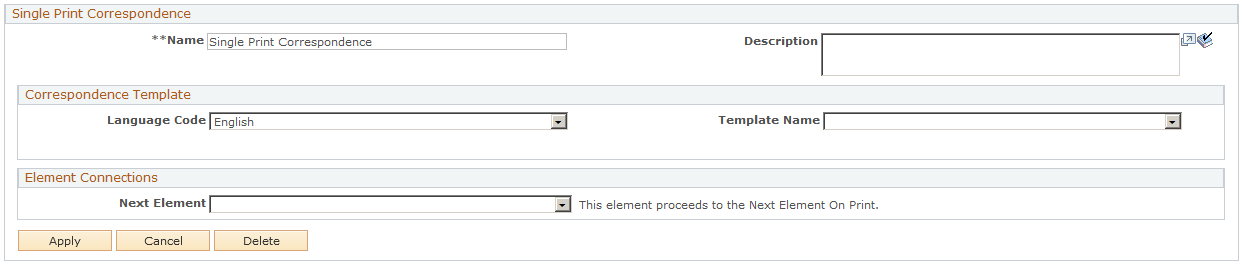

The Single Print Correspondence action generates a correspondence request, which results in a letter being generated and printed for the current individual. This action can be placed in the External Event Trigger flow.
This example illustrates the fields and controls on the Single Print Correspondence.
Field or Control |
Description |
Language Code |
Select a language from the available list. |
Template Name |
Select a template. Only those templates that have the selected Language Code and Usage defined as Online Marketing will be available for selection. |
The following considerations apply to Single Correspondence:
The individual must be defined in the system in order for correspondence to be generated for that individual.
If the individual's Do Not Contact or Do Not Mail values are set to Y, the request is ignored.
Correspondence can be generated only for individuals with the role of Worker, Consumer, or Contact for a Company.
The Dialog must be in either a Live or Staging state.
Because the Single Print Correspondence action runs asynchronously from other actions at the same level, you cannot assume that actions following the Single Correspondence action will be dependent upon the outcome of the Single Correspondence action's result.
The Broadcast Print Correspondence action generates a correspondence request, which results in a letter being generated and printed for the current individual. This action can be placed in the Date/Time Trigger flow.
This example illustrates the fields and controls on the Broadcast Print Correspondence.
Field or Control |
Description |
Language Code |
Template Package Name |
Select a template package. Only those packages that have the selected Language Code and Usage defined as Online Marketing will be available for selection. |
Print Later |
Select this check box to specify that the correspondence process should generate the letters, but not print them out. |
Associated Audiences |
Select an audience for which you want to generate correspondence. |
Click this button to add another audience to the list. |
Timing Options |
Schedule the execution of this action. You can have it execute immediately after the action that precedes it, or you can specify a delay of seconds, minutes, hours, days, weeks, or months from the previous action. Note: Once a Broadcast Correspondence action has been queued it is considered complete and the dialog flow will continue to the next element in the path. If there is a delay in the timing section, then a schedule event is created to queue the correspondence request at that later date and time. The flow will continue once the schedule event is created. |

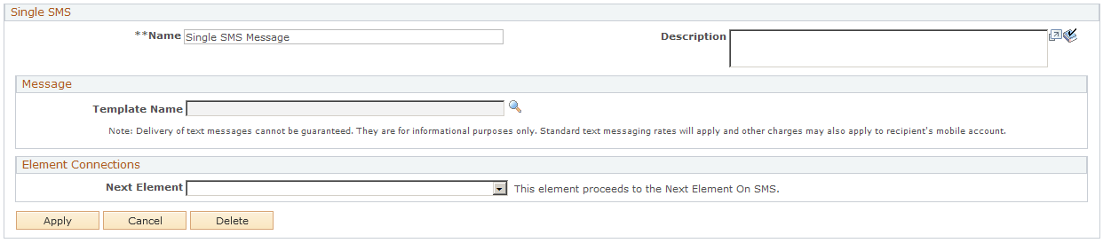

Single SMS Message
The Single SMS Message action generates a text message, which is then sent to the selected individual. This action can be placed in the External Event Trigger flow.
This example illustrates the fields and controls on the Single SMS Message.
Field or Control |
Description |
Template Name |
Select an SMS message template from the available list. You must choose a predefined template—you cannot use this action to send a message that has not already been defined. |
The following considerations apply to Single SMS Message:
Because the Single SMS Message action runs asynchronously from other actions at the same level, you cannot assume that other actions following the Single Text Message action will be dependent upon the outcome of its result.
If no SMS template has been specified for the action, the system rejects it.
See Single SMS Message.

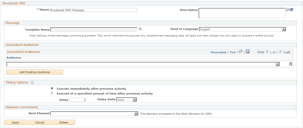

Broadcast SMS Message
The Broadcast SMS Message action generates a correspondence request, which results in a text message being generated and sent to the individuals in the selected audience. This action can be placed in the Date/Time Trigger flow.
This example illustrates the fields and controls on the Broadcast SMS Message.
Field or Control |
Description |
Template Name |
Send in Language |
Specify a language code for the broadcast SMS action. The system will attempt to send the template in the language specified to the mobile handset. If no version of the template exists in the language specified, the system uses the base language version. If you do not specify a language, the system uses the language from the current user. Only system installed languages are listed in the available list. |
Select an audience for which you want to generate an SMS message. |
Timing Options |
Schedule the execution of this action. You can have it execute immediately after the action that precedes it, or you can specify a delay of seconds, minutes, hours, days, weeks, or months from the previous action. In order to ensure that all Broadcast Text Messages are sent correctly, you should include at least a 2 minute delay between messages in the Date/Time Trigger flow to allow the SMS service enough time to complete and schedule each request. Note: Once a Broadcast Text Message action has been queued it is considered complete and the dialog flow will continue to the next element in the path. If there is a delay in the timing section, then a schedule event is created to queue the request at that later date and time. The flow will continue once the schedule event is created. |
The following considerations apply to Broadcast Text Message:

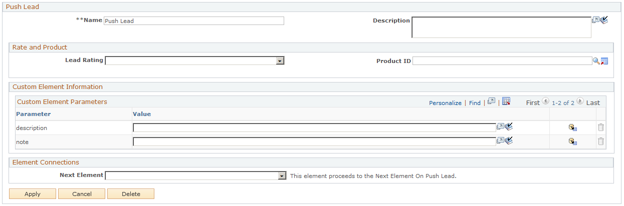

Push Lead
The Push Lead action creates a Sales lead using the parameters specified. This action can be placed in the External Event Trigger flow.
This example illustrates the fields and controls on the Push Lead.
Field or Control |
Description |
Lead Rating |
Select a lead rating (Hot, Warm, or Cold) from the available list. The lead rating values are defined within the Sales application at Set Up CRM, Product Related, Sales, Leads and Opportunities. |
Product ID |
(Optional) Choose a Product ID to be added to the lead. The Product SetID is determined by the dialog's business unit. If a product ID is specified, the product will be included on the lead when it is created. |
You can optionally enter free-form text for these parameter values.
The following considerations apply to Push Lead:
Leads can only be created for Consumers and Contacts for Companies. Attempting to create leads for other role types will generate an error message.
The Sales business unit must be defined for Online Marketing in order to use the Push Lead action at Set Up CRM, Business Unit Related, Online Marketing Definition.
The Push Lead action does not feed dialog questions and answers to lead table, except to add them in the Push Lead action note field by using merge code: these will be added in the lead's Note section.
The Push Lead action is not designed to operate under heavy load. You should carefully design your dialogs and only create reasonably well qualified leads. If mass lead creation occurs, the large number of lead-creation requests in Integration Broker can hold up other integration processes and affect performance.
The Push Lead action only inserts new leads; it does not update existing leads. Further, it does not check for duplicate leads.
The dialog must be in the Live state.
Leads are automatically assigned to a sales representative only if the ONLINEMARKETING lead source has been configured properly in the Sales Manage Territory page. Otherwise, the sales manager must use the Sales component to manually assign the lead to a representative.
Because the Push Lead action runs asynchronously from other actions at the same level, you cannot assume that other actions following the Push Lead action will be dependent upon the outcome of its result.
Audiences are the contacts you want to reach in your dialog. Each dialog that contains Broadcast Email and/or Web Link Promotion actions must have at least one audience defined.
Use the Dialog Designer - Audiences page (RYE_AUDIENCE) to use to select existing audiences for the dialog or to define new audiences.
Navigation:
Click the Audiences tab on the Dialog Designer.
This example illustrates the fields and controls on the Dialog Designer - Audiences page.
Field or Control |
Description |
Audience Name |
The name of the audience, which will be visible from the dialog. |
Go to Audience Builder icon |
Click to navigate to the Audience Builder for the selected audience. |
Audience ID |
The unique identifier for the audience. |
Internal/External |
Internal audiences consist of recipients in the Online Marketing database who are contacted directly via broadcast email messages from Online Marketing. External audiences consist of recipients not in the database who are contacted through a source outside the Online Marketing software (such as a banner ad). |
Count |
The current count of how many members are in the audience. |
Audience Status |
The current status of the audience. Possible values are: In Design, Designed, Scheduled, Processing, Generated, Approved, Committed, and Archived. |
Times Referenced |
The number of times the audience is referenced in the current dialog. Only audiences that are not referenced by any elements can be unattached from the dialog. |
Click this button to select another existing audience to add to the dialog. |
Create New Audience |
Select an audience creation method from the available options. Note: If you have purchased PeopleSoft Marketing, more options will be available to you. Additionally, only components where the current user's role allows them to access will be listed. |
Create |
Click this button to create a new audience using the creation method you chose. |
See PeopleSoft Marketing.

Use the Dialog Designer - Documents page (RYE_DOCUMENTS) to use to associate existing documents with the dialog or to define new documents.
Navigation:
Click the Documents tab on the Dialog Designer.
This example illustrates the fields and controls on the Dialog Designer - Documents page.
Field or Control |
Description |
Document List |
Displays the documents that are currently part of this dialog. |
Document Name |
Name of the document that has been associated to this dialog. |
Go To Document Designer |
Click to display the Document Designer for the selected document. |
Document Type |
Documents that can be associated to a dialog are either web documents or email documents. The type dictates whether the document will appear in the various elements' document lists. |
Language |
The language of the document. The language can play a role in which character sets are valid to be chosen for a dialog element. |
Times Referenced |
The number of times the document is referenced in the current dialog. Only documents that are not referenced in any elements can be unattached from the dialog. Note: Documents that have gone Live or that have been imported or exported can no longer be removed from the dialog. |
Add Existing Document |
Click to choose an existing email or web document to add to your dialog. |
Create New Document |
Select Email Document or Web Document and click to display the Document Designer. |
You can view a list of all the elements currently in the flow of your dialog.
Use the Dialog Designer - Elements page (RYE_ELEMENTS) to use to manage the objects in the Dialog Designer interface.
Navigation:
Click the Elements tab on the Dialog Designer.
This example illustrates the fields and controls on the Dialog Designer - Elements page.
Field or Control |
Description |
Type |
An icon indicating the element type. |
Dialog Element |
The name of the element. |
Complete? |
If the element is complete (does not require anything further to function correctly), a green check mark displays. If incomplete (for example, if it needs more information), a red square displays. You can determine what is not complete about an element by running the dialog check. |
Connections |
Describes the manner in which the element is connected to other elements in the flow. Primary connections and web links (real and temporary) appear in this field. |
Delete icon |
Click the trash can icon on an element's row to delete it. |

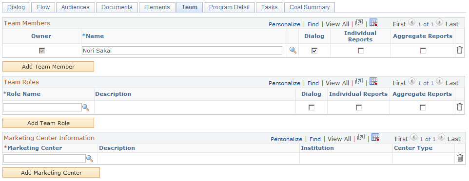

Use the Dialog Designer - Team page (RY_DIALOG_TEAM) to use to manage team members and roles who have access to the dialog.
Navigation:
Click the Team tab on the Dialog Designer.
This example illustrates the fields and controls on the Dialog Designer - Team page.
Field or Control |
Description |
Team Members |
Displays the team members who have access to the dialog. If the Owner check box is selected, the specified team member is the owner of the dialog. |
Add Team Member |
Click this button to add more team members to the dialog. |
Team Roles |
Displays the team roles that have access to the dialog. If a role has access to the dialog, then all the users who are members of that role have access. |
Add Team Role |
Click this button to add a role to the dialog. |
Marketing Center Information |
Displays the Marketing Centers that are authorized to access the dialog. |
Add Marketing Center |
Click this button to add a Marketing Center that will be authorized to access the dialog. |
