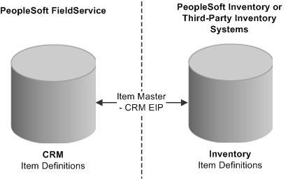

When the messages of the Item Primary EIP are activated, you cannot use the Item Definition component in PeopleSoft CRM to change or add item records. Most updates are made to the item records in the inventory and purchasing system and publish them to PeopleSoft CRM, excluding the Configuration Option section and the Short Description field, as shown in this diagram:
This diagram illustrates the data flow of item records from the inventory system to the CRM system using the Item Primary EIP.
