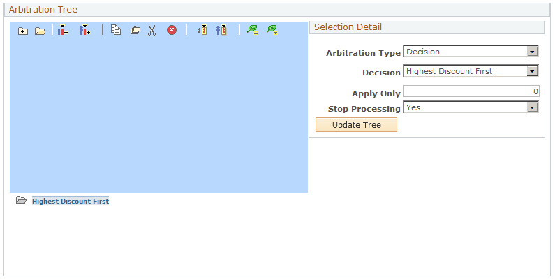

Arbitration Plan 1: Apply Discounts Only
This is an example of a basic arbitration plan, which uses essentially one node to determine how all price rules with conditions that match the transaction are sorted. In this example, the arbitration plan uses the Highest Discount First decision to rank all matching price rules for a transaction. The value in the Apply Only field suggests that only the first price rule with the highest discount value would be applied, and there will be no more pricing adjustments afterwards.
This arbitration plan is applicable to situations where you are certain that price rules are defined for only discounts (no price overrides or giveaways).
Example of Arbitration Plan page using the Highest Discount First decision

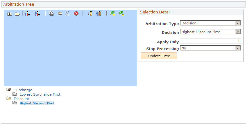

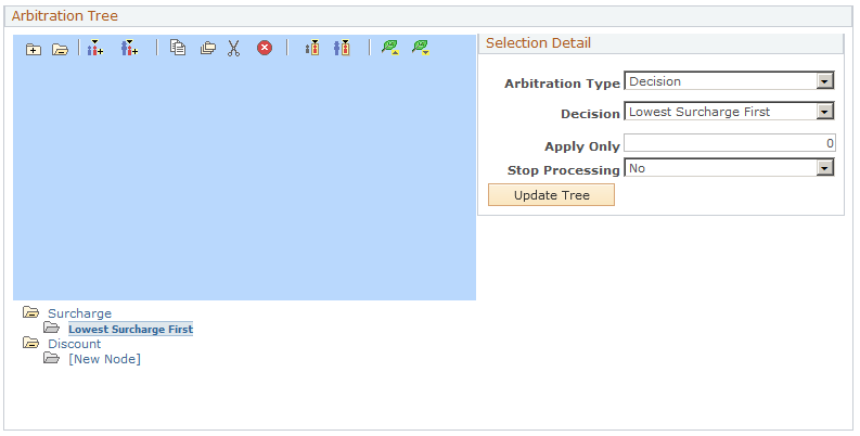

Arbitration Plan 2: Apply Surcharge Rules Before Discount Rules
This sample arbitration plan applies to situations that involve price rules of these two action types, surcharge and discount.
In this example, the system selects all price rules with conditions that match the transaction and sorts them first by surcharges and then by discounts. If there are multiple surcharges, the first two rules with the lowest surcharge values are applied. After all the surcharges are applied, the first two discount rule with the are highest discount values are applied. Pricing adjustments stop after all discounts are applied.
Example of Arbitration Plan page using surcharge and discount decisions (1 of 2)
Example of Arbitration Plan page using surcharge and discount decisions (2 of 2)
You can use the arbitration plan as a filter to apply certain price rules to a transaction and not others. Although some price rules might match the transaction according to the conditions of the price rule, you can define the arbitration plan to bypass some price rules. This example is also a filter because it applies only surcharges and discounts to the transaction. If giveaway or price override price rules that match the transaction are defined, they are not applied when using this arbitration plan.

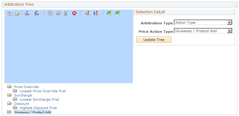

Arbitration Plan 3: Apply Price Override, Surcharge, Discount and Giveaway Rules
This example continues the previous example and shows an arbitration plan applying various (price override, surcharge, discount and giveaway price rules):
Example of Arbitration Plan page using price rules with various actions
In this example, the system selects all price rules with conditions that match the transaction and sorts them first by price overrides, followed by surcharges, discounts and lastly giveaways/product adds. If there are multiple price overrides, the first n number of price rules (specified in the Apply Only field) with the lowest price override values are applied. After all the price overrides are applied, matching surcharge price rules are applied, followed by eligible discount and giveaway rules.

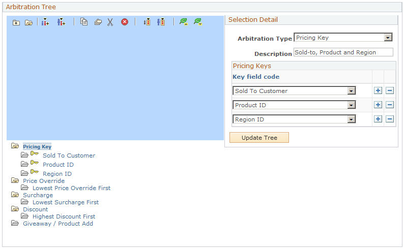

Arbitration Plan 4: Apply Filters in Rules
Any arbitration plan that does not have a decision point at the top level of the tree is a filter. Wherever you place the decision node in the tree is where you tell the pricing engine you don't care to further differentiate the price rules, just apply whatever rules match the transaction at that point in the order of the decision.
For example, you want to define an arbitration plan that selects only discount price rules that match certain fields on a transaction. In this case, you define the order in which those matching price rules are applied to the transaction. In this example, let's say you want to match price rules defined only by sold-to customer, product, and region ID. Once the system finds the matching price rules:
First apply those rules that match all three criteria.
Then apply the rules that match only the product.
Lastly apply any discounts that are defined for our favorite customers.
Example of Arbitration Plan page using a filter
This arbitration plan considers only discount price rules that are defined by sold-to customer, product, and region; product; or sold-to customer only. It applies the formulas for those price rules in that order. If there is a tie within a node, that is, there are two price rules defined for the product ID, the system sorts those two rules and applies the highest discount first.
