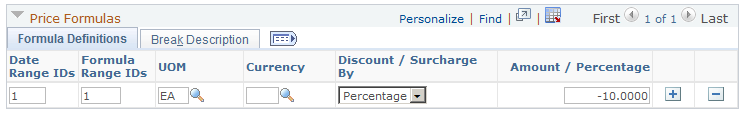

Price Rules with Compound Date and Formula Breaks
When you define a price rule, you need to specify a date range and a formula range that transactions must match (in addition to the conditions specified on the Conditions page) for the price formula to apply. The Price Rule component supports the reference of multiple date ranges and formula ranges (by product price or quantity) in a price formula. For example, you can define a price formula that includes these date and formula ranges:
Date range #1: 12/31/2010 > order date > 01/01/2000
Formula range #1: 99999 > Price > 1
Formula range #2: 5000 > Quantity > 1
And the price formula will be applicable to transactions that match all of the associated date and formula ranges.
See Formulas Page.

Price action types support a range of methods used for calculating pricing adjustments. Based on the selected action type and adjustment method, the system updates the display and label of numeric and textual fields so that adjustment information can be entered appropriately. This screenshot shows how the Price Formulas section looks like for the Discount/Surcharge price rule action type:
Price Formulas section of the Formulas page
This table lists the adjustment methods that each price rule action type supports, the fields that appear based on selected adjustment method, and the labels of the fields that are updated based on the selected rule action type and adjustment method:
Note: For discount or surcharge action types, use a negative number to indicate discount amounts or percentages, for example, -10 for a discount of 10 percent or dollar amount. A positive number represents surcharges by percentage or amount.
