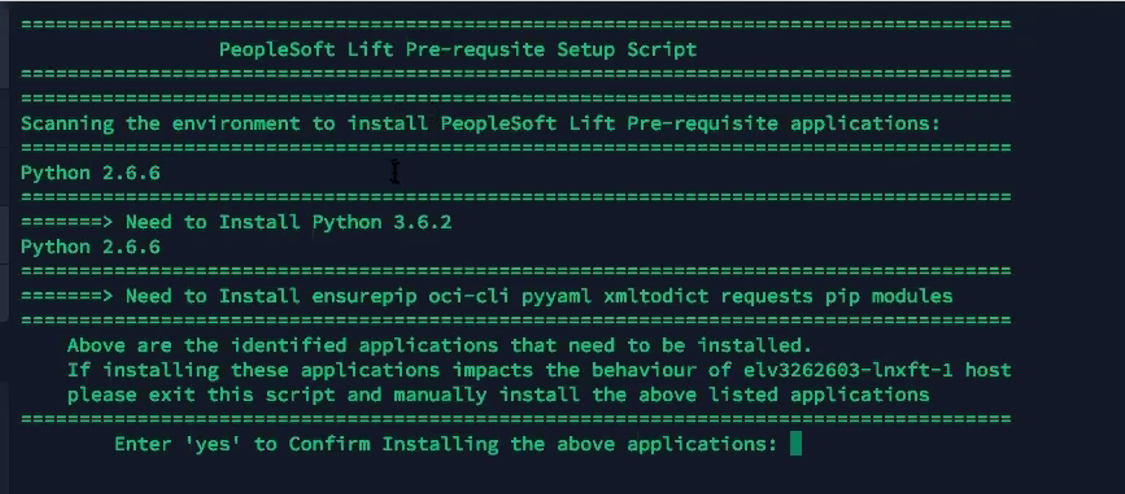

When you run the utility, it will ask if this is a database environment or an application environment.
Is <environment> a Database Environment: (yes/no):
  • Application environment (answer no at above prompt)
    The system will scan the environment and indicate the applications that need to be installed.
    This example illustrates applications that are required for an application lift.
    Example PeopleSoft Lift Prerequisite Setup Script for Application Environment

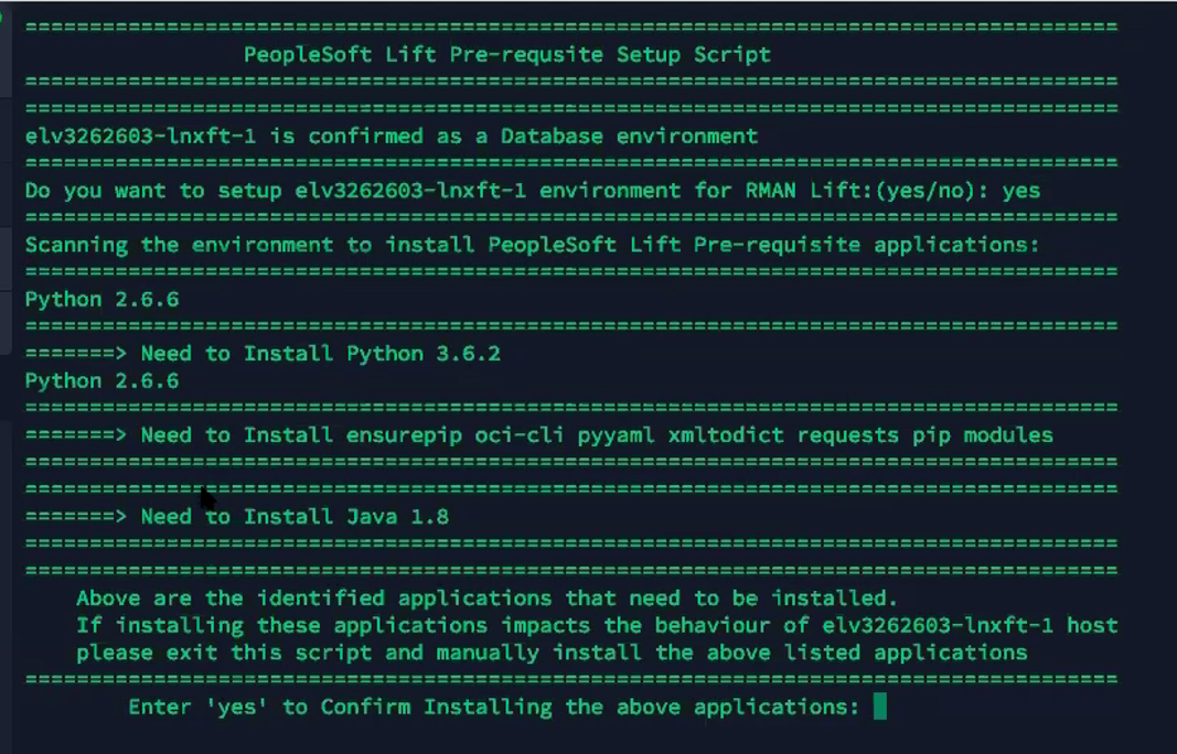

  • Database environment (answer yes at above prompt)
    This example illustrates applications that are required for a database lift.
    Example PeopleSoft Lift Prerequisite Setup Script for Database Environment

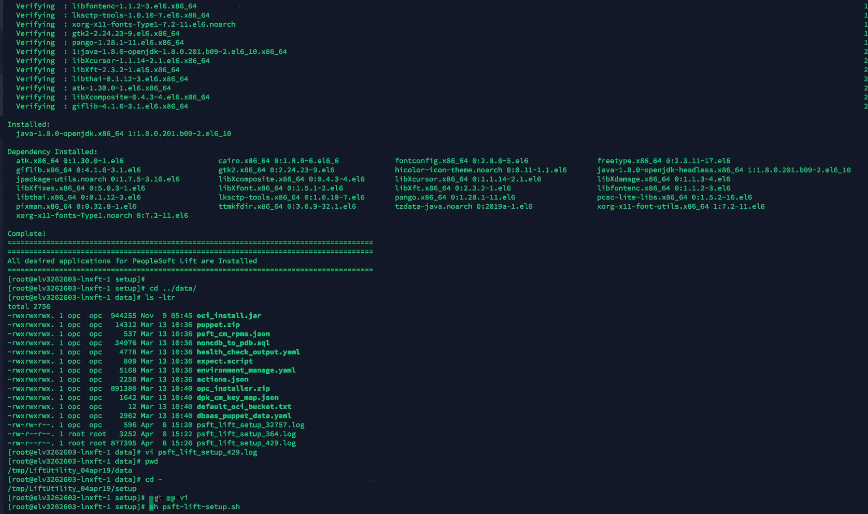

When all the applications are successfully installed, you will get a message “Complete!”.
This example illustrates all desired applications for PeopleSoft Lift are installed.
Example Lift Prerequisites Complete
You can list the files and view the logs that were created for the install. The logs located at <Lift_Utility>/data/psft_lift_setup_<PID>.log
