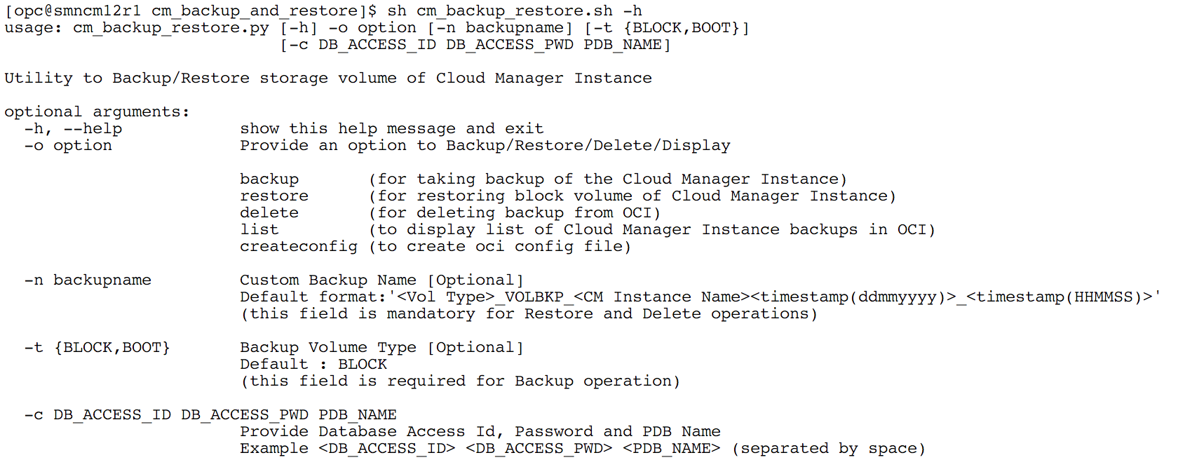

For a summary of the usage and optional arguments for shell script cm_backup_restore.sh, use the -h option.
This is an example of the help.
This example illustrates running cm_backup_restore.sh -h.
Example: cm_backup_restore.sh -h

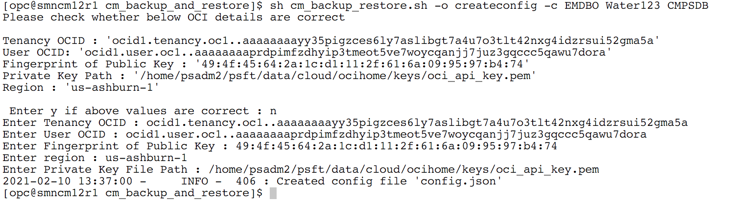

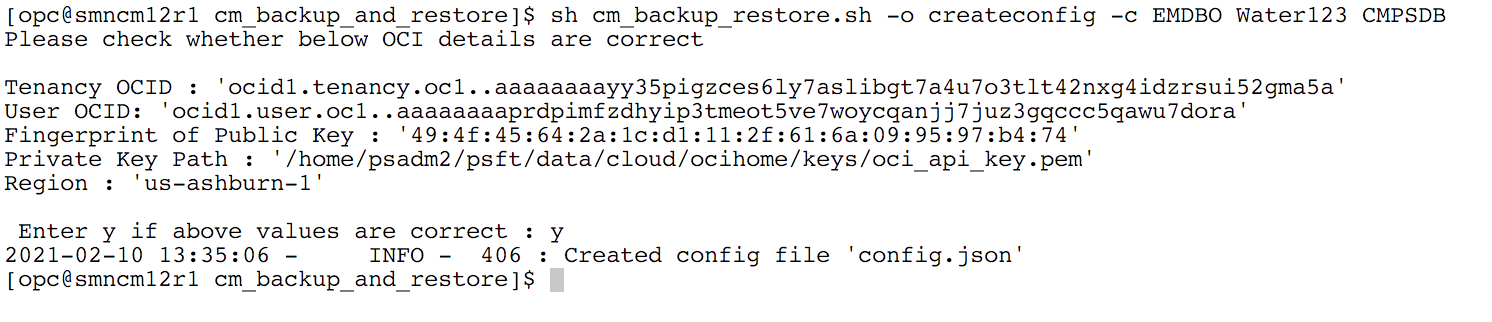

To create the Config file:
  1. Run the utility with the createconfig option and provide the Cloud Manager database Access ID and password.
    sh cm_backup_restore.sh -o createconfig -c <DB_ACCESS_ID> <DB_ACCESS_PWD> <PDB_NAME>
  2. This option will read OCI User ID, Tenancy ID, Fingerprint and Private Key File Path from database and display on screen.
  3. Check the displayed values.
    • If the values are correct, press y to confirm and the configuration file will be created.
    • If you want to change the values, press n and provide Tenancy ID, User ID, Fingerprint, Private Key File Path, Region details to create config file.
This example illustrates accepting default values.
Example accepting default values
This example illustrates modifying default values.
Example modifying default values
Note: If config.json is already present, this utility will replace the existing one.
