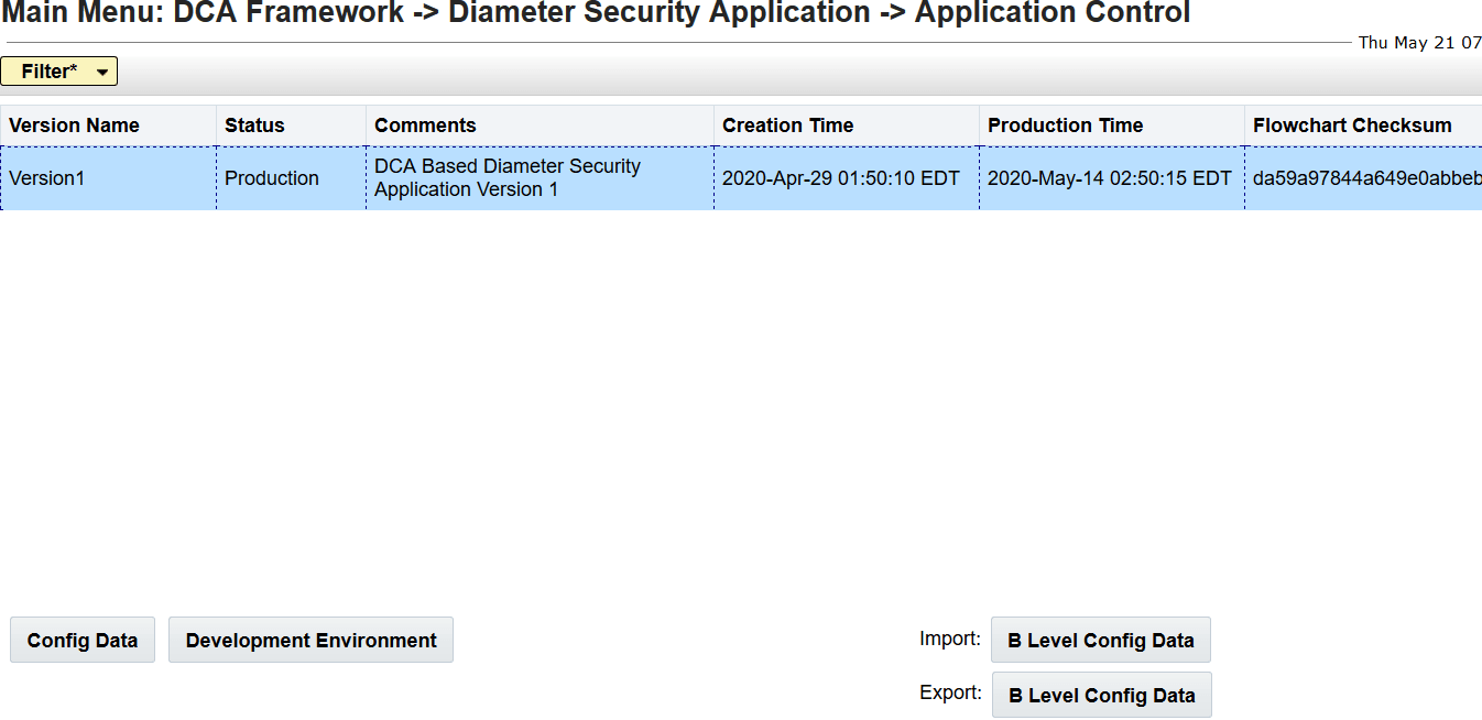

    1. Log in to the SOAM GUI.
    2. From the Main Menu, navigate to DCA Framework, and Diameter Security Application, and then Application Control. Ensure that an entry is added in DCA application version details table.
    3. Select the required DSA Version Name.
    4. Click B Level Config Data in the Export section of the Application Control page.
      Figure 5-1 DSA SOAM Level Configuration Export
      configuration data

  3. Following are the steps to import the SOAM level json:
    1. Log in to the active SOAM GUI.
    2. From the SOAM GUI Main Menu, navigate to DCA Framework, and Diameter Security Application, and then Application Control.
    3. Click B Level Config Data, select the "file", and then click Import to import the SOAM configuration data (this file can be previously exported SOAM configuration json or it can be the upgraded release's Diameter_Security_Application-Version1_Default_Config.json).
