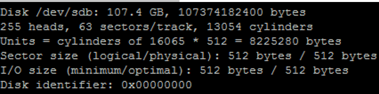

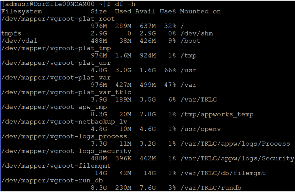

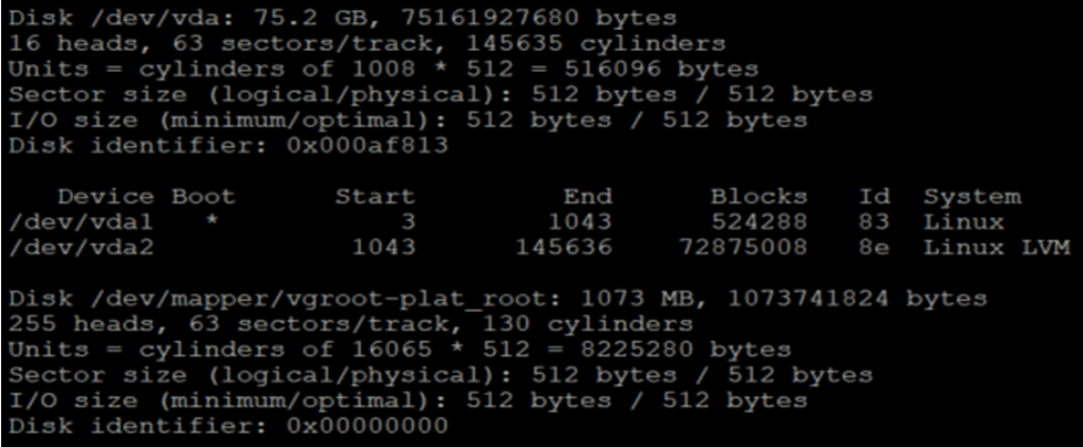

- Verify the extra or second disk exists.
This step is required only for the Oracle VM.Check if the raw storage block device (external disk) exists by executing any of below commands (similar to the screenshot):$ ls /dev/[sv]dbNote:
The command [sv] db means, sdb and vdb, depending on the hardware.Example using,$ ls /dev/sdb
$ sudo fdisk –l
$ df –h
If the extra disk does not exist, revisit the procedures for respective hypervisors. (Create iDIH Virtual Machines - VMware, Create iDIH Virtual Machines - KVM/OpenStack, and Create iDIH Virtual Machines - OVM-S/OVM-M).If you see it has been mounted, unmount it and completely remove the entry in theNote:
Do not mount or format the added raw block device. Oracle ASM (Automatic Storage Management) automatically manages it. To verify it, run the following command:$ df/etc/fstab.For example:- If any external drive (such as,
/dev/vdb) is mounted, then unmount the external drive by executing the following command on oracle server:umount /dev/vdb - Edit the
/etc/fstabfile on oracle server and if any entry for/dev/vdbis present in the file, then remove the entry and save the file.

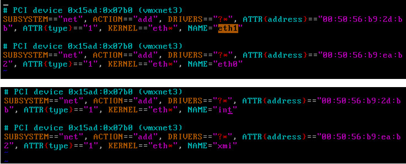

If this command does not create the net rules file, create it manually. Refer to Sample Net Rules File. - Modify the ethernet interface names in the net rules file.
- Update the net rules file to replace the default interfaces names ethX
with XMI and INT interfaces names. Replace eth0 with xmi
and eth1 with int interface. Also, respective MAC
addresses should be updated for each interface in lower case. MAC
addresses can be determined using
ifconfig -acommand from the console.Note:
The Mediation VM requires the user to rename a third interface: eth2 as imi interface. - Refer to Sample Net Rules File for a sample net rules
file.
$ sudo vi /etc/udev/rules.d/70-persistent-net.rules
- Reboot the VM.
$ sudo init 6
