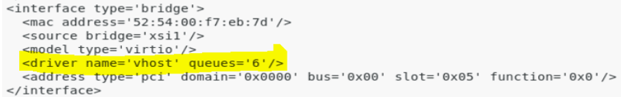

  5. Modify the XML and add the following line to the interface.
    <driver name='vhost' queues='6'/>
    Here, 6 represents the number of queues and can be maximum upto 8.
    The updated tag appears as below:
    <interface type='bridge'>
        <mac address='52:54:00:bf:2f:a0'/>
        <source bridge='xsi1'/>
        <model type='virtio'/>
        <address type='pci' domain='0x0000' bus='0x00' slot='0x05' function='0x0'/>
    </interface>
