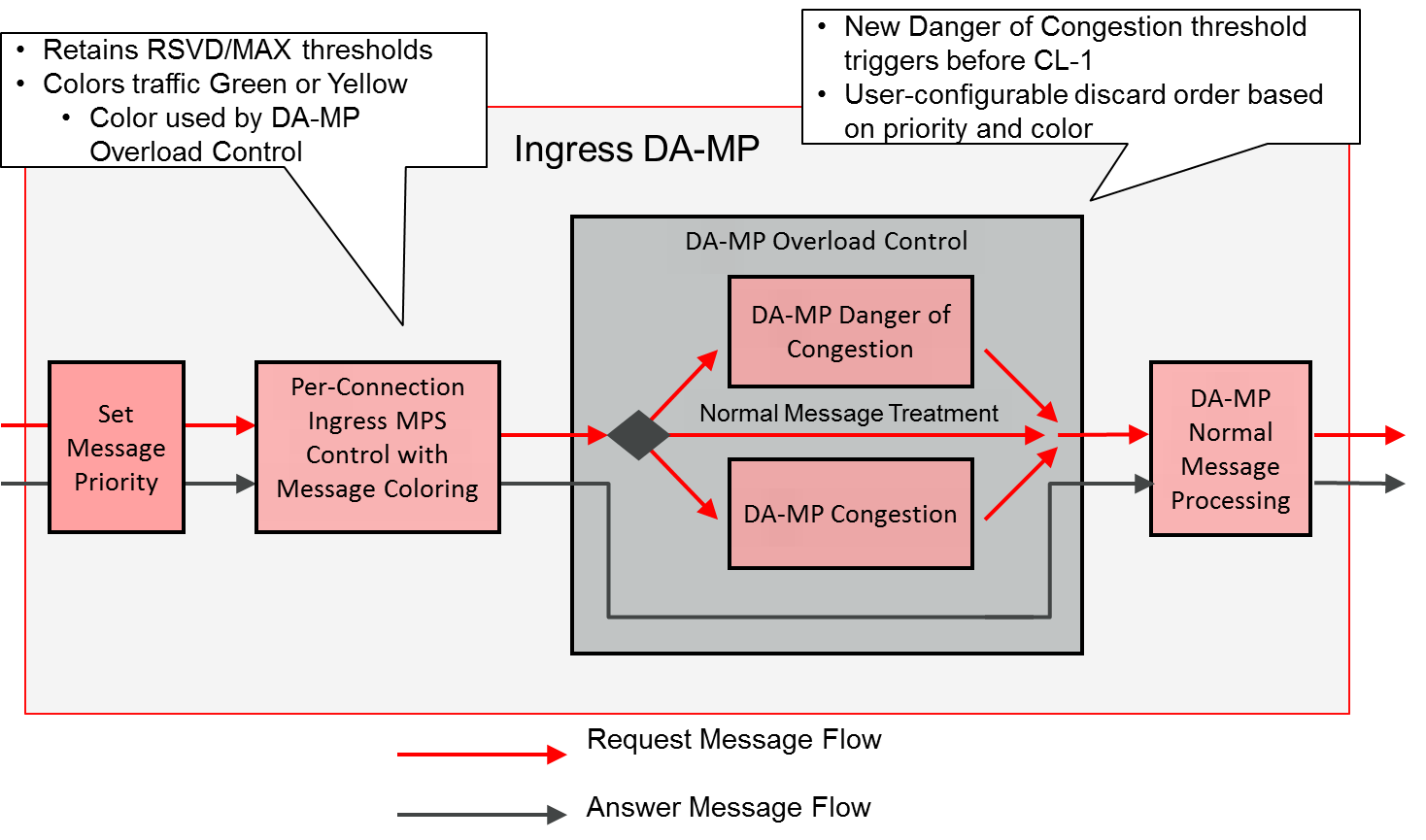

This feature addresses the functionality to assist DSR overload and throttling algorithms in differentiating messages ingressing a DSR connection whose ingress message rate is above (vs equal to or below) its configured reserved ingress MPS.
When a DSR connection’s ingress message rate is equal to or below its configured reserved ingress MPS, all messages ingressing the connection are colored green. When a DSR connection’s ingress message rate is above its configured reserved ingress MPS, messages below the reserved capacity are colored green and messages above the reserved capacity are colored yellow. Message color is used as a means for differentiating diameter connections that are under-utilized versus those that are over-utilized with respect to ingress traffic. Traffic from under-utilized connections are marked “green” by the per-connection ingress MPS control (PCIMC) feature. As stated above, when a DSR connection’s ingress message rate is above its configured reserved ingress MPS, messages below the reserved capacity are colored green and messages above the reserved capacity are colored yellow. In the event of danger of congestion or of CPU congestion and based on the specified discard policy, traffic from over-utilized connections is considered for discard before traffic from under-utilized connections. Traffic discarded by PCIMC due to capacity exhaustion (per-connection or shared) is marked “red” and is not considered for any subsequent processing.
Figure 2-19 Message Coloring and Priority or Color based DA-MP Overload Control
