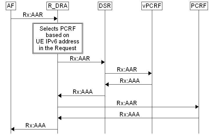

  2. Use Case B: Rx-AAR -> RBAR lookup -> PCRF
    • If Sh lookup required is No forward the message as is to DRL for further routing using RBAR lookup.
    • RBAR Application look up in RBAR table only for Rx AAR Initial (Rx-Request-Type AVP set to INITIAL_REQUEST),select the PCRF based on Framed IPv6 prefix and sends to DRL for further routing (either directly or through Core DRA).
    • PCRF installs desired policy and sends back Rx:AAA (with PCRF as Origin Host) to R-DRA (directly or through Core DRA).
    • PCRF sends back the Rx:AAA with PCRF Address as Origin Host.
Figure 2-2 Use Case B
Use Case B
  • Rx ShUDR Application processes the Rx:AAA message as answer message and create/modify the RX:AAA message with lookup in RCT Table and verifies if Topology hiding is required.
  • If Topology hiding is required for Rx Client FQDN(), then search THT table (using PCRF FQDN present in origin Host), replace the original origin Host with pseudo FQDN from THT Table and sends it to DRL for further routing to Rx Client.
  • Rx client uses Pseudo FQDN as Dest-Host for future diameter transactions, Rx-ShUDR Application receives message other than Rx AAR Initial (Rx-Request-Type AVP set to INITIAL_REQUEST) will lookup RCT table for Topology hiding. If Topology hiding is enabled for origin host, then look up THT table for pseudo FQDN to PCRF address mapping. If match is found, then replace Dest Host as PCRF address and sends out for further routing. If match is not found then forward message as is for further default routing.
