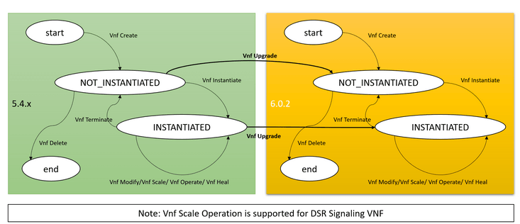

7.3.1 VNF State Diagram
Following are the few high level scenarios based on state diagram:
  • The VNF created on 5.4.x can be upgraded to 6.0.2 and all LCMs such as VnfInstantiate, VnfModify, VnfOperate, VnfHeal, VnfScale, VnfTerminate and VnfDelete can be performed
  • The VNF created and Instantiated on 5.4.x can be upgraded to 6.0.2 and all LCMs such as VnfModify, VnfOperate, VnfHeal, VnfScale, VnfTerminate and VnfDelete can be performed.
  • The VNF created and Instantiated and scaled on 5.4.x can be upgraded to 6.0.2 and all LCMs such as VnfModify, VnfOperate, VnfHeal, VnfScale, VnfTerminate and VnfDelete can be performed.
Figure 7-1 VNF State Diagram
VNF State Diagram
