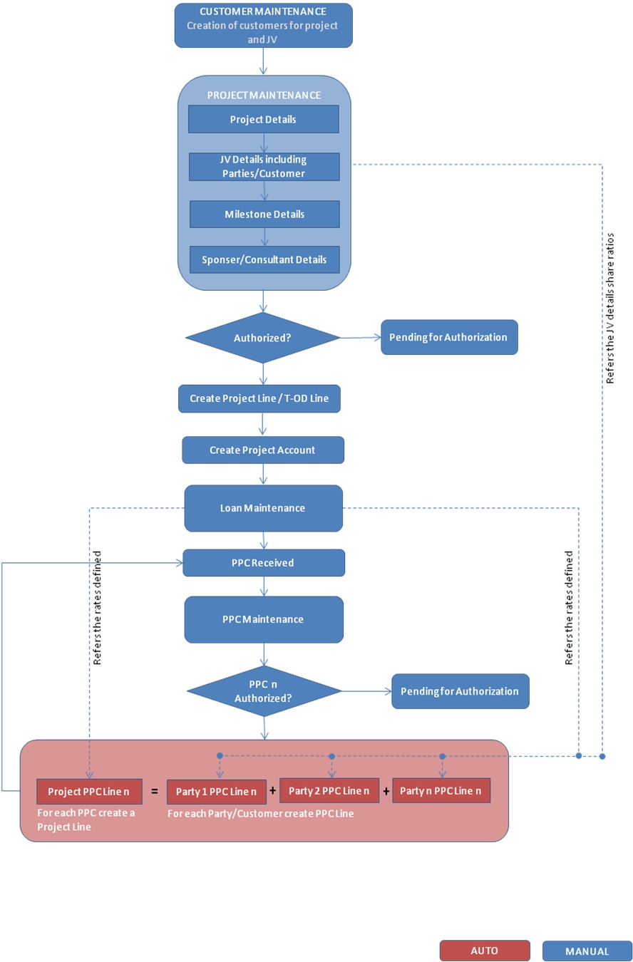

The process of project financing is as follows:
1. A customer or a joint venture approaches the bank for project financing
2. The bank creates the customer in the system
3. If it is a joint venture, the bank creates the joint venture customer and enters the party/ customer details linked to the joint venture in the joint venture button screen.
4. The bank then creates the project account for the created customer/joint venture customer.
5. The bank captures the following details in the ‘Project Maintenance’ screen:
l Project header details
l Sponsor/Pay-master details
l Project milestone details
l Joint Venture Parties Details (In case of Joint Venture Limit Tracking)
l PPC Limits Details
l Non-PPC Limits Details
6. Link the Non-PPC lines defined in project to the project account using Limits tab
7. The customer will utilize this clean limit line until he furnishes a PPC against part or full completion of a milestone.
8. On receiving the PPC, the bank does the following:
l Captures the PPC details
l If it is a joint venture then the system will default the joint venture details to this screen based on the details captured in the project maintenance venture details screen.
l If ‘Auto Line Creation for PPC’ field is unchecked,
You should manually create the line whenever a PPC is received.
The line currency can be other than project currency also, but the PPC CCY should be either project currency or line currency.
You should manually enter the limit line details in the project maintenance screen limits tab, if the project lines are created manually and in the PPC maintenance screen Joint Venture tab if PPC lines are created manually. If joint venture party limits tracking is not required, then the system will attach one line for the project customer with 100% tracking.
The system will also update the project ID and the PPC ID in the ‘Facility Maintenance’ screen, once the linkage between a line and a PPC/ Project is established manually during PPC maintenance
l If ‘Auto Line Creation for PPC’ field is checked,
On authorizing the PPC, the system will create the limit lines for each of the PPC for liability ID of the project customer
You should allocate the limit to the project line equal to the lendable value of the respective PPC
You should allocate the limit to an individual customer limit lines based on the share each has in the joint venture if ‘JV Limit Tracking Required’ is checked
l On authorizing the PPC, the system will automatically create line commitment contracts during the EOD. The rates used in the commitment are taken from project maintenance.
l For each PPC authorized and if ‘Limits tracking through Commitment’ is checked, then the system will create the following line commitment contracts:
Project line commitment contract, regardless of whether there is a joint venture or not
Customer line commitment contract for each customer only in case of joint venture

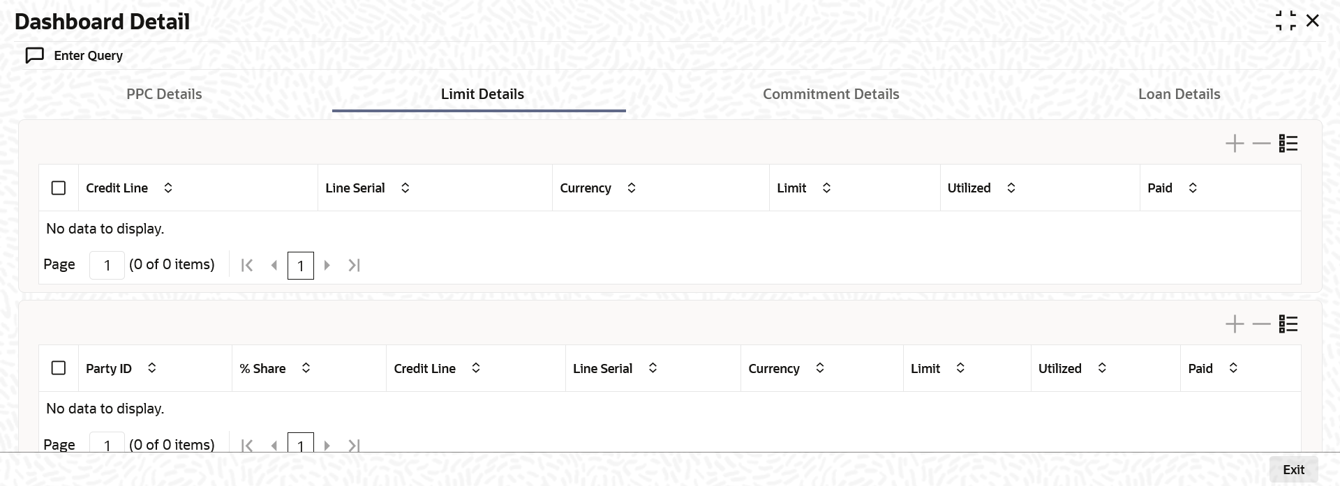

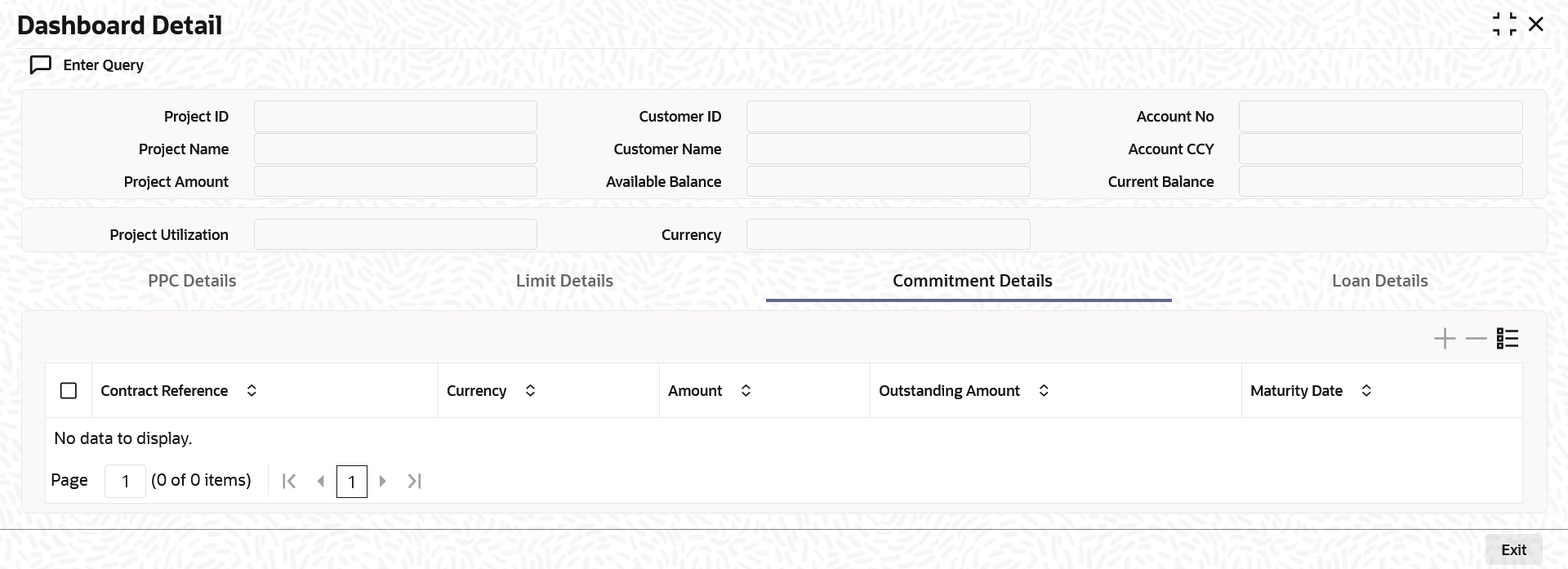

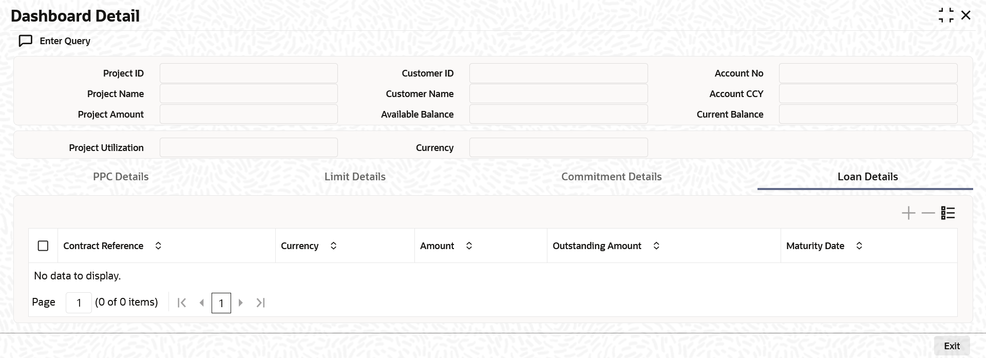

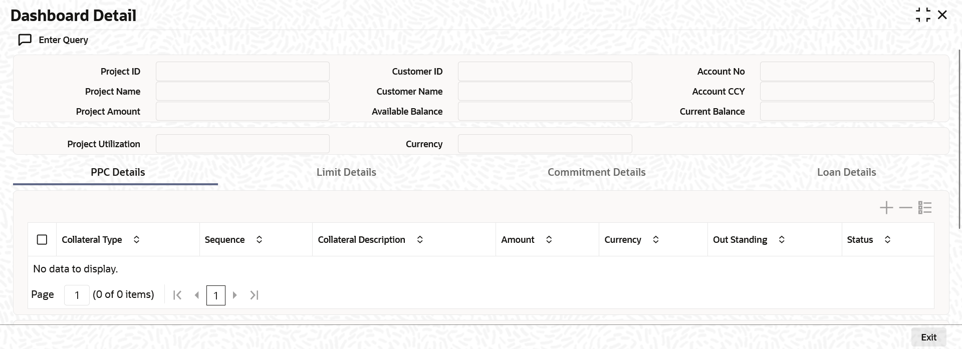

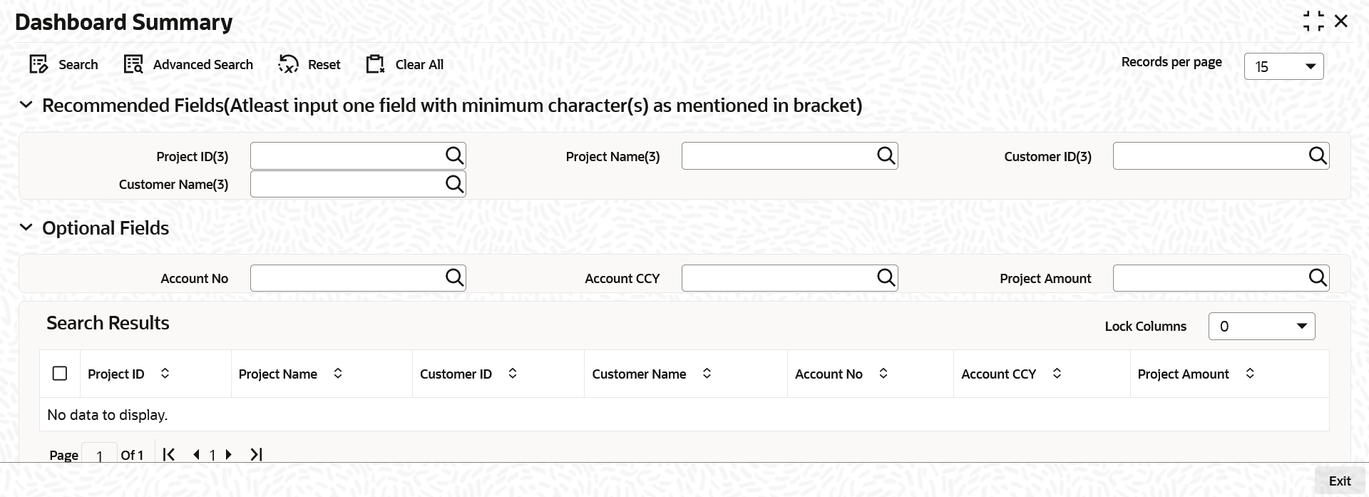

9. The bank will view the details of a project and the status of its collaterals from a Dashboard screen

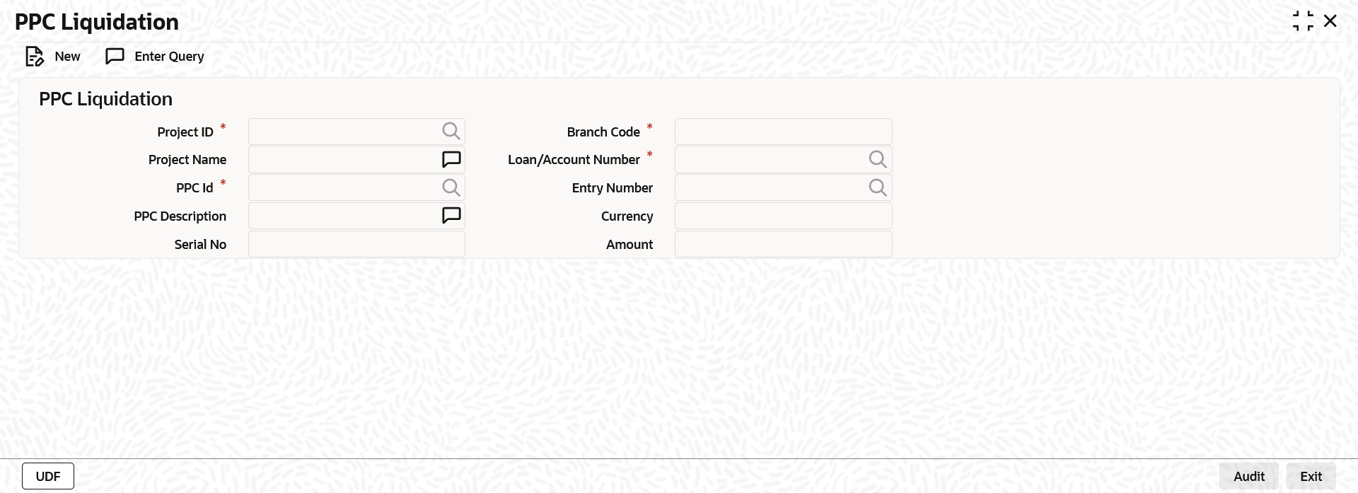

13. Using the PPC liquidation screen, you can choose the payment of the loan or credit to the project account. This transaction will be logged under the PPC.
14. PPC liquidation will be allowed even without the ‘Entry No.’, say, in case the contractor did not receive money due to contractual terms elapse etc. The system will display an override message when such an input is made.
15. Partial liquidation of PPC is allowed and they will be tracked. In case ‘Entry No’ is provided, loan payment will be considered only to the extent of PRINCIPAL payment and other component payments will not be considered.

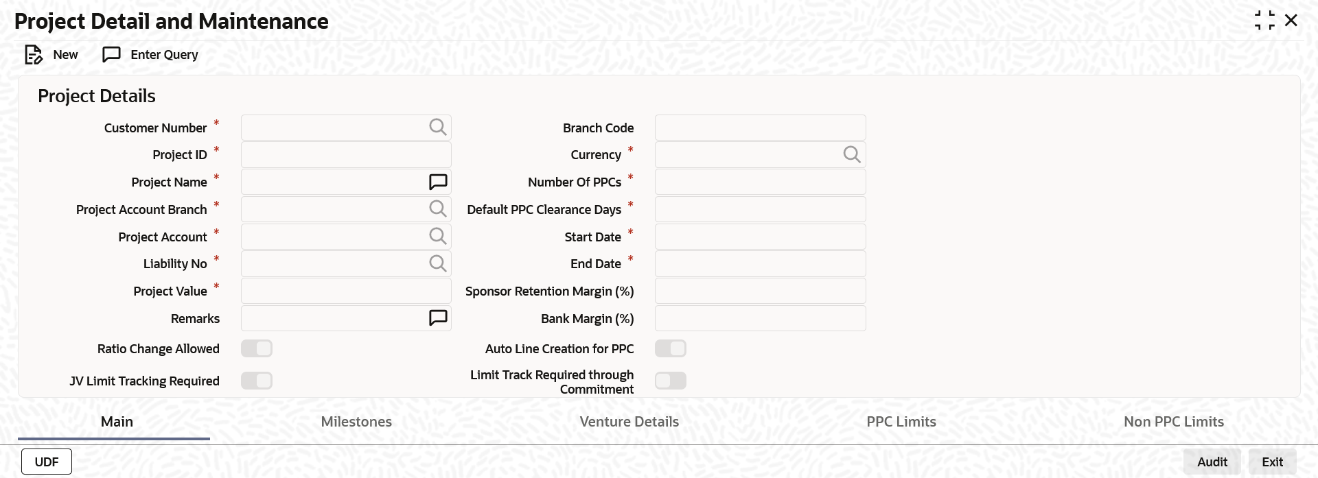

32.2.1 Maintaining Project Financing Transaction
Oracle FLEXCUBE allows you to maintain the project finance transaction in a bank with the details of the project undertaken with the contract. You can maintain these details using ‘Project Detail and Maintenance’ screen. To invoke this screen, type ‘STDPJMNT’ in the field at the top right corner of the Application tool bar and clicking the adjoining arrow button.
The screen is as shown below:
Specifying the Project Details
Customer Number
Specify the customer number.
Project ID
Specify the project identification number.
Project Name
Specify the name of the project.
Project Account Branch
Specify the project account branch details.
Project Account
Specify the project account details.
Liability ID
Specify the liability ID.
Project Value
Specify the value of the project.
Remarks
Specify remarks, if any.
Ratio Change Allowed
Check this box if the joint venture ratio change is allowed during the course of the project.
This field is enabled only for new loans under the project financing.
Check this box if joint venture limit tracking is required.
Branch Code
The system displays the branch code.
Currency
Specify the currency details.
Number of PPCs
Specify the number of PPCs in the project.
Default PPC Clearance Days
Specify the default PPC duration for the payment.
Start Date
Specify the start date of the project.
End Date
Specify the end date of the project.
Sponsor Retention Margin (%)
Specify the retention margin for the sponsor while paying the PPC.
Bank Margin (%)
Specify the margin retained by the bank for the PPC..
If you check this box, then the system will automatically create the credit lines while authorizing the PPC. Else, you need to manually create the line and link them in the PPC screen.
By default, this field will be checked.
Limit Track Required through Commitment
If you check this box, then the system will create the commitment contracts for every automatic line creation.

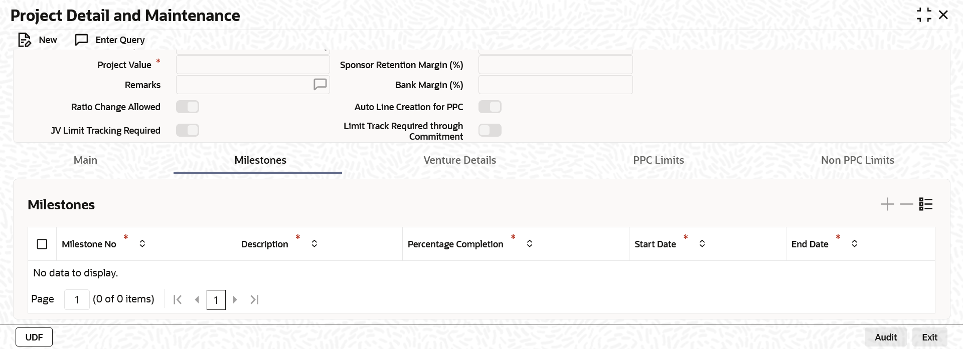

32.2.3 Milestones Tab
You can specify the records of the various milestones in the project and percentage of completion with respect to the project.
Milestone No
Specify the milestone number.
Description
Specify the description of the milestone.
Percentage Completion
Specify the percentage of completion with respect to the milestone.
Start Date
Specify the start date of the milestone.
End Date
Specify the end date of the milestone.

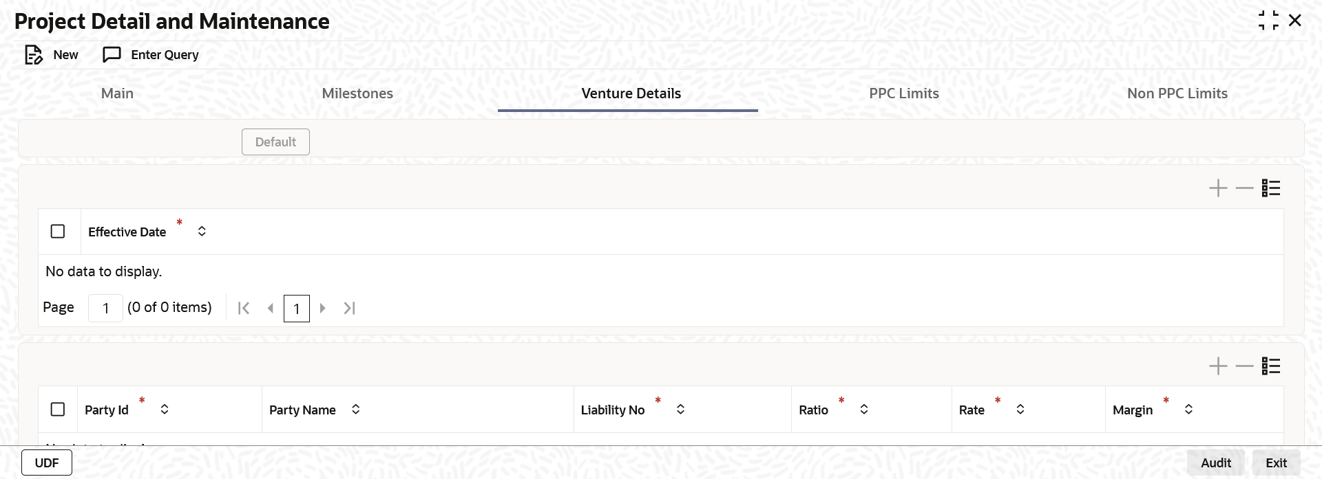

32.2.4 Venture Details Tab
You can maintain the details of the joint venture. You can also change the joint venture ratios during the course of the project, but these ratios are effective only for future loans. Each loan created for the project can store the ratios at the loan level which is defaulted based on the application ratio at the time of loan creation. All limits tracking for joint venture parties will be based on this ratio.
The system will create the limit lines for each of the project venture parties when joint venture limit tracking is required at the project level. The line ID maintained at the limits is used to create the limits automatically. Each time the PPC is created, the system will create a new limit line using the same line for each of the liability of each joint venture. Different joint venture parties will have the same commitment product which can have different interest rate.
Effective Date
Specify the effective date of the joint venture. For each effective date, the system maintains the ratio among the joint venture partners. The sum of ratios for each effective date must be equal to 100.
Party ID
The system displays the joint venture details of the project.
Party Name
The system will display the party name.
Liability ID
Ratio
Specify the percentage share of the joint venture party. The sum of all the ratios must be equal to 100.
Default Interest Rate
Specify the default interest rate that is used for the external component in the commitment product. The system will default this value to PPC.
Margin
Specify the margin applicable on the interest rate.

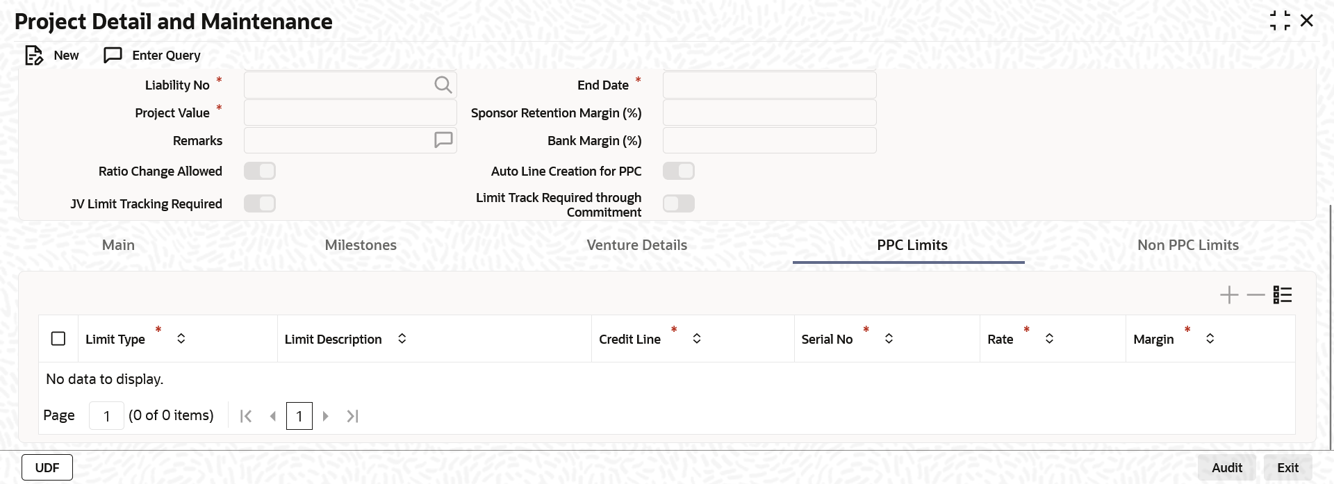

32.2.5 PPC Limits Tab
You can create the clean limit (ToD) manually using the line ID for the amount. You should then link this limit to the project account. The system creates the joint venture lines on authorization of the PPC maintenance with joint venture tracking required.
In case of manual line creation, the system will create the lines in project currency. Whenever there is a cross currency, the system will use a standard mid rate to convert from limit currency to project currency to track utilization. The LCY difference that may arise due to exchange rate differences will be handled by the ELCM CCY revaluation EOD batch.
You can view the limits detail such as line ID to create the project limits. There are two types, namely, PPC Limits and Non PPC Limits.
The screenshot for PPC Limits is as follows:
Limit Type
Specify the type of limit.
Limit Description
The system displays the limit description.
Credit Line
Specify the credit line.
Serial No
The system displays the serial number for the limit created.
Commitment Product
Specify the commitment product details used when the respective limit line is created.
Rate
Specify the rate.
Margin
Specify the margin.

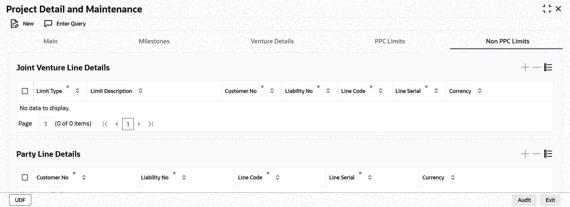

32.2.6 Non PPC Limits Tab
The screenshot for Non PPC Limits is as follows:
Maintaining Joint Venture Line Details
Limit Type
Limit Description
Customer No
Liability No
Specify the liability number.
Line Code
Specify the line code.
Line Serial
Currency
The system displays the line currency details.
Rate
Specify the rate.
Margin
Specify the margin.
JV Line
This box will be checked by default.
Maintaining Party Line Details
Customer No
Liability No
Line Code
Line Serial
Currency

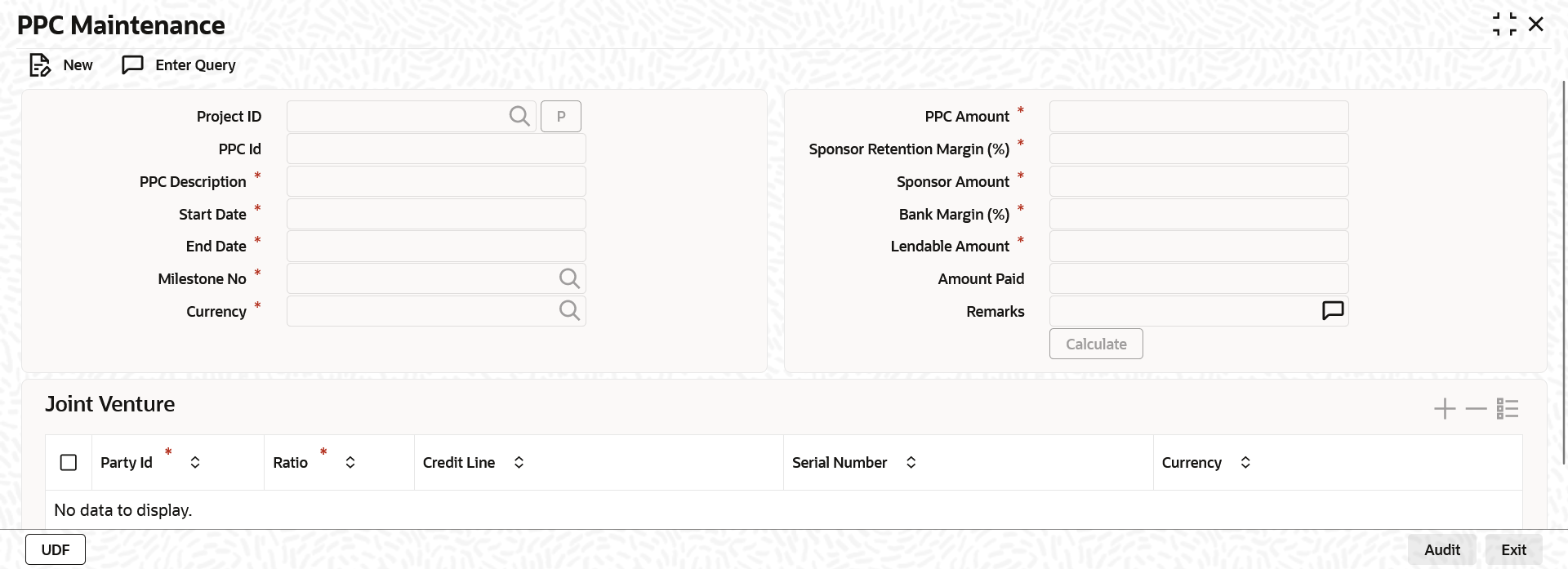

32.3 Maintaining PPC
Oracle FLEXCUBE allows the executor to maintain the PPC during the course of the project, i.e. during the course of the project, once the executor completes the milestone should inform the sponsor. The sponsor in turn, will inspect and confirms the completion of the milestone. The executor is then allowed to raise the PPC with start date and the expiry date. The system calculates the expiry date based on the default PPC clearance days. However, the sponsor can change the expiry date. The system will accept the PPC in any currency. If there is a cross currency, then the system uses a standard mid rate for converting from limit currency to project currency.
You can maintain the PPC using ‘PPC Maintenance’ screen. To invoke this screen, type ‘STDPPCMN’ in the field at the top right corner of the Application tool bar and clicking the adjoining arrow button.
Specifying PPC Maintenance Details
Project ID
Specify the project ID.
PPC ID
The system displays the PPC ID.
PPC Description
Specify the description of the PPC.
Start Date
Specify the PPC start date.
End Date
Specify the PPC end date.
Milestone No
Specify the milestone sequence number.
Currency
Specify the currency of the PPC.
PPC Amount
Specify the amount of the PPC.  If the sum of the PPC amounts for all the PPCs presented for the specific milestone is greater than the milestone percentage calculated amount an error message is displayed.
The system will create the automatic limit lines for the lendable amount arrived at after applying the sponsor retention margin and the bank margin.
The system displays the margin retained by the sponsor for this PPC. However, you can amend this field while creating the PPC.
Sponsor Amount
The system displays the sponsor amount after applying the sponsor retention margin.
Bank Margin
The system displays the margin retained by the bank for this PPC. However, you can amend this field while creating the PPC.
Lendable amount
The system displays the lendable amount after applying the bank margin.
Amount Paid
The system displays the amount that has been paid against this PPC.
Remarks
Specifying Joint Venture Details
In case of manual line linkage, you need to operationally ensure the following points:
l Synchronization of Line End date and PPC end date
l Limit lines should have amounts equivalent to that of PPC lendable amount. In case line currency is different from PPC currency, lines should be created for the equivalent of PPC lendable amount by applying the rate conversion. If there is any mismatch in the amounts, while linking the manual lines, the system will display an override message
Party ID
The system defaults the party ID from the project maintenance.
Ratio
The system defaults the joint venture share ratio from the project maintenance.
Credit Line
The system defaults the line ID. The system uses this limit line for tracking the exposure of specific joint venture party.
If joint venture limit tracking is not required at project level, the system will not create the lines.  In case auto creation of lines is not chosen, then you need to manually create limit lines and link them in this screen.
Serial Number
Specify the line serial of the credit line.
Currency
The system displays the line currency.
After specifying the PPC amount, click on ‘CALC” button. The will calculate the sponsor margin and the bank margin and arrive at the sponsor amount and the lendable amount respectively.
32.4 Maintaining PPC Liquidation
You can maintain the liquidation details in the PPC screen, where in you can choose the payment of the loan or credit to the project account. This transaction is logged in the PPC. To invoke the PPC Liquidation screen, type ‘STDPPCLQ’ in the field at the top right corner of the Application tool bar and clicking the adjoining arrow button.
Project ID
Project Name
The system displays the name of the project ID selected.
PPC ID
Specify the PPC ID.
PPC Description
The system displays the description for the PPC ID selected.
Loan/Account Number
Specify the loan or the account number.
Entry Number
Specify the entry number. If you have not specified the entry number, then the system will display an override message.
Amount
The system displays the amount for liquidation. However, you can amend this field.
Branch Code
Specify the branch code.
Currency
The system displays the currency details.

32.5.1 Viewing Dashboard Details
Oracle FLEXCUBE allows you to view the details of the PPC available in the project such as joint venture ratios, balance in the project account, the project lines and their limits for each project line, etc. You can view these details using ‘Dashboard Details’ screen. To invoke this screen, type ‘STDPJDSH’ in the field at the top right corner of the Application tool bar and clicking the adjoining arrow button.
You can view the following details:
l Project ID
l Project Name
l Customer ID
l Customer Name
l Available Balance
l Account Number
l Account Currency
l Project Limit
l Project Utilization
l Current Balance
32.5.2 PPC Details Tab
You can view the PPC details by clicking on the ‘PPC Details’ tab in the ‘Dashboard Details’ screen.
l Collateral Details
Collateral Type
Sequence
Collateral Description
Amount
Outstanding
Status
l Venture Details
Party ID
% Share
Limit CCY
Limit
Available
32.5.3 Limit Details Tab
You can view the limit details by clicking on the ‘Limit Details’ tab in the ‘Dashboard Details’ screen.
l Project Line Details
Line ID
Line Serial
Limit
Utilized
Paid
l Customer Line Details
Party ID
% Share
Line ID
Line Serial
Limit
Utilized
Paid
32.5.4 Commitment Details Tab
You can view the commitment details by clicking on the ‘Commitment Details’ tab in the ‘Dashboard Details’ screen.
l Contract Reference
l Currency
l Amount
l Outstanding Amount
l Maturity Date
32.5.5 Loan Details Tab
You can view the loan details by clicking on the ‘Loan Details’ tab in the ‘Dashboard Details’ screen.
l Currency
l Amount
l Maturity Date
32.5.6 Querying Dashboard Details
Oracle FLEXCUBE allows you to query the dashboard details based on the Project ID, Project Name, Customer ID, Customer Name, Account Number. You can view these details using ‘Dashboard Summary’ screen. To invoke this screen, type ‘STSPJDSH’ in the field at the top right corner of the Application tool bar and clicking the adjoining arrow button.
You can query the record based on the following details:
l Project ID
l Customer ID
l Account Number
l Project Limit
l Project Name
l Customer Name
l Account Currency
You can double-click on a specific record to view the detailed screen.

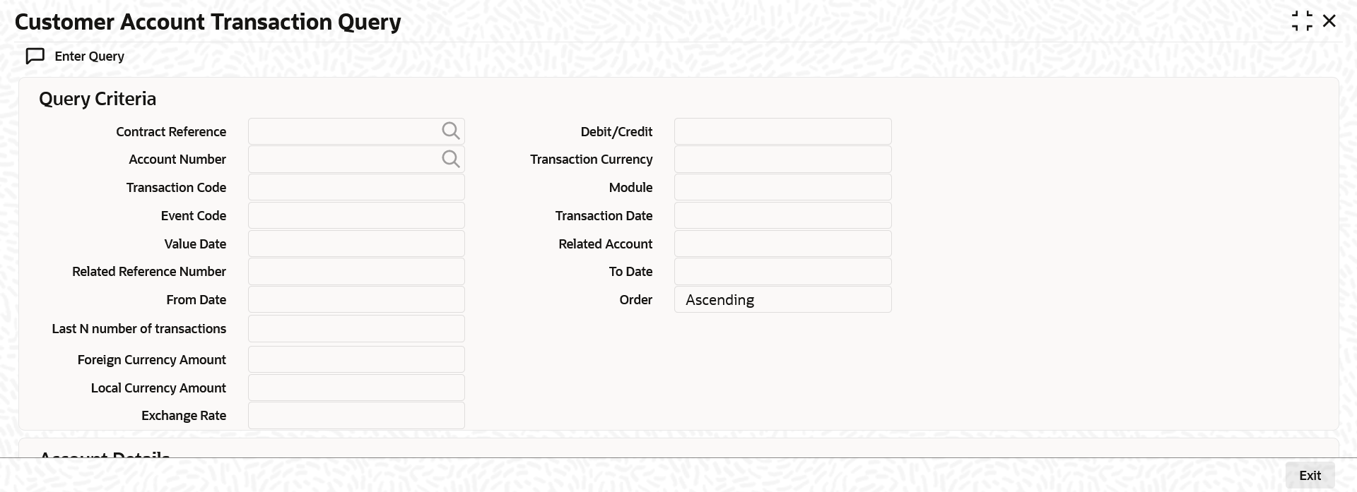

32.6 Querying Accounting Entries
Oracle FLEXCUBE allows you to view the accounting entry serial number which can be used in PPC liquidation screen for marking a specific credit entry for query. You can view these details using ‘Customer Account Transaction Query’ screen. To invoke this screen type ‘ACDTRNQY’ in the field at the top right corner of the Application tool bar and click on the adjoining arrow button
l Account Number
l Debit/Credit
l Transaction Code
l Currency
l Event Code
l Module Code
l Value Date
l Transaction Date
l Related Reference
l Related Account
l From Date
l Last N Number of Transactions
l To Date
To view the joint holder’s details of an account and the mode of operation maintained at the account level, place the cursor on the Account Number field and press Ctrl+J. The system displays the ‘Joint Holder’ screen.
For more information on the ‘Joint Holder’ screen refer to the section ‘Joint Holder Maintenance’ in this User Manual.
Clicking on the ‘Query’ button, the system displays the transaction details. You can double-click on a specific record to view the detailed screen.
Note
You can query for a specific number of previous records by entering the value in ‘Last N Number of Transactions’. By default, it is set as 100.
When you click ‘Query’ button, the system validates whether Last N.number of transactions is greater than the menu level MAX_RES_ROWS of the function ID ‘ACDTRNQY’. If it is found greater than that, then the system displays a configurable message ‘Last N number of transactions is greater than the allowed maximum transactions to be retrieved’.
If you do not enter the last N number of transaction and click the ‘Query’ button, and the number of transactions to be retrieved is greater than the menu level MAX_RES_ROWS for the function ID ‘ACDTRNQY’, then the system will retrieve only the first MAX_RES_ROWS number of transaction and display an information message ‘Displaying only first[MAX_RES_ROWS] transactions’.
The starting balance and running balance fields of the Customer Account Transac­tion Query (ACDTRNQY) are not be applicable if you try to retrieve the Last N trans­action.
