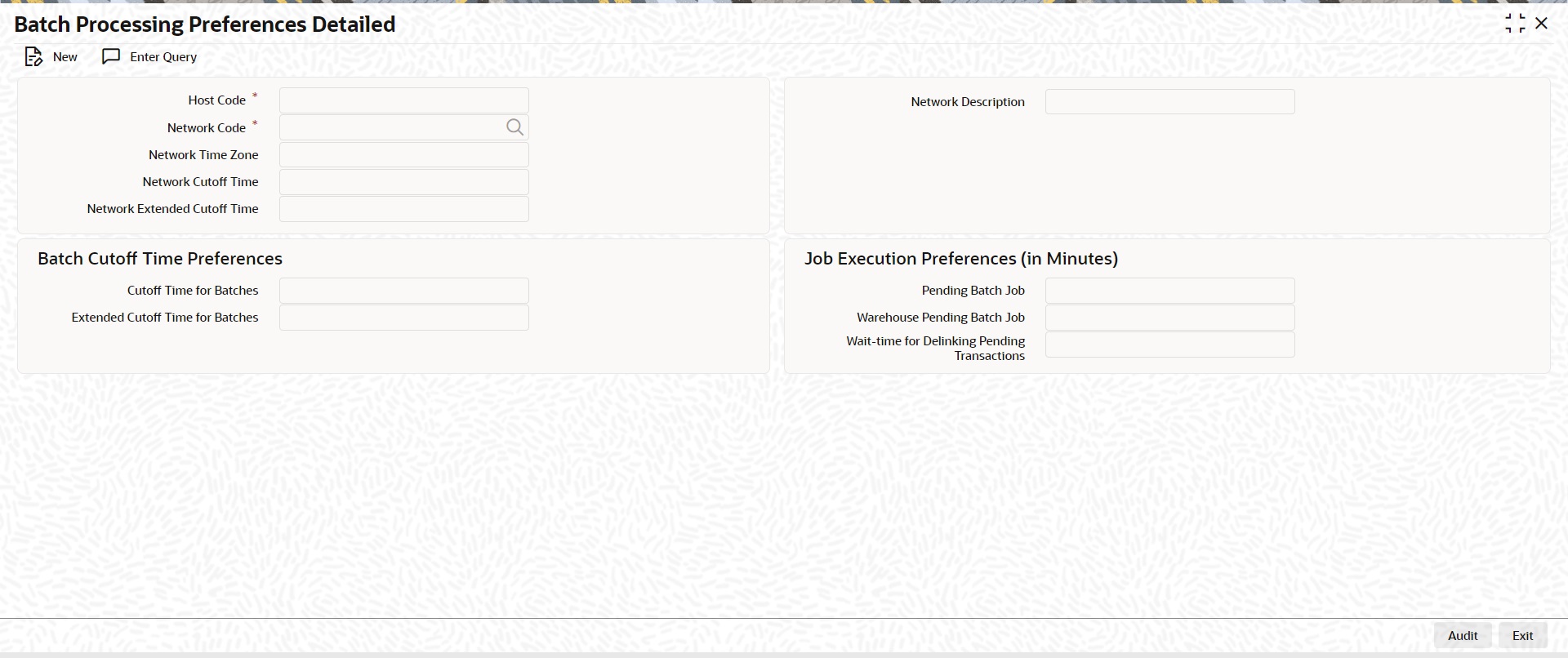

2.1.1 Batch Processing Preferences
This is a Host level maintenance. You can specify the time interval to process a batch, Job Execution intervals and Cutoff time for the Networks here.
You can invoke the ‘Batch Processing Preferences Detailed’ screen by typing ‘PMDBTPRF’ in the field at the top right corner of the application toolbar and clicking the adjoining arrow button. Click New button on the Application toolbar.
Specify the following fields:
Host Code
The system displays the Host Code of the logged in branch by default when you click on New.
Network Code
Specify the Network Code in the multi grid block. Select the specific Network for which the cutoff check happens based on the time interval specified here.
Network Time Zone
For the Networks for payment type 'ACH CT', the time zone is defaulted from Dispatch Preferences (PMDACHDS).
Note
For other Networks SEPA CT/ NACHA / Book Transfer, you can specify from list of values. All valid Time Zones are listed for the field.
Network Cutoff Time
The system displays the Network cutoff time based on the Network Maintenance.
Network Extended Cutoff Time
System displays the Extended Network cutoff time maintained in Dispatch Preferences (PMDACHDS) for Networks of payment type 'ACH CT'.
'Extended cutoff time for Batches' can be maintained only if Extended cutoff is maintained for the Network in Dispatch Preferences (PMDACHDS).
Batch extended cutoff should be maintained earlier to the Network extended cutoff. System validates the same.
Note
For other Networks, the fields 'Extended Cutoff Time for Batches' and 'Extended Network Cutoff' are not applicable.
Network Description
System defaults the description on the Network Code selected.
Batch Cutoff Time Preferences
Specify the Cut off time in HH:MM format.
This is the time for Job processing cutoff. After the specified time, any transaction/batch that is approved, will be moved to warehouse Queue and is initiated on next working day.
Specify the Extended cutoff time for batches as per the Network Time Zone. System validates that the 'Extended Cutoff Time' maintained is later than the 'Cutoff time for Batches'.
Job Execution Preferences (in Minutes)
Pending Batch Job
Specify the Job Execution Interval in minutes for the Pending Batch Job.
System creates new consol for success / failed / seized transactions every ‘n’ minutes as specified in the ‘Pending Batch Job’ till the cutoff time specified.
This is done, post Wait time for batch processing is completed.
Warehouse Pending Batch Job
Specify the Job Execution Interval in minutes for the Warehouse Pending Batch Job based on which the pending transactions are picked from the warehouse queue.
Note
Warehouse pending batch, are the transactions that are pushed to queue after the breach of cutoff time. The transactions that are approved post cutoff time is also moved to ware­house queue.
Wait-time for Delinking Pending Transactions
Specify the wait time for the Batch process to get completed.
Post the specified wait time, when the batch is completed, system validates the batch file transactions. Following scenarios are possible post batch processing:
l The transactions that are successfully processed are further sent for liquidation and is split as new batch.
l The transactions that are pending will remain in the Original Consol. All failed/success/seized transactions  are created as a new consol and is processed again based on the interval specified in ‘Pending batch Job’.

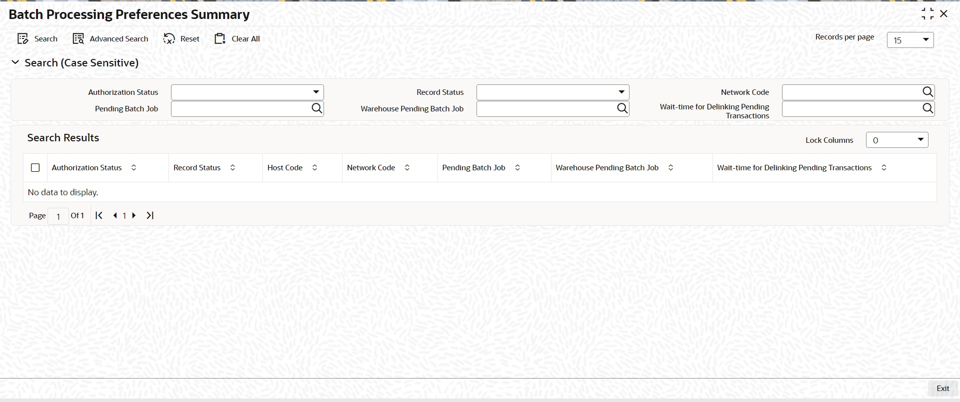

2.1.1.1 Batch Processing Preferences Summary
Batch Processing Preferences maintained in the ‘Batch Processing Preferences Detailed’ screen can be viewed here.
You can invoke the “Batch Processing Summary” screen by typing ‘PMSBTPRF’ in the field at the top right corner of the application toolbar and clicking the adjoining arrow button
You can click ‘Search’ button to view all the pending functions. However, you can to filter your search based on any of the following criteria:
l Authorization Status
l Record Status
l Pending Batch Job
l Warehouse Pending Batch Job
l Wait Time for Batch processing (in minutes)
When you click ‘Search’ button the records matching the specified search criteria are displayed.

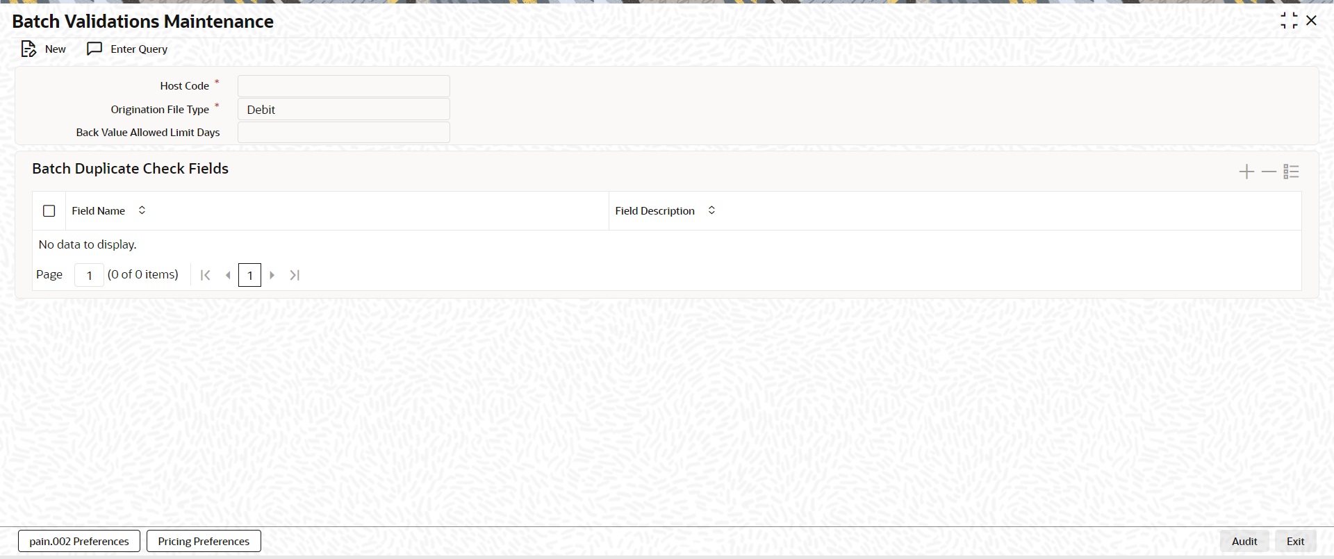

2.1.2 Batch Validations Maintenance
You can maintain the Batch duplicate check parameters and Back value allowed days, using this screen.
You can invoke this screen by typing ‘PMDBTVAL’ in the field at the top right corner of the Application tool bar and clicking the adjoining arrow button.
You can specify the following details:
Host Code
The system defaults the host code of transaction branch on clicking ‘New’.
Origination File Type
Select the Origination File Type from following drop down list:
l Debit
l Credit
Back Value Allowed Limit Days
You can specify the number of days for which back value date can be allowed for Requested execution date.
Batch Duplicate Check Fields
Field Name
Specify the Filed Name from the list of values.
Field Description
This filed displays Field Description, when Filed Name is selected.

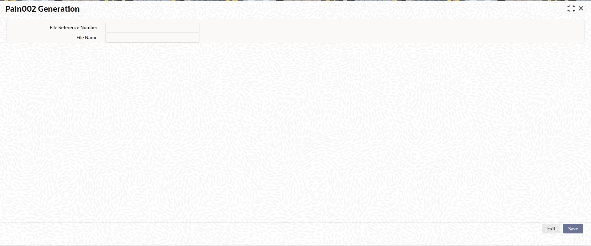

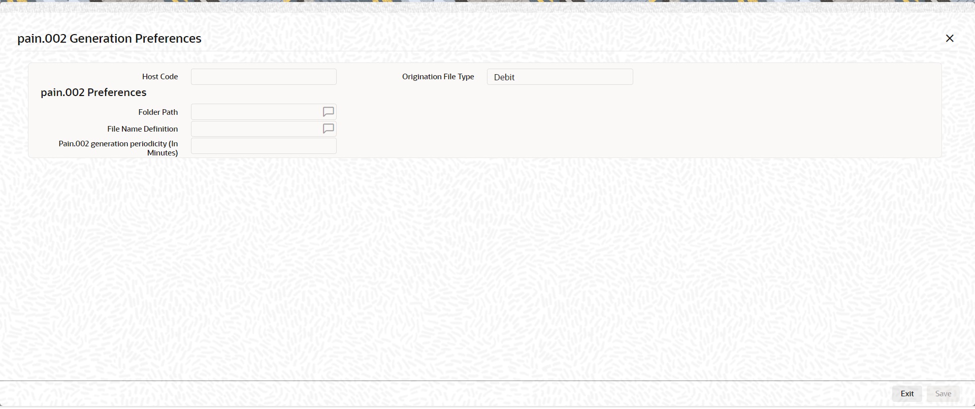

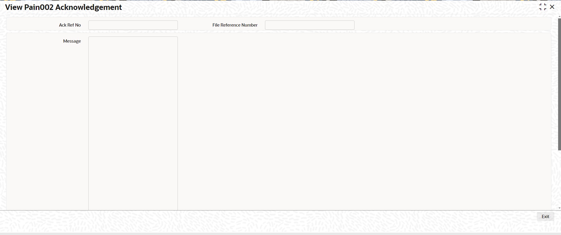

2.1.2.1 pain.002 Preferences
You can invoke “pain.002 Generation Preferences” screen by clicking on pain.002 Preferences button.
Below fields are defaulted from the maintenance screen:
l Host Code
l Original File Type
Folder Path
Specify the Folder Path. File path is given for the main Folder.'init' and 'completed' sub folders are to be maintained within the main folder
File Name Definition
File Name Definition is defaulted as <FILE_NAME_PAIN001><DATE_PAIN002><TIME_PAIN002>.
Pain.002 generation periodicity (In Minutes)
Specify the Date and Time in the YYYYMMDDHHMMSSSSS format.

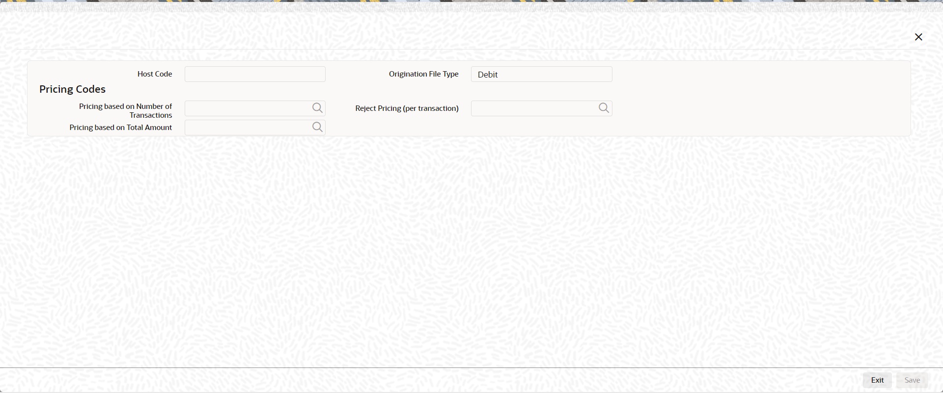

2.1.2.2 Pricing Preferences
l Host Code
Pricing Codes
Pricing based on Number of Transactions
Specify the Pricing based on Number of Transactions from the list of values. All valid pricing codes maintained for the Host are listed.
Pricing based on Total Amount
Specify the Pricing based on Total Amount from the list of values. All valid pricing codes maintained for the Host are listed.
Reject Pricing (per transaction)
Specify the Reject Pricing from the list of values. All valid pricing codes maintained for the Host are listed.

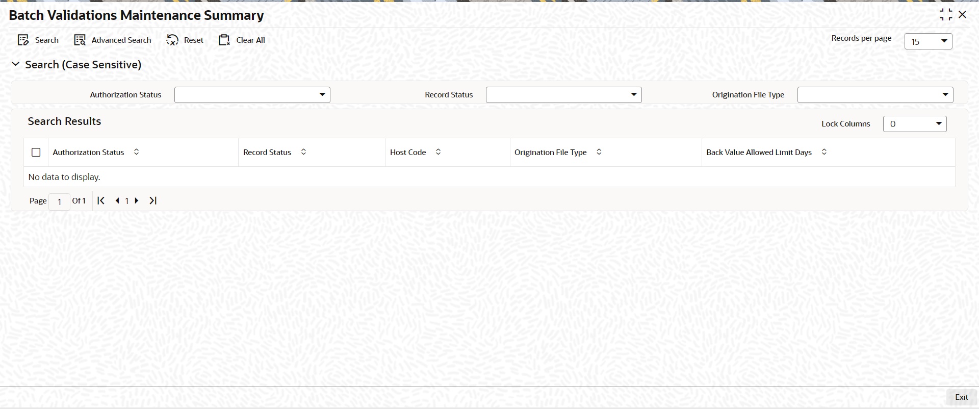

2.1.2.3 Batch Validations Maintenance Summary
You can invoke “Batch Validations Maintenance Summary” screen by typing ‘PMSBTVAL’ in the field at the top right corner of the Application tool bar and clicking on the adjoining arrow button. Click new button on the Application toolbar.
You can search using one or more of the following parameters:
l Record Status
l Origination File Type
Once you have specified the search parameters, click ‘Search’ button. The system displays the records that match the search criteria.

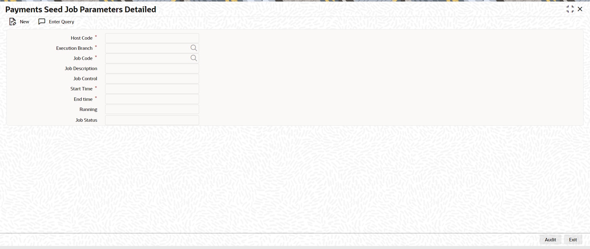

2.1.3 Payments Seed Job Parameter
Payments Seed Job Parameters screen can be used to configure Start and End Time for an auto job related to bulk file processing.
You can invoke the ‘Payments Seed Job Parameters Detailed” screen by typing ‘PMDSJBPR’ in the field at the top right corner of the application toolbar and clicking the adjoining arrow button. Click new button on the Application toolbar.
Host Code
The system indicates the user’s logged in branch Host when you click on New.
Execution Branch
The branch selected in this field will be used for checking the local branch holidays for deriving the next execution date for the job. Any valid branch linked to the Host can be selected.
Job Code
Select the job code from the following list:
l C2B_HYBRID_FUTURE_JOB   -  Job code for future valued transactions
l C2B_HYBRID_NETWORK_RESOLUTION_JOB  - Job code for Network resolution transaction
l C2B_HYBRID_POST_WAIT_PENDING_JOB  - Job code for post wait pending job
l C2B_HYBRID_PRE_WAIT_PENDING_JOB - Job code for pre wait pending job
l C2B_PAIN002_GENERATION_JOB - Job code for generation of periodic pain.002 file
Job Description
This is defaulted based on the selected code.
Job Control
Select from the list of values displayed. Options are - Automatic / Manual.
Start Time
Specify the Start Time for the auto job configured.
End Time
Specify the End Time for the auto job configured.
Running
System defaults the value as ‘N’ to indicate if the job is running or not.
Job Status
System defaults the value as ‘Active’.
Note
ReST service 'PMJobStatusService' is available to control the seed job status from Active to Hold status or vice versa

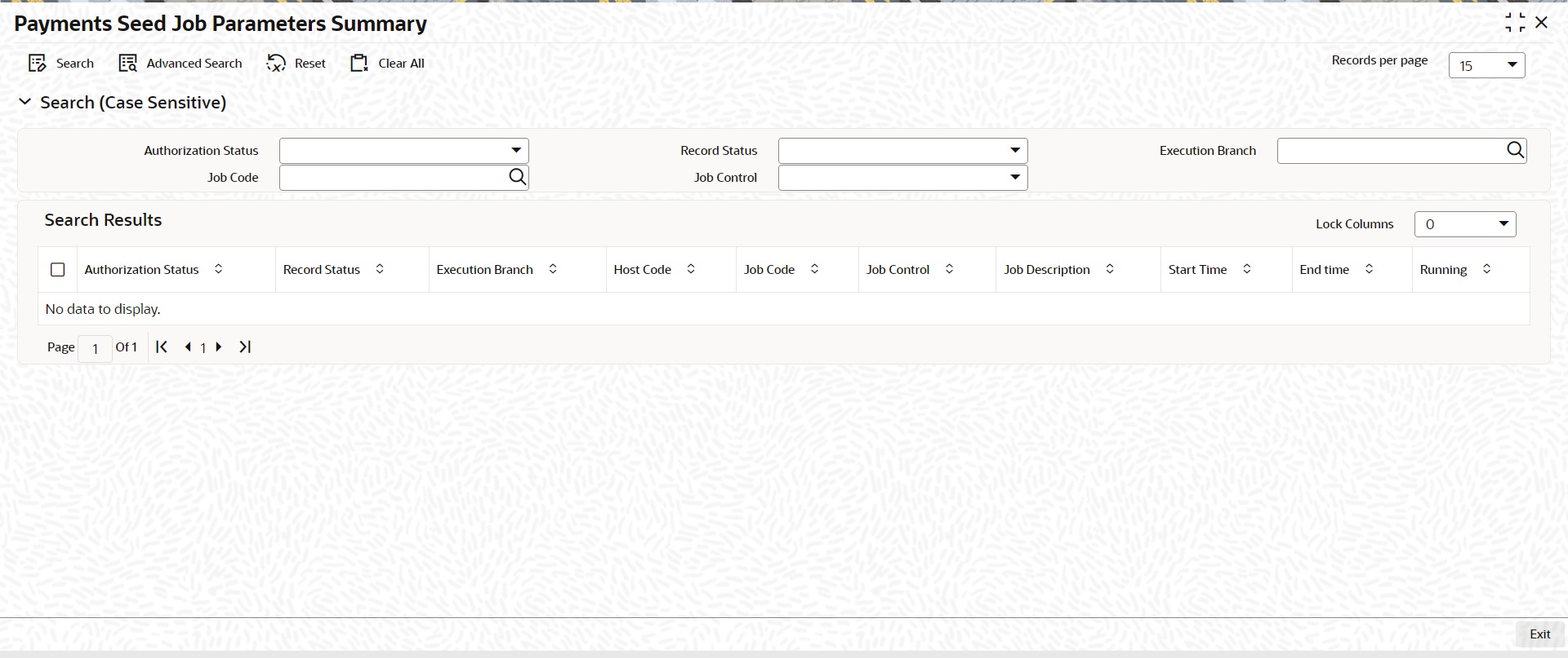

2.1.3.1 Payments Seed Job Parameters Summary
You can invoke the ‘Payments Seed Job Parameters Summary” screen by typing ‘PMSSJBPR’ in the field at the top right corner of the application toolbar and clicking the adjoining arrow button. Click new button on the Application toolbar.
l Record Status
l Execution Branch
l Job Code
l Job Control
l Record Status
l Execution Branch
l Host Code
l Job Code
l Job Control
l Job Description
l Start time
l End Time
l Running
Double click a record or click the ‘Details’ button after selecting a record to view the detailed screen.

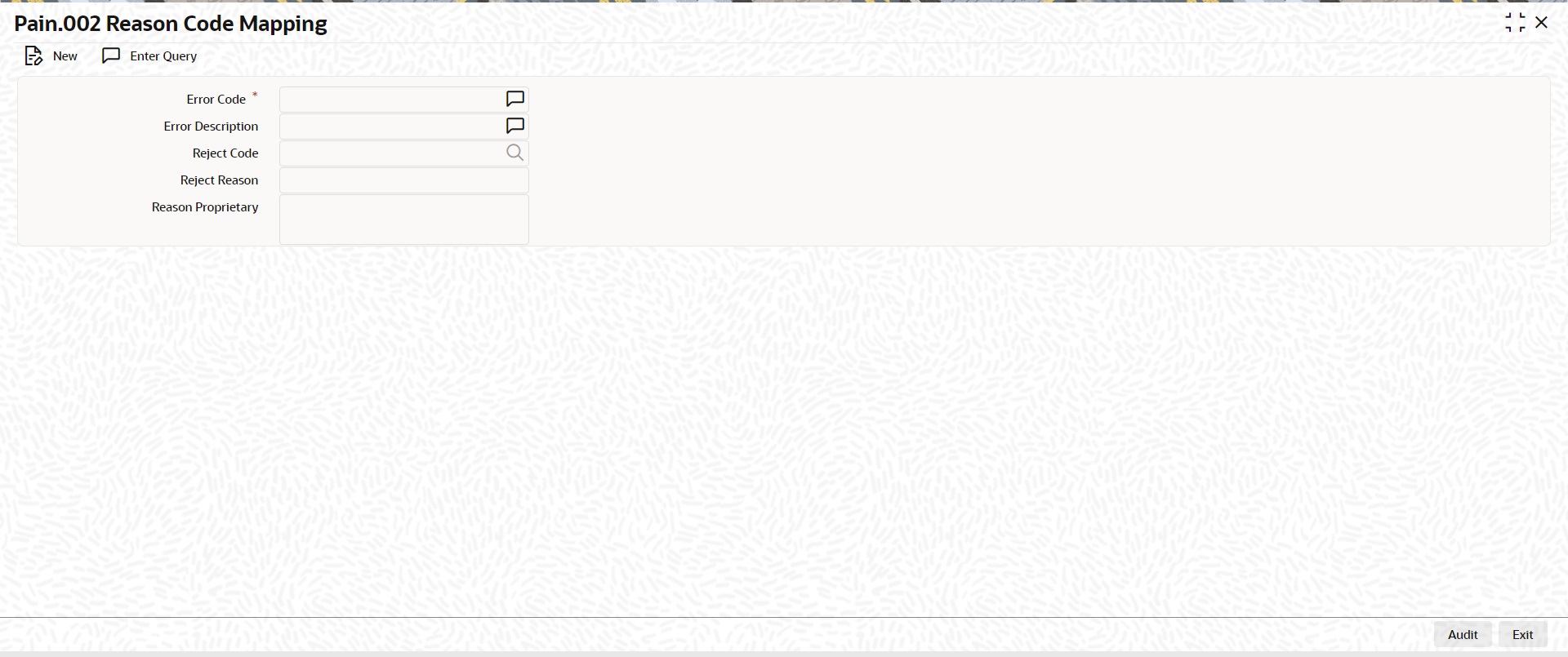

2.1.4 pain.002 Reason Code Mapping
You can link the system error codes with the valid reason codes through this screen.This is a  common maintenance screen for group / batch / transaction level status.
You can invoke the ‘pain.002 Reason Code Mapping’ screen by typing ‘PMDPNRJT’ in the field at the top right corner of the application toolbar and clicking the adjoining arrow button. Click new button on the Application toolbar.
You can specify the following details in the fields:
Error Code
Select the Error Code from the list of values that is to be mapped with the Reason code.
Error Description
System defaults the description for the error code selected.
Reject Code
Select the code from the list of values. ISO reject codes available in External reason codes are listed here.
Reject Reason
System defaults the Reason for the Reject Code selected.
Reason Proprietary
You can specify the proprietary reason, when ISO Code is not selected in Reject Code.In this case, you can specify the proprietary reason. Maximum of 35 characters are allowed to enter.And the Reject Reason can be manually entered.
Note
It is mandatory to provide either reason code or reason proprietary. Both cannot be pro­vided for the same record.

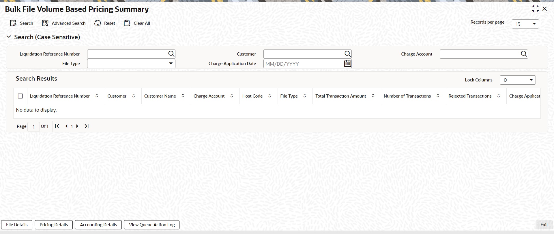

2.1.5 Bulk File Volume Based Pricing Summary
You can invoke the ‘Bulk File Volume Based Pricing Summary” screen by typing ‘PMSFILPR’ in the field at the top right corner of the application toolbar and clicking the adjoining arrow button. Click new button on the Application toolbar.
l Liquidation Reference Number
l File Type
l Customer
l Charge Application Date
l Charge Account
You can perform below actions on this screen:
Action
Description
File Details
This action opens File Details screen for which the liquidation reference is applicable.
Pricing Details
This actions opens respective Pricing Details screen with pricing entries that are liquidated.

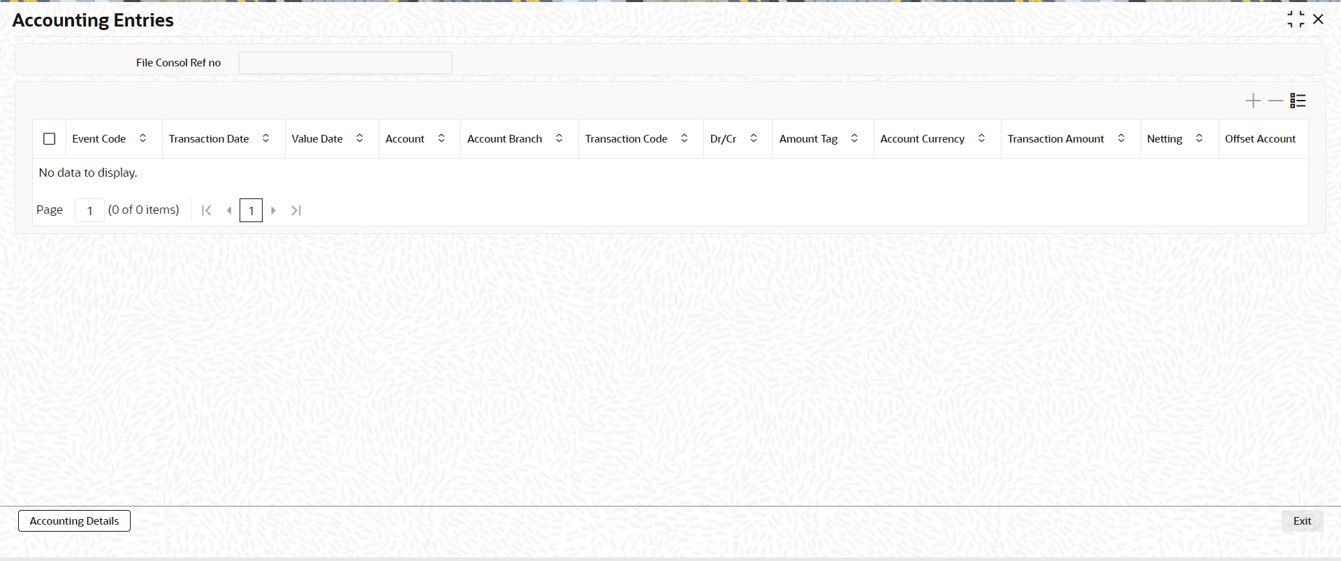

Accounting Details
This action is for Accounting Entries.

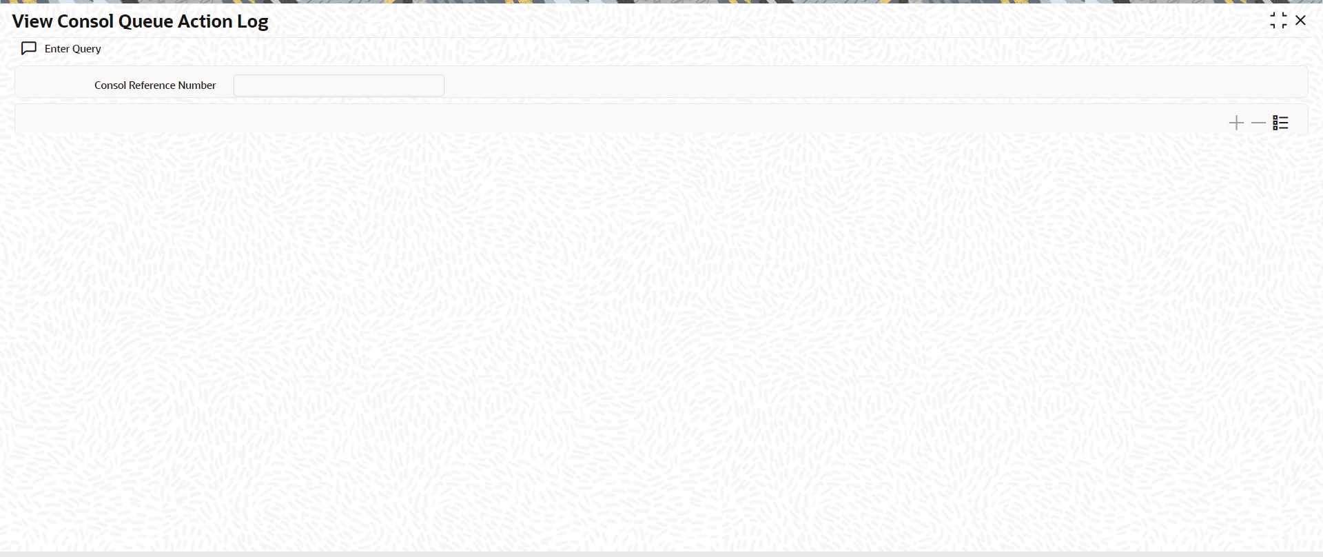

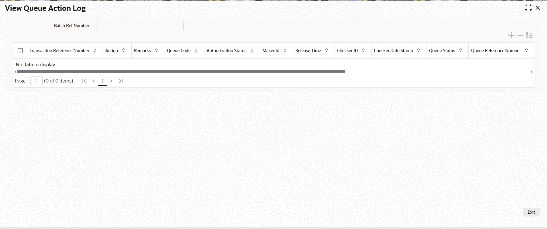

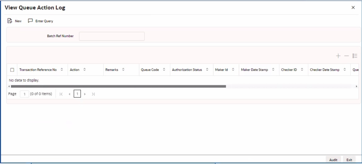

View Queue Action Log
This action opens View Queue Action Log sub screen.

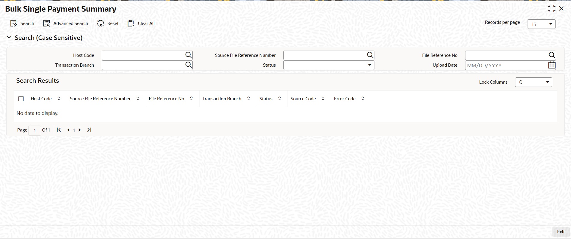

2.1.6 Bulk Single Payment Summary
The requests received through bulk SPS service can be viewed from this screen. You can invoke the ‘Bulk Single Payment Summary” screen by typing ‘PMSBLKSP’ in the field at the top right corner of the application toolbar and clicking the adjoining arrow button. Click new button on the Application toolbar.
l Host Code
l File Reference No
l Status
l Source File Reference Number
l Transaction Branch
l Upload Date

l A batch is closed and Network cutoff check/ accounting are done if
All transactions are processed successfully.
OR
Processing preferences is completed ahead of Host network cutoff or completion of the wait time configured in Batch.
l For example, a file is received at 10 a.m. and another file at 2.30.p.m. Wait time for Batch Processing maintained is 2 hours and Host network cutoff is @3.45.
If all transactions are not processed successfully for the first file, @ 12.p.m, system  segregates the successful transactions from the parent batch and creates a child batch. This batch of successful transactions are processed further. The pending transactions remain in the original batch.
For the second batch wait time ends at 4.30 p.m. Since the Host network cutoff is earlier to this, the segregation of successful transactions to a new batch happens at 3.45.

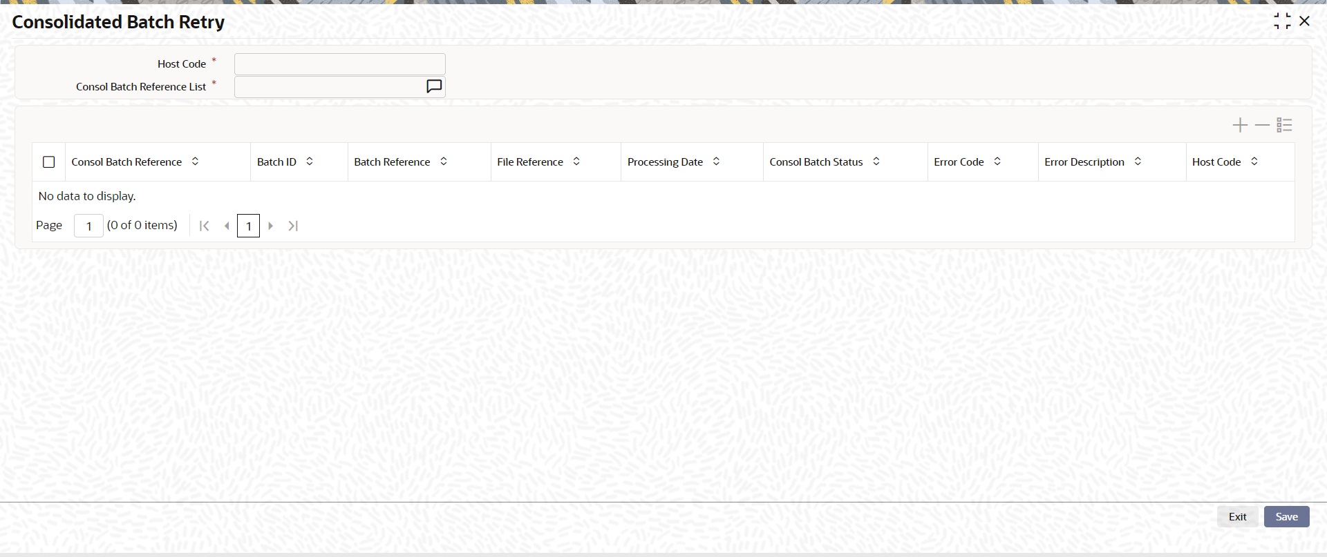

The pending batch will be checked again for successful transactions at regular intervals. This will be achieved by configuring a job which can be run at pre-defined intervals. The time interval can be set in minutes.
The check for successful transactions will continue till the Host Batch cutoff time is reached.
l If pending transactions are remaining in the batch even after reaching the batch cutoff time, the batch is carried forwarded to next business day.
The pending transactions in the batch is triggered every ‘n ‘ minutes as maintained in Batch Processing Preferences (PMDBTPRF). This process continues till the Batch Cutoff is reached.

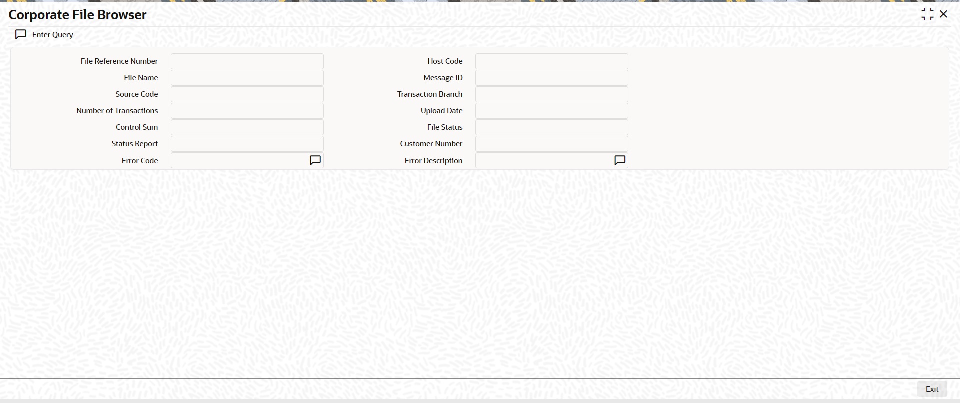

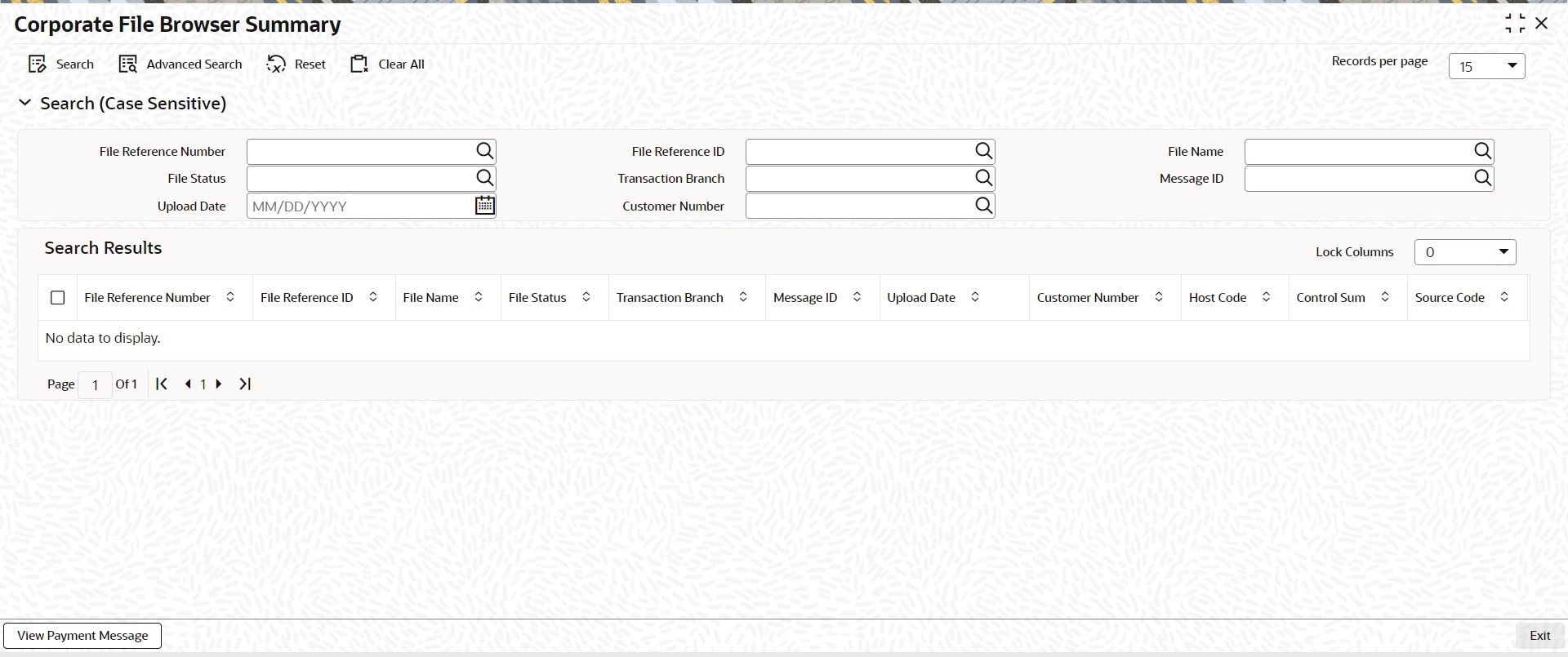

2.2.4 Corporate File Browser
Corporate File Browser Screen is provided for users to view all the received pain.001 files. Batch IDs received in the file are stored for each batch processed and is available as a transaction level information for view and query.
You can invoke the ‘Corporate File Browser’ screen by typing ‘PMDUPDST’ in the field at the top right corner of the application toolbar and clicking the adjoining arrow button. Click new button on the Application toolbar.
Query the details by entering the File Reference Number.The file details are displayed by the system on executing the query.
l Host Code
l File Name
l Message ID
l Source Code
l Number of Transactions
l Upload Date
l Control Sum
l File status –Accepted/Rejected

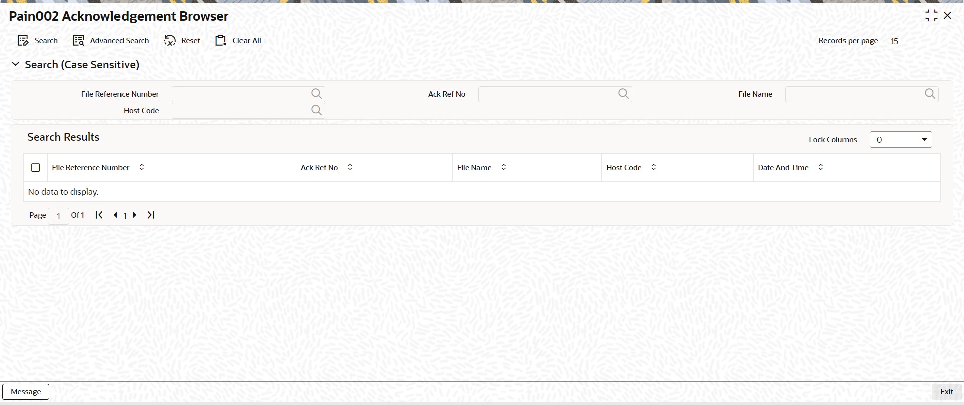

l Status Report-pain.002 generated/dispatched
l Customer Number
l Error Code
l Error Description
2.2.4.1 Viewing Corporate File Browser Summary
You can invoke the ‘Corporate File Browser Summary’ screen by typing ‘PMSUPDST’ in the field at the top right corner of the application toolbar and clicking the adjoining arrow button. Click new button on the Application toolbar.
l File Reference Number
l File Reference ID
l File Name
l File Status
l Message ID
l Customer Number
When you click ‘Search’ button the records matching the specified search criteria are displayed. For each record fetched by the system based on your query criteria, the following details are displayed:
l File Reference ID
l File Name
l File Status
l Message ID
l Upload Date
l Customer Number
l Host Code
l Control Sum
l Source Code
l Status Report
Action Buttons
View Payment Message
You can invoke the screen by clicking ‘ View Payments Message’ action button in Corporate File Browser Summary screen.
You can select a record in the Corporate File Browser Summary’ screen ‘PMSUPDST’ and click on View Payment message button to view the message details.

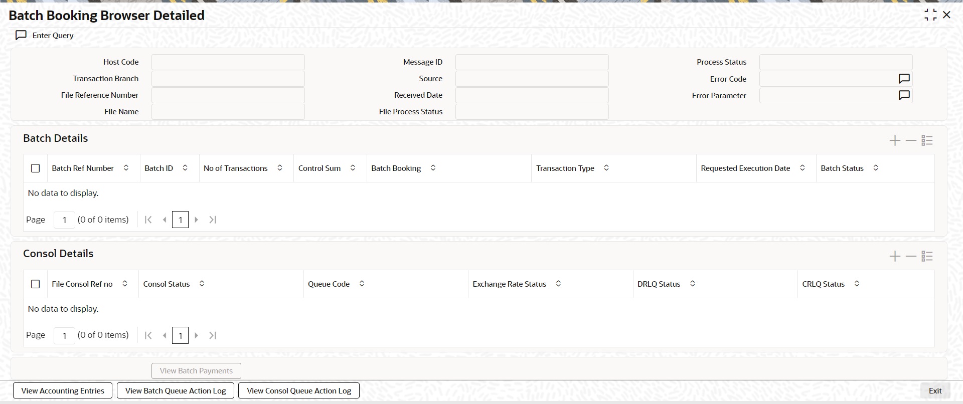

2.2.5 Batch Booking Browser
You can view the batches received in a file in this screen. Also, you can view all the linked Consol batches by selecting a particular batch.
You can invoke the ‘Batch Booking Browser Detailed’ screen by typing ‘PMDBATBR’ in the field at the top right corner of the application toolbar and clicking the adjoining arrow button. Click New button on the Application toolbar.
Input a valid File Reference Number and click on Execute Query. System defaults all the details pertaining to the batches and Consol batches. Following are the details displayed:
l Host Code
l File Name (Name of the pain.001 file uploaded)
l Message ID (Is a unique ID for all the batches)
l Source
l Received Date
l Process Status (Displays the Process status for all the batches)
l Error Code
l Error Parameter
Batch Details
Batch Ref Number
Displays the Batch Ref number for the multiple batches created
Batch ID
Displays the unique Batch ID given in the pain.001 file before processing.
No of Transactions
Displays the no of transactions specified in each batch.
Control Sum
Displays the sum of transaction amount for the no of transactions specified in each batch
Batch Booking
Displays the Booking flag value.
Transaction Type
Displays the type of transaction as - Debit/Credit
Requested Execution Date
Displays the date of execution date and it is the current date and its the date provided in <ReqdExctnDt>tag of pain001
Also the following details are displayed in the Batch Details grid:
l Batch Status
l Queue Code
l Network Resolution Status
l Co ID
l Customer No
l Debit Account
l Debit Account Branch
l Debit Account Currency
l Error Code
l Error Description
Consol Details
Following are the details displayed in the Consol Details grid:
l File Consol Ref No
l Consol Status (If the consol is success/cancelled/seized/moved to queue/Future dated)
l Queue Code
l Exchange Rate Status
l DRLQ Status (Debit Liquidation Status)
l CRLQ (Credit Liquidation Status)
l ECA Status (Credit Approval Status)
l Post Cutoff
l Debit Currency
l Total Debit Amount (sum of the transactions in the consol)
l Exchange Rate
l Payment Category (If its urgent/non-urgent)
l Payment Type (displays the respective payment types)
l Process Date
l FX Reference
l Network Code
l Error Code
l Error Description
Following view actions can be performed from this screen:

2.2.5.2 View Accounting Entries
You can view the accounting entries for the selected Consol by clicking the ‘ View Accounting Entries’ action tab present in the screen. Entries can either be consolidated or Itemised based on the preferences defined in the pain.001 file.
2.2.5.3 View Batch Queue Action Log
You can view all the queue actions for the selected batch by clicking the ‘ View Batch Queue Action Log’ action tab present in the screen.
2.2.5.4 View Consol Queue Action Log
You can view all the queue actions for the selected Consol by clicking the ‘View Consol Queue Action Log’ action tab present in the screen.
For the queue actions listed, you can view the request sent and response received, by clicking the ‘View Request Message’ and ‘View Response Message’ action buttons respectively.

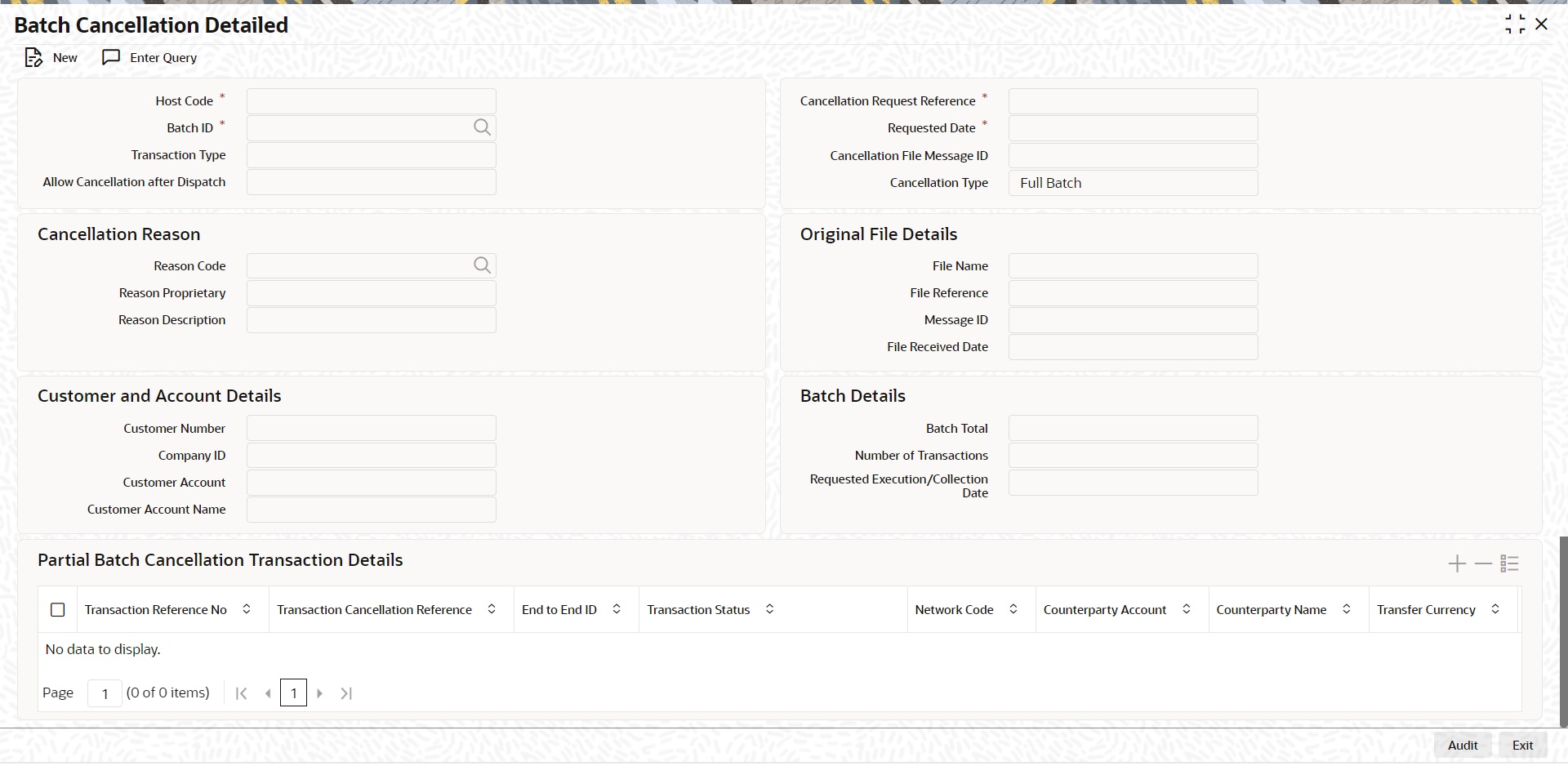

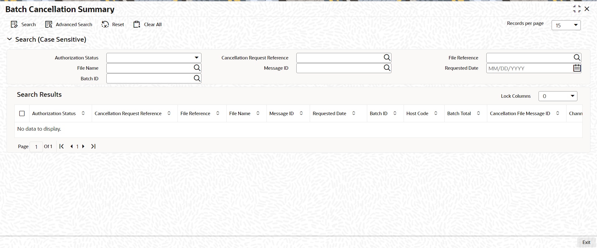

2.2.5.5 View Batch Cancellation Details
You can view all the cancelled transactions and its details for the batch, by clicking the ‘ View Batch Cancellation details’ action tab present in the screen.
Also, you can view the batch cancellations uploaded through pain.007 file in this screen.

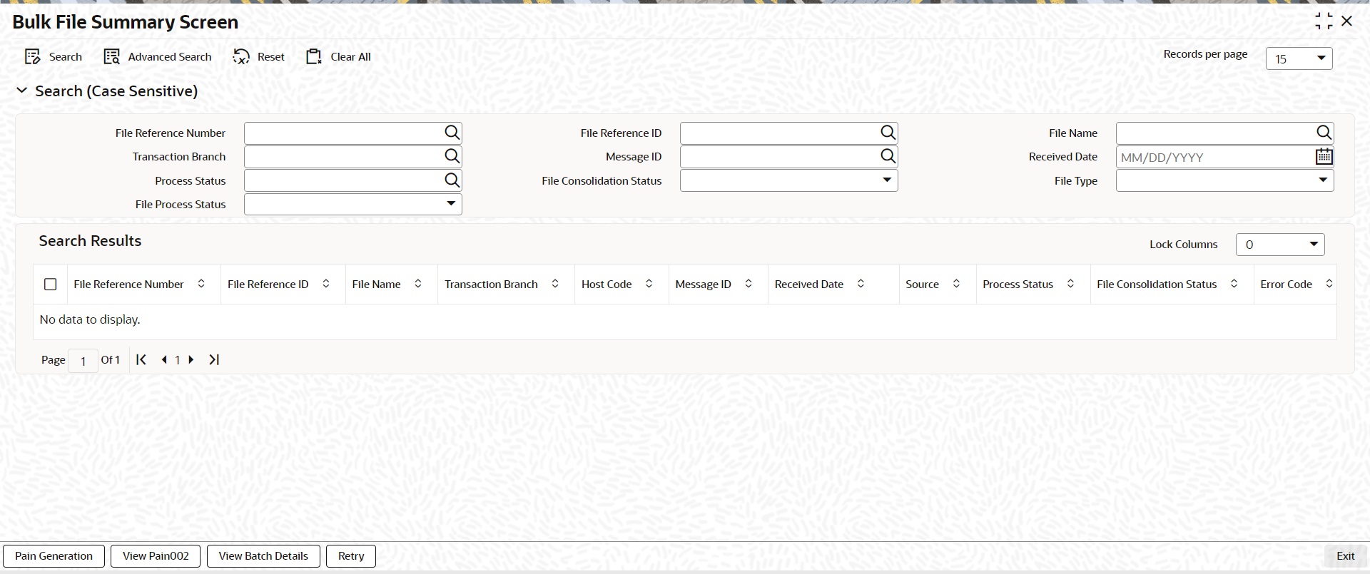

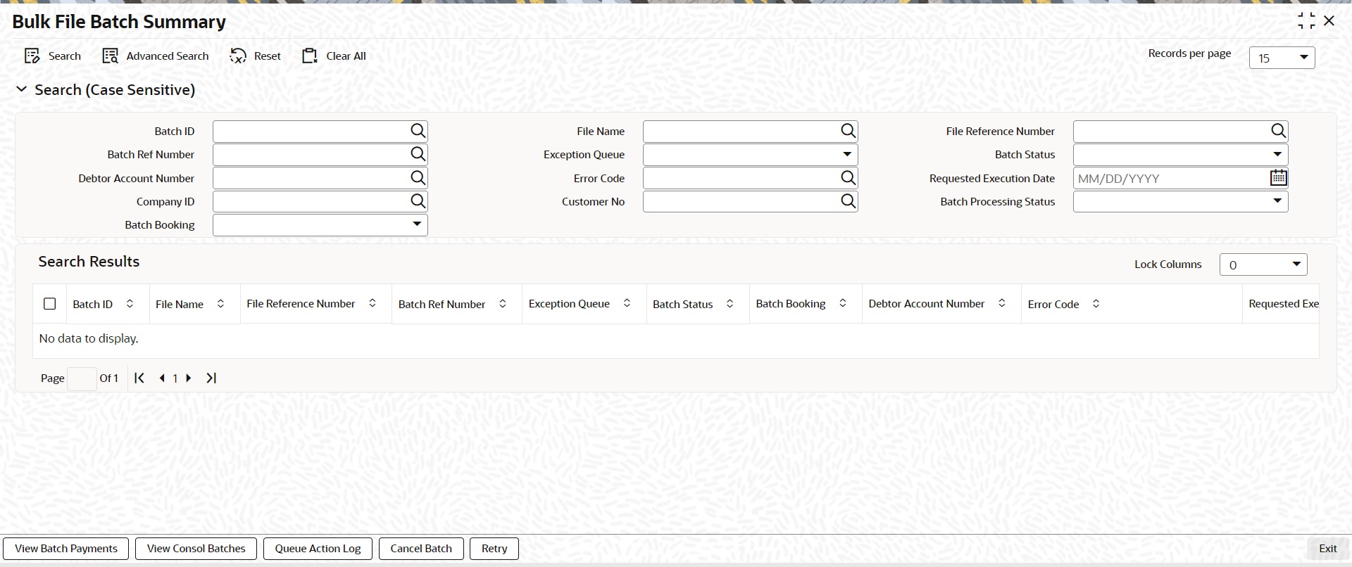

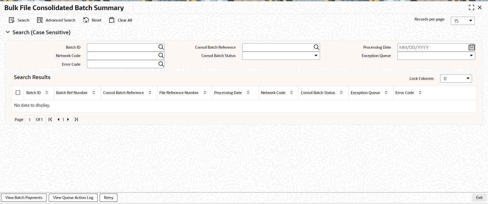

2.2.6 Bulk File Summary
You can view all the Batch Booking browser summary through this screen.
You can invoke ‘Bulk File Summary Screen‘ by typing ‘PMSBATBR’ in the field at the top right corner of the Application tool bar and clicking on the adjoining arrow button.
You can search for the records using one or more of the following parameters:
l File Reference ID
l File Name
l Message ID
l Received Date
l Process Status
l File Consolidation Status
l File Type
l File Process Status
Once you have specified the search parameters, click ‘Search’ button. The system displays the records that match the following search criteria.
Double click a record or select a record and click on Details button to view the detailed maintenance screen.
2.2.6.1 Pain Generation
You can manually generate pain.002 files for the records listed in Batch Booking Browser Summary screen by clicking the ‘Pain Generation’ button.
Generated file details are displayed here.
l Irrespective of the pain.002 generation level, i.e File level (L1), Batch +Transaction (L2) level or R-transaction (L3) level, auto generation of pain.002 is job based. A new job is provided which can be configured to run after regular host level batch cutoff so that the file level processing status can be sent to the customer.
l This is done on the date of file processing. If any R-transaction is initiated for one or more of the transactions which are part of the file , then too pain.002 message will be generated for the file.
l The pain.002 file is generated if the initiating party (if not available, debit account customer) has preferred for auto file generation.
l The file and batch level statuses are deduced while pain.002 message is generated.
2.2.6.2 View pain.002
You can view the pain.002 files generated both automatically and manually here by clicking the ‘View pain.002 button’.
pain.002 files that are generated automatically based on the preferences maintained in the Customer Preference Detailed screen (PMDFLPRF) can be viewed here.This is applicable only for L3 transactions.
And the files generated manually through Pain generation in Batch Booking Browser Summary screen (PMSBATBR) screen is also listed here.
System launches the ‘pain.002 Acknowledgement Browser’ screen on clicking the ‘View pain.002’ action button in PMSBATBR screen.
You can also invoke the ‘pain.002 Acknowledgement Browser‘ screen by typing ‘PMSACKBR’ in the field at the top right corner of the Application tool bar and clicking on the adjoining arrow button.
From the records listed, you can select a file and click on ‘Message’ action button to view the pain.002 message details.

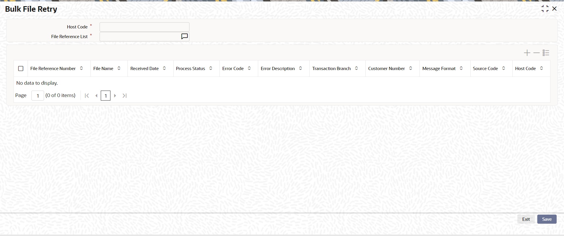

2.2.6.4 Retry
When you click Retry button “Bulk File Retry” sub-screen is launched to re-process error records.
2.2.7 Bulk File Batch Summary
You can invoke ‘Bulk File Batch Summary‘ screen by typing ‘PMSBATCH’ in the field at the top right corner of the Application tool bar and clicking on the adjoining arrow button.
l Batch ID
l Batch Ref Number
l Debtor Account Number
l Company ID
l Batch Booking
l File Name
l Exception Queue
l Error Code
l Customer No
l Batch Status
l Requested Execution Date
l Batch Processing Status
2.2.7.1 View Batch Payments
This button opens Bulk File Batch Payments Summary Screen (Function ID: PMSBTTXN). All the transaction records received for the selected Batch can be viewed.
A retry option is also available in Bulk File Batch Summary screen for retrying error records.
2.2.7.2 View Consol Batches
This button opens Bulk File Consolidated Batch Summary Screen (Function ID: PMSCONSL). All the consolidated batches for the selected Batch are displayed.
Note
Single Batch record only can be selected for viewing the Batch Payments and Consolidat­ed Batch details.
2.2.7.3 Queue Action Log
You can view all the queue actions for the selected batch by clicking the ‘Queue Action Log’ action tab present in the screen.
2.2.7.4 Cancel Batch
This action can be performed by any user having access rights to the Batch Cancellation screen (Function ID PMSBATCN). Batch cancellation screen is opened in Full Batch Cancellation mode defaulting the Batch details of the selected record.
System allows only single record to be selected for cancellation.
2.2.7.5 Retry
When you click Retry button “Bulk Batch Retry” sub-screen is launched to re-process error records.
2.2.8 Bulk File Consolidated Batch Summary
You can invoke ‘Bulk File Consolidated Batch Summary‘ screen by typing ‘PMSCONSL’ in the field at the top right corner of the Application tool bar and clicking on the adjoining arrow button.
l Batch ID
l Processing Date
l Consol Batch Status
l Error Code
l Consol Batch Reference
l Network Code
l Exception Queue
2.2.8.1 View Batch Payments
This button opens Bulk File Batch Payments Summary Screen (Function ID: PMSBTTXN). All the transaction records received for the selected Consolidated Batch can be viewed.
2.2.8.2 View Queue Action Log
2.2.8.3 Retry
When you click Retry button “Consolidated Batch Retry” sub-screen is launched to re-process error records..

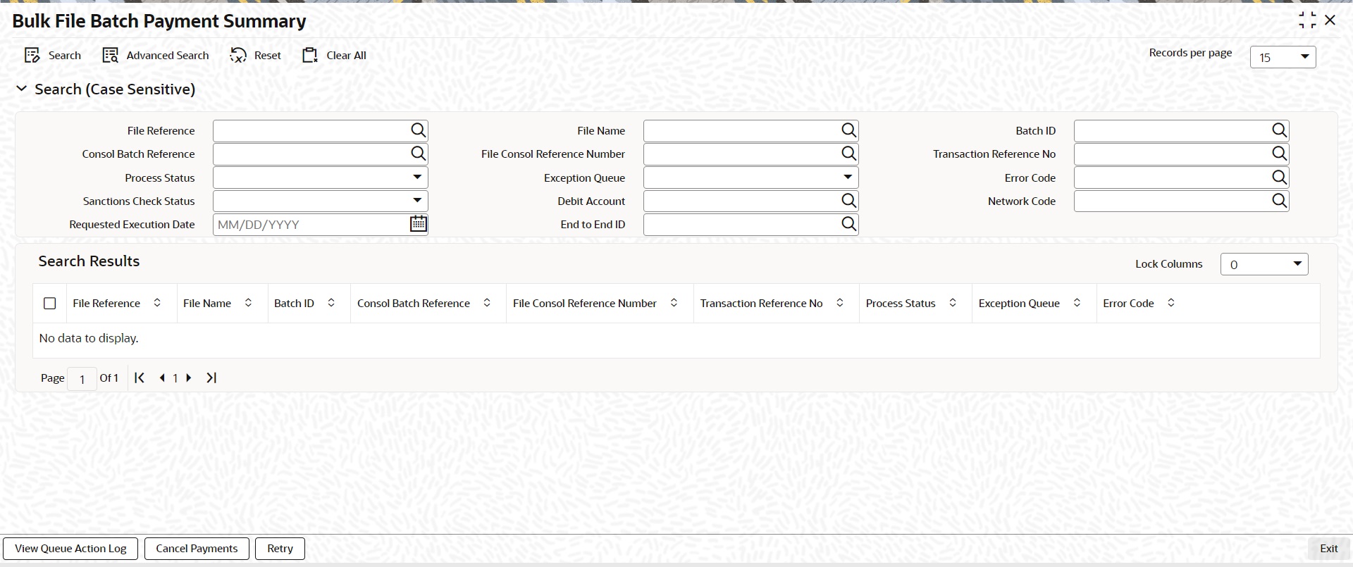

2.2.9 Batch File Batch Payment Summary
You can invoke ‘Batch File Batch Payment Summary‘ screen by typing ‘PMSBTTXN’ in the field at the top right corner of the Application tool bar and clicking on the adjoining arrow button.
l File Reference
l Process Status
l Sanctions Check Status
l File Name
l File Consol Reference Number
l Exception Queue
l Debit Account
l End to End ID
l Batch ID
l Transaction Reference No
l Error Code
l Network Code
2.2.9.1 View Queue Action Log
2.2.9.2 Cancel Payment
You can select single or multiple payment records for the same Batch and initiate 'Cancel Payments' action. This can be done if the user is having access right to the screen Batch Cancellation (Function ID: PMDBATCN). The Batch Cancellation screen is opened in 'Partial Batch' cancellation mode listing the transaction records selected.
Note
System displays an error if the transactions selected belong to different Batch IDs.

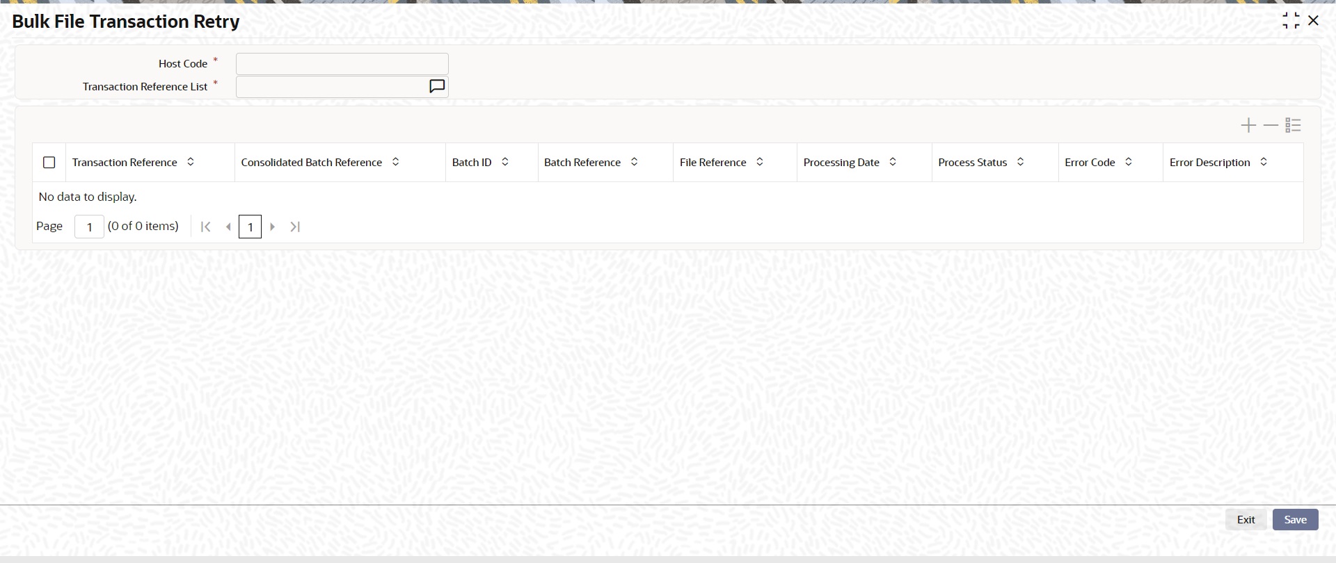

2.2.9.3 Retry
When you click Retry button “Bulk File Transaction Retry” sub-screen is launched to re-process file records.

2.4 Batch Cancellation
You can cancel the Batches received in pain.001 files, using this screen.
You can invoke ‘Batch Cancellation Detailed‘ screen by typing ‘PMDBATCN’ in the field at the top right corner of the Application tool bar and clicking on the adjoining arrow button. Click New button on the Application toolbar.
Host Code
System defaults the Host Code that is linked to the logged in branch.
Batch ID
Specify the Batch ID from the list of values.
Transaction Type
Select the Transaction Type between Cancellation and Reversal.
Allow Cancellation after Dispatch
Select the Allow Cancellation after Dispatch between Yes or No. This field is mandatory if transaction type is selected as 'Cancellation'. If the Network does not allow cancellation, the field is defaulted as 'No' and disabled.
If Network allows cancellation, this field value is defaulted as 'Yes'. You can modify the option to 'No', if required, for not processing the cancellation if the dispatch is over.
Note
This field is applicable for ACH CT transactions only.
Cancellation Request Reference
System generated Reference Number for the Cancellation Request received.
Requested Date
System defaults the Requested Date as Current Date.
Cancellation File Message ID
If the Cancellation type is 'File', the Message ID of pain.007 file is populated in this screen.
Cancellation Type
Select the Cancellation Type between the values 'Full Batch' or 'Partial Batch'.
Cancellation Reason
Reason Code
Specify a valid Reason Code for Batch cancellation from the list of values available.
Reason Description
System defaults the Reason Description for the Reason Code selected.
Reason Proprietary
You can specify free text in this field upto 35 characters.
On the selection of Batch ID field, below fields are populated:
l Original File Details: File Name, File Reference, Message ID, File Received Date
l Customer and Account Details: Customer Number, Company ID, Customer Account, Customer Account Name
l Batch Details: Batch Total, Number of Transactions, Requested Execution/Collection Date
Partial Batch Cancellation Transaction Details
System validates that no other cancellation request record is pending for authorization for the same file upon saving the details.Also the following validations are done upon Saving.
l Transaction Reference Number
l Transaction Cancellation Reference
l End to End ID
l Transaction Status
l Network Code
l Counterparty Account
l Counterparty Name
l Transfer Currency
l Transaction Amount
l Cancellation Request Status
l Error Code
Note
Batch Cancellation Changes are same for the batches uploaded from pain.008 for ACH DD.
Cancel actions performed from Batch cancellation screen are displayed in Cancellation details of Transaction view screen for Book Transfer and generic ACH CT.

Check whether batch cancellation request received. If yes, mark the batch and the related payment records as cancelled.
When successful transactions of a  carried forward batch is sent for value date processing
Check whether batch cancellation request received. If yes, mark the batch and related payment records as cancelled. Requests for FX & ECA unwind will be sent.
When Urgent payment processing (individual)completed each stage or is released from an exception queue
Check whether batch cancellation request received. If yes, mark each transaction record as cancelled. Requests for FX & ECA unwind will be sent transaction-wise, if already done.
Transaction processing is completed with dispatch for a batch/consol batch
Cancellation will not be applicable
2.4.2 Batch Cancellation Summary
You can view all the Batch Cancellation summary through this screen.
You can invoke ‘Batch Cancellation Summary‘ screen by typing ‘PMSBATCN’ in the field at the top right corner of the Application tool bar and clicking on the adjoining arrow button.Click new button on the Application toolbar.
l Cancellation Request Reference
l File Reference
l File Name
l Message ID
l Requested Date
l Batch ID
