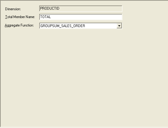

Select the dimension whose properties you want to define.
This is an example of the dimension properties.
Field or Control |
Description |
Total Member Name |
This field performs different functions depending upon whether you have entered a value into the Total Member Name field, whether the dimension belongs to an analytic model that was converted from a BAM 8.8 model, and whether a tree is attached to the dimension. |
Aggregate Function |
Select a dimension override function to calculate the dimension's aggregate fields. The analytic calculation engine uses this aggregate function to calculate all of a dimension's aggregates. Note: This aggregate function does not apply to leaf members or detail members. See Understanding Override Order of Precedence, Example: Creating a Hierarchy with Mixed Aggregate and Detail Members. |
