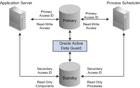

The following diagram depicts how Oracle Active Data Guard enables you to incorporate the use of a standby database for you to offload designated read-only transactions, freeing up more resources to handle the read-write transactions on your primary (production) database.
Note: This documentation uses the acronyms RO to refer to "read-only" and MRO to refer to "mostly-read-only."
The following table describes the elements within the diagram:
Element |
Description |
Primary Database |
Your production database, handling the read-write requests of your transactional system. For example, this database fills orders, updates employee information, adds new product offerings, and so on. |
Standby Database |
Your clone of the primary database designed to handle read-only, or mostly-read-only (MRO), requests so that those transactions can be offloaded from your primary database, conserving resources on the production system. Examples of MRO requests include, PSQUERY Viewer, Tree Viewer, components that only submit SELECT SQL to display lists of employees, products, and so on. |
Oracle Active Data Guard |
Synchronizes the data stored in the primary and standby databases so that they remain exact duplicates. This is achieved using a combination of Oracle Active Data Guard features and DBLINKS and Remote Synonyms defined by scripts delivered with PeopleTools. |
Primary Access ID |
The PeopleSoft access ID used for connecting to the primary, production database. |
Secondary Access ID |
The alternative PeopleSoft database user (access ID), which will be used for connecting to the standby database and subsequently accessing the primary database’s tables using LOCAL and REMOTE synonyms. |
