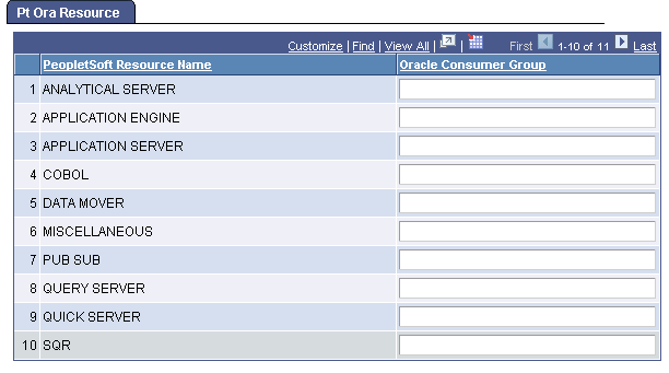

The Pt Ora Resource page enables you to map PeopleSoft resource groups with the Oracle consumer groups you have defined.
Select to access the Pt Ora Resource page.
This example illustrates the fields and controls on the Pt Ora Resource page.
| Field or Control | Description |
| PeopleSoft Resource Name | PeopleTools provides predefined PeopleSoft resource groups containing one or more PeopleTools executables. The entire set of delivered PeopleSoft resource groups appears in this list. |
| Oracle Consumer Group | After you have created the appropriate Oracle resource plan and consumer groups to correspond to the PeopleSoft resource groups, enter the name of the appropriate Oracle resource group in the edit box. Enter the consumer group name exactly as it appears in the SQL you submitted to create it. For example, if the SQL you used to create the consumer group appeared as: Then, in the Oracle Consumer Group edit box, enter PSQuery. |
