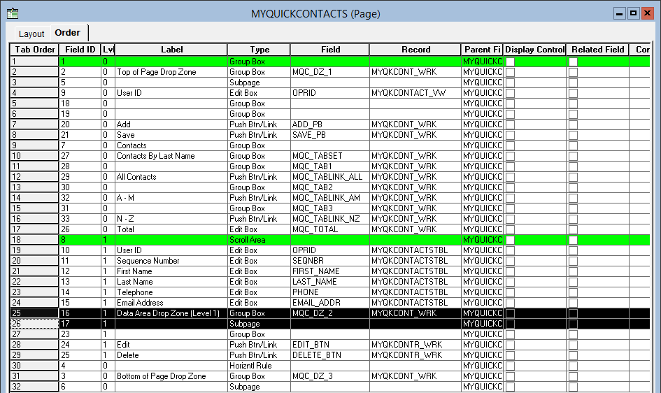

Associate a record field to this drop zone to ensure that it has a unique page field identifier.

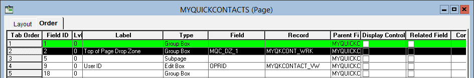

Insert the PeopleTools-defined PT_ERCSUBPAGE_STUB subpage stub into the related content group box:
On fluid pages, the upper left corner of the subpage must be located within the group box. On classic pages, the entire subpage must be located inside the boundaries of the group box.
In this example, the PT_ERCSUBPAGE_STUB subpage is located within the drop zone group box in a manner that satisfies both fluid and classic requirements on placement.
The subpage must be listed immediately after the group box on the Order tab for the page definition.
In this example, the PT_ERCSUBPAGE_STUB subpage immediately follows the Data Area Drop Zone (Level 1) group box on the Order tab.
Important! If you insert multiple drop zones on the same page, always inspect and fix the order of group boxes and subpages on the Order tab.

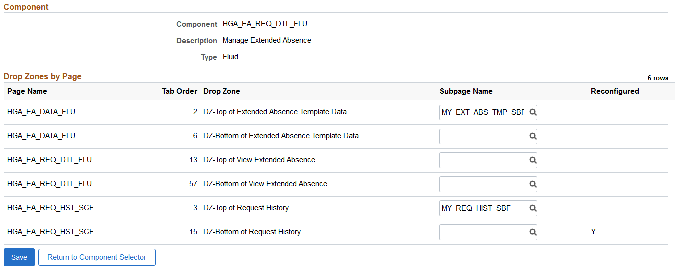

Use the Configure Drop Zones pages to search for, select, and configure components containing configurable drop zones, including unregistered components.
Navigation:
This example illustrates the fields and controls on the Configure Drop Zones search page. You can find definitions for the fields and controls later on this page.
You must enter one or more search criteria to perform a search using this page. You may use % as a wildcard.

Important! Search results may include components that cannot be configured because no drop zones are available in the component. Clicking such a component in the list will display a message that no drop zones are available.
In the search results, click a row to configure the available drop zones for that component.
This example illustrates the fields and controls on the Configure Drop Zones configuration page. You can find definitions for the fields and controls later on this page.
Field or Control |
Description |
Page Name |
Displays the name of the main page that contains a drop zone or that contains a subpage with a drop zone, or it displays the name of a secondary page that contains a drop zone. Note: Subpage names are not displayed in the grid; only the name of the main page that contains the subpage or nested subpage is displayed. Note: If you are attempting to configure a secondary page and that page does not appear on the list for this component, then the link to this secondary page is missing—that is, there is no secondary page control on the main page or subpage that launches the secondary page. Since modifying the main page or subpage yourself would be considered a customization, contact support to determine whether a bug should be logged. |
Tab Order |
Displays the tab order number for the drop zone from the Order tab of the page definition (page or subpage) where the drop zone group box is physically defined. |
Drop Zone |
Displays the label for the drop zone, which is derived from these values in descending order of precedence:
Important! If the label of a field other than the drop zone group box is displayed, then the PT_ERCSUBPAGE_STUB subpage is positioned incorrectly on the page definition. In particular, check the Order tab. Since modifying the main page or subpage yourself would be considered a customization, contact support to determine whether a bug should be logged. |
Used By Related Content |
(Fluid only) Indicates that this drop zone has been configured for fluid embedded related content. Reconfiguring it with a subpage overrides the embedded related content configuration. |
Subpage Name |
Select a subpage to associate with the drop zone. Note: Because fluid drop zones can be associated with fluid subpages only and classic drop zones can be associated with classic subpages only, the search results are filtered to show valid subpages only, and not all subpages. To remove a subpage configuration, clear the Subpage Name field and save your changes. |
Reconfigured |
Indicates that an existing subpage configuration has been changed. Note: This indicator is displayed only after you save your changes. It is not displayed if you return to reconfigure drop zones for this component. |
Add to Project |
Click the Add to Project button to access the Add To Project page to insert one or more drop zone configurations for this component into an ADS project. See Adding Data Set Instances from Object Designer Pages for more information. |
