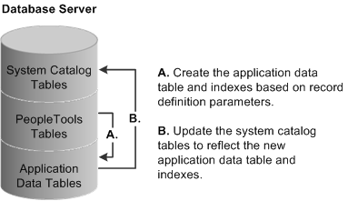

The Create Table process is illustrated by the following diagram:
The following diagram illustrates the process of Create Table that creates a new application table based on the parameters defined in the record definition
After you create an updated SQL build script and run it, the PeopleTools tables and the system catalog tables are synchronized; and the record definition and the application data table are synchronized. The following table lists the steps of the Create Table process and the associated record definition parameters:

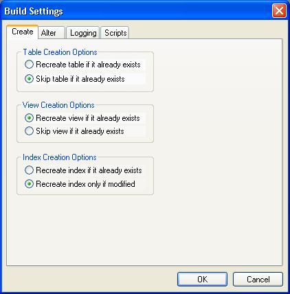

Access the Build Settings dialog box and select the Create tab.
This example illustrates the fields and controls on the Build Settings dialog box: Create tab. You can find definitions for the fields and controls later on this page.
            Table Creation Options
These options determine when a table should and should not be created.
Field or Control  |
Description  |
Recreate table if it already exists  |
 Select to drop and recreate a table if it already exists. Select this option with extreme care because if data already resides in the table, it is also dropped. If you select this option, the Build process prompts you to confirm your intention before performing any destructive action. If you do not care about losing the data that resides in the table, then this option is faster than the Alter Tables option.  |
Skip table if it already exists  |
 Select to create only newly defined tables. If you want to preserve the data that already resides in existing tables or if you are only interested in creating the tables that do not already exist, select this option.  |
View Creation Options
Similar settings are available for creating views that you use for creating tables.
Field or Control  |
Description  |
Recreate view if it already exists  |
 Because views are only logical views of data, you can safely select this option; you do not run the risk of losing physical data. Using this option ensures that all views in the project are rebuilt, whether they need to be or not.  |
Skip view if it already exists  |
 If you are concerned only with creating views that do not already exist in the database, select this option. This option is useful if you want to run Build Project on a large project and only a subset of the views in the project must be created. This option consumes less time than recreating all of the views in the project.  |
Index Creation Options
These options determine when an index should be recreated.
Field or Control  |
Description  |
Recreate index if it already exists  |
 Select to recreate the index for your tables, even if you already have one in place. This option recreates the index no matter what the situation.  |
Recreate index only if modified  |
 Select to recreate the index only if the data in the indexes is being modified.  |

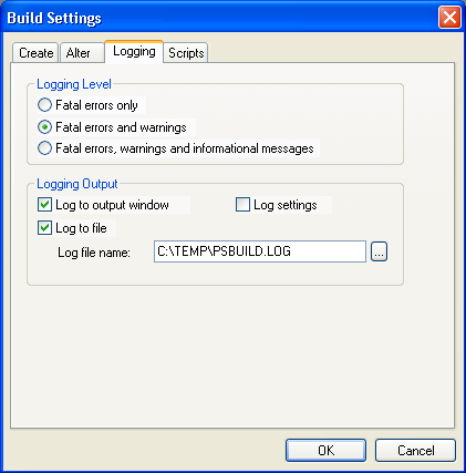

Access the Build Settings dialog box and select the Logging tab.
This example illustrates the fields and controls on the Build Settings dialog box: Logging tab. You can find definitions for the fields and controls later on this page.
            Logging Level
Specify the level of detail of information that you want in your Build log output.
Field or Control  |
Description  |
Fatal errors only  |
 Select this option if you want to see only the operations that failed.  |
Fatal errors and warnings  |
 Select this option to add warnings to the fatal errors.  |
Fatal errors, warnings and informational messages  |
 Select this option to see all the definitions that processed successfully and all of the errors and warnings.  |
Note: These options are personal preferences and do not affect the actual build of your SQL tables, but they might help you track down potential failures. For example, if you are processing a large number of definitions, you will want to see only the operations that failed. Whereas, if you are processing a small number of definitions, you will want to see all of the successful operations, too.
Logging Output
Specify where and in what form you want to view your log output.
Field or Control  |
Description  |
Log to output window  |
 Select to write the same information that appears in the log file to the PeopleSoft Application Designer output window. Always be aware of the level that you select. If you expect a lot of detail (high logging level plus many records to process), you may want to copy the logging information to a file and print it later.  |
Log to file  |
 Select to write the log to a file. If you select this check box, you can specify a location and name for your log file in the Log file name edit box. To search for a name, click the Browse button. Select a .LOG type file from the Build File Selection dialog box. If you do not select this check box, the edit box is unavailable for entry.  |
Log settings  |
 Select to write all of the runtime options to the log. If you select this check box, you do not need to rerun a test when you have a problem. If you must report a problem with the Build process or troubleshoot, you need to know the settings that were active.  |
Note: You should select the Log to file check box and the Log to output window check box with a minimum logging level of fatal errors and warnings. In case you run into a problem, you already have the information you need to research the problem. Otherwise, you must run the process again with a higher logging level.
Example Log Results
The following are samples of the type of information that you can expect to see in your log output that corresponds to the selections that you make on the Logging tab:
Fatal errors:
SQL Build process began on 7/30/2003 at 8:46:46 PM for database OM51U20 Error: BI_BILL_BY_F_VW - Unable to retrieve current DDL space name. Alter processed failed. (76,47) Error: BI_CHARGE_VW - Unable to retrieve current DDL space name. Alter processed failed. (76,47) Error: PS_BI_CYCLE_VW - alter failed due to an unknown column type (UNDEFINED) found for field BILL_CYCLE_ID. (76,22) Error: PS_BI_IVCLAYOUT_VW - alter failed due to an unknown column type (UNDEFINED) found for field INVOICE_LAYOUT_ID. (76,22) Error: CARINA - alter failed because SQL table does not exist. (76,7) SQL Build process ended on 7/30/2003 at 8:54:34 PM. 2487 records processed, 11 errors, 0 warnings SQL Build script for all processes written to file C:\TEMP\step38.SQL. SQL Build log file written to C:\TEMP\step38.LOGWarnings:
SQL Build process began on 8/27/2003 at 4:00:32 PM for database DXD7L Warning: ABSENCE_HIST2 - data would be truncated by altering REASON. Record processed. (76,24)Fatal errors, warnings, and informational messages:
SQL Build process began on 8/27/2003 at 3:58:58 PM for database DXD7L Warning: ABSENCE_HIST2 - data would be truncated by altering REASON. Record processed. (76,24) Error: ABSENCE_HIST2 - field PAID_UNPAID to be deleted has data present. Record skipped. (76,23) Informational: ACCOMPLISHMT_VW - view created and scripted successfully. (76,18) Informational: ACCT_AD2_INV_VW - view created and scripted successfully. (76,18) Informational: ACCT_ADJ_INV_VW - view created and scripted successfully. (76,18) Informational: ACCT_ISS_INV_VW - view created and scripted successfully. (76,18) Informational: ACCT_STK_INV_VW - view created and scripted successfully. (76,18) Informational: ACCT_TYPE_VW - view created and scripted successfully. (76,18) Informational: ACTION_SP_VW - view created and scripted successfully. (76,18) Informational: ACTION_XLAT_VW - view created and scripted successfully. (76,18) Informational: ADJUST_INV2_VW - view created and scripted successfully. (76,18) Informational: ADJUST_INV_VW - view created and scripted successfully. (76,18) 11 records processed, 1 errors, 1 warnings SQL Build script for all processes written to file C:\TEMP\PSBUILD.SQL. SQL executed online. SQL Build log file written to C:\TEMP\PSBLD.logLog settings:
**** Begin Build Settings for this Run Create Tables = No Create Indexes = Yes Create Views = No Create Triggers = Yes Alter Tables = Yes Log to File = Yes Log to Window = Yes Write comments to script = No Always overwrite files = Yes Execute SQL Now = No Write SQL to script file = Yes Logging level = Log fatal errors, warnings and informational messages Table creation option = Skip table if it exists View creation option = Drop and recreate view if it exists IndexCreationOption = Drop and recreate index always Alter Adds = Yes Alter Changes = Yes Alter Renames = Yes Alter Deletes = Yes Alter even if no changes = No Alter Table Option = Alter by Table Rename Write script output to: Single file Log filename = c:\temp\PSBUILD.LOG Single script filename = c:\temp\PSBUILD.SQL Alter drop column option = skip record if data present Alter truncate column option = skip record if data would be truncated Target database platform = MICROSFT Target sizing set = 0

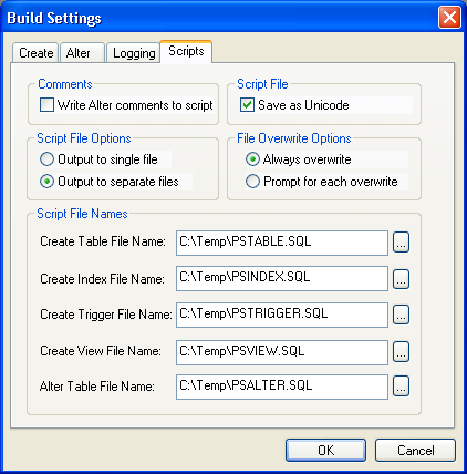

Access the Build Settings dialog box and select the Scripts tab.
This example illustrates the fields and controls on the Build Settings dialog box: Scripts tab. You can find definitions for the fields and controls later on this page.
            Comments
The Write Alter comments to script check box enables you to either include or suppress alter comments. The following example displays the types of comments that you see in your PSALTER.SQL script if you enable this option:
-- Alters for record PS_AE_RUN_CONTROL ;
--           AE_THREAD - change ;
--               OPRID - change ;
-- Start the Transaction ;
-- Data Conversion ;
-- Drop Old Indexes ;
DROP INDEX SYSADM.PS_AE_RUN_CONTROL
-- Add Columns ;
ALTER TABLE PS_AE_RUN_CONTROL ADD Z_TMP_ALTER_1 DECIMAL(12,4)
ALTER TABLE PS_AE_RUN_CONTROL ADD Z_TMP_ALTER_2 CHAR(12)
UPDATE PS_AE_RUN_CONTROL SET
    Z_TMP_ALTER_1 = AE_THREAD,
    Z_TMP_ALTER_2 = OPRID
If you do not view the alter comments, the script containing the same commands as the previous script looks like this:
Script File
The default for the Save as Unicode check box is based on the UNICODE/ANSI database. This check box is available when using Oracle, Microsoft SQL Server, and Db2 for z/OS databases.
The following table lists the default settings for the Save as Unicode check box:
 Database Type  |
 Default for Save as Unicode Check Box  |
 Unicode  |
 Selected  |
 ANSI  |
 Unavailable  |
The script file option, Save as Unicode, is stored in the registry with the other build settings. Therefore, the previous setting is always the default every time that the dialog box is opened.
The type of script file that is generated during the Build process is based on the Save as Unicode check box setting for the UNICODE/ANSI build and UNICODE/ANSI database. This table lists details:
 Database Platform  |
 Unicode  |
 ANSI  |
 SQL Server  |
 UCS2  |
 ANSI  |
 Oracle  |
 UTF8  |
 ANSI  |
 Db2 for z/OS  |
 UTF8  |
 ANSI  |
Script File Options
If you want all of your CREATE TABLE statements to be written to one SQL script file and your CREATE INDEX statements to another, then select the Output to separate files option. If you prefer to have all of your statements, CREATE, ALTER, and so on, contained in a single file, then select the Output to single file option.
Note: Script files can be quite large. To reduce the size of files so that they are easier to manage, select the Output to separate files option. Also, the system never appends script files; it overwrites them or you can terminate the process if you elected to be prompted before a build script file is overwritten.
Depending on which output option you select, the options in the Script File Names group box change to suit one file or multiple files.
File Overwrite Options
These options indicate whether you want to overwrite automatically or be prompted before script files are overwritten. Your personal preference determines which technique you employ.
Field or Control  |
Description  |
Always overwrite  |
 Select to overwrite your previous build scripts.  |
Prompt for each overwrite  |
 Select to be alerted when a script is about to be overwritten. To avoid the possibility of overwriting files altogether, you can use a naming convention that, in itself, prevents any overwrites. For example, you could specify a unique name for each build script, as shown:
Script File Names
The options available to select in this group box depend on your selection in the Script File Options group box.
Field or Control  |
Description  |
Output to single file  |
 When you select this option, an edit box appears in the Script File Names group box: All Output File Name. The default name for the generated script is PSBUILD.SQL. Note: Script files can be quite large. To reduce the size of files so that they are easier to manage, select the Output to separate files option. Also, the system never appends script files; it overwrites them or you can terminate the process if you elected to be prompted before a build script file is overwritten.  |
Output to separate files  |
 If you select this option, the following edit boxes appear, one for each build option:
This example illustrates the fields and controls on the Output to separate files. You can find definitions for the fields and controls later on this page.
