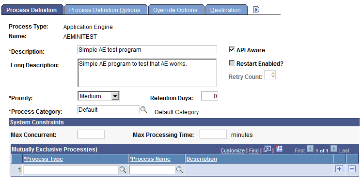

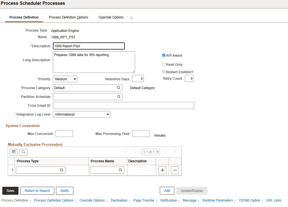

Select to access the Processes - Process Definition page.
This example illustrates the fields and controls on the Processes - Process Definition page.
To use PeopleSoft Process Scheduler for starting Application Engine batch programs, create a process definition for each program. Running Application Engine programs is similar to running any COBOL or Structured Query Report (SQR) program that you typically invoke with PeopleSoft Process Scheduler. Use Application Engine as the generic process type definition. Each Application Engine program that you invoke using PeopleSoft Process Scheduler requires a unique process definition derived from the generic process type definition.
Note: When creating a process definition based on the Application Engine process type definition, the process name you assign must match your Application Engine program name exactly.

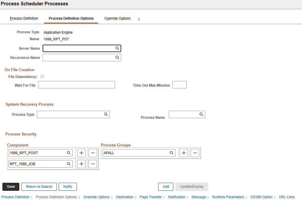

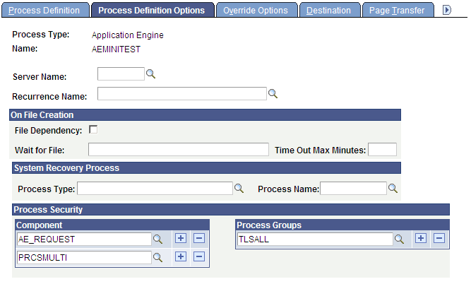

Select to access the Processes - Process Definition Options page.
This screenshot shows the Processes - Process Definition Options page.
Use this page to list parameters. The complete parameter list is:
-ct %%DBTYPE%%
-cd %%DBNAME%%
-co %%OPRID%%
-cp %%OPRPSWD%%
-r %%RUNCNTLID%%
-i %%INSTANCE%%
-ai %%PRCSNAME%

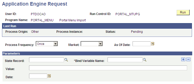

Application Engine Requests
Select to access the Application Engine Request page.
This example illustrates the fields and controls on the Application Engine Request page. You can find definitions for the fields and controls later on this page.
Field or Control |
Description |
Process Origin |
Displays where the program was invoked, from PeopleSoft Process Scheduler, from the command line, and so on. |
Process Instance |
Displays the process instance assigned to the previous program run. |
Status |
Displays the status of the last program run, whether it is successful, pending, and so on. |
Process Frequency |
Specify how long a particular process request will remain active or valid:
As Of Date |
If you are requesting retroactive processing, specify the appropriate as of date. |
Bind Variable Name |
Enter the appropriate field or bind variable for which you are inserting a value. |
Value |
Enter the initial value that you want to set for the specified field. |
