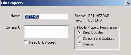

Property names are automatically generated according to the corresponding fields from the component. If these names are cryptic, you might want to rename these properties to explain them better. Renaming a property does not change the field that the property references.
This example shows the Edit Property dialog box. Use this dialog box to rename user-defined properties for component interfaces.
Important! PeopleSoft Mobile Agent is a desupported product. The options listed in the Mobile Property Persistence group box of the Edit Property dialog box exist for backward compatibility only.
To rename a property:
Double-click the property name or right-click the property name and select Edit Name from the menu.
Enter the new property name.
Programs accessing this component interface must reference the new property name. For example, if SDK_NAME was changed to NAME, programs must use NAME instead of SDK_NAME.
Add any comments that might be helpful.
Select the Read-Only check box to make this property read-only.
If this property is for a mobile application, select a radio button that sets the persistence of the property.
Send Updates is the default behavior for a mobile property.
Any changes or additions to this property on a mobile instance are synchronized to the server.
If a mobile property is set to Do not Send Updates, this property is not synchronized up to the server, but the value is maintained on the device.

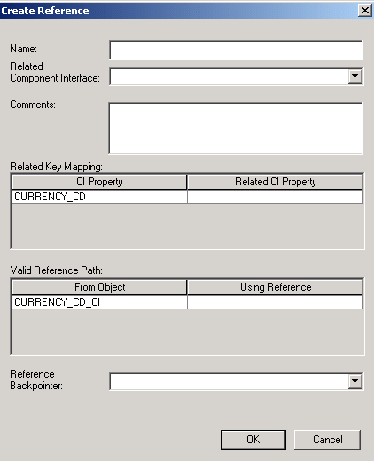

Each component interface is isolated and unaware of the other component interfaces in the system. To access and update information from other component interfaces, references establish relationships between component interfaces.
Create a reference property in one component interface to access data exposed in another component interface. For example, the Customer object and the component interface exposing its properties include properties such as the customer’s name, address, and telephone numbers. Another object, Contact, includes data associated with all contacts in the system. The link between a specific customer and its associated contacts is owned by the Contact record, not the Customer record.
Therefore, to access contact data, the Customer component interface needs a reference property referring to the Contact component interface. For you to update contact data from the Customer component interface, the reference must include a valid reference path and reference backpointer to the customer ID.
Access the Create Reference dialog box by right-clicking the property and selecting Create Reference.
This example illustrates the fields and controls on the Create Reference dialog box. You can find definitions for the fields and controls later on this page.
The Create Reference dialog box has the following fields:
Field or Control |
Description |
Name |
Describes the name of the reference you are creating. |
Related Component Interface |
Designates the component interface referenced from the current component interface. |
Comments |
Enter any comments to track the reference. |
Related Key Mapping |
Maps the property from the related component interface to the selected component interface property. |
Valid Reference Path |
Supports dynamic enumeration of the objects that can be selected as the value of the reference property being defined. This effectively filters these values so that you can select only objects that support the defined reference. Because references use the concept of a walkpath to go from level zero of one component interface to level zero of another component interface, and then “walk” down to the lower levels of the component interface, only the level zero references are displayed in the Valid Reference Path drop-down list of a reference definition. |
Reference Backpointer |
Refers to the path back to the original component interface. |
You can make any property read-only. At runtime, the value of a read-only property can be read but not updated.
To make a property read-only:
Select the property.
Select from the PeopleSoft Application Designer menu.
A Y appears in the Read Only column of the component interface view corresponding to each property that you selected to be read-only.
Note: You can double-click the icon of any existing user-defined property to edit its name or comment or to toggle read-only access.
