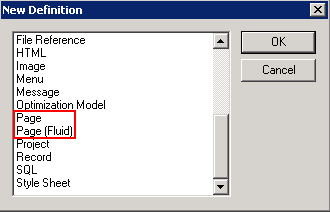

When creating a new fluid page or opening an existing fluid page, you can select Page (Fluid) from the definition list in Application Designer.
The following example shows the Page and Page (Fluid) definition types in the definition list in Application Designer.

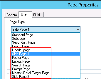

You select the remaining page types for fluid mode, from the Page Type drop-down list on the Use tab of the Page Properties dialog.
This example shows the fluid page types listed in the Page Type drop-down list on the Page Properties, Use tab.

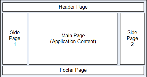

The following diagram illustrates the general layout of the various fluid page types.
Note: Not all page types are required to be used. The application content area displays the content presented by the main fluid page.
