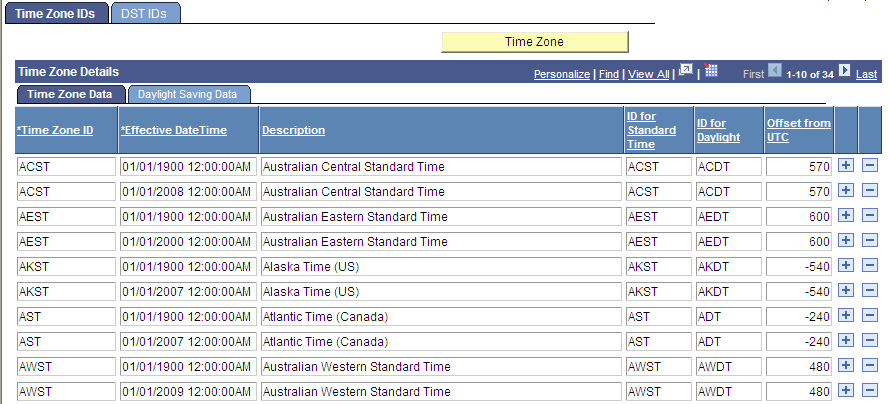

Access the Time Zone IDs page ().
This example illustrates the fields and controls on the Time Zone IDs page: Time Zone Data tab. You can find definitions for the fields and controls later on this page.
Time Zone Data Tab
Field or Control |
Description |
Time Zone ID |
Displays the name (or ID) for the time zone. |
Effective DateTime |
Displays the effective date and time for each time zone definition. |
Description |
Displays the description for the time zone ID. |
ID for Standard Time |
Displays the name for the time zone during standard time. |
ID for DST |
Displays the name for the time zone during daylight saving time. |
Offset from UTC |
Displays the number of minutes the time is offset from universal coordinated time (UTC, sometimes known as Greenwich mean time or GMT). A positive offset indicates a time zone east of UTC; a negative offset indicates a time zone west of UTC. For example, the time zone for India, which is 5 and a half hours east of UTC, has an offset of +330. U.S. pacific standard time (PST), which is 8 hours west of UTC, has an offset of -480. Note: There are two business use cases of GMT. GMT as used in the UK is synonymous with WET. It does observe DST, when the label is BST during summer time. GMT as used internationally is synonymous with UTC. It does not observe DST, and does not change the label. |
Generate Query Offsets |
Click to access the open the Time Zone Offset Generation page. On this page, you can use the information from the Time Zone IDs page to populate the PSTZOFFSET table with offsets for all the time zones and their daylight saving time periods for a specified period of time. This makes the time zone information available in a format that can be easily accessed with SQL. This may be useful for PeopleSoft Query. The PeopleSoft system does not require that you populate this table; you need to do so only if you require access to this information. If you do use the information, regenerate the offsets anytime the underlying time zone data is changed. |

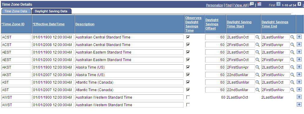

Daylight Saving Data Tab
Select the Daylight Saving Data tab to view daylight saving offset information and the IDs specified for daylight saving time start and daylight saving time end.
Note: When a timezone discontinues observing DST, special handling is required. This statement will audit for issues related to this type of change.
select count(*),timezone from (select distinct timezone,observedst from pstimezonedefn) group by timezone having count(*) > 1;
Any rows that are returned have both Y and N defined, which can cause issues when generating query offsets.
In this case, all rows OBSERVEDST should be Y, and timezones which have discontinued DST should have a DSTOFFSET of 0, and should have TIMEZONEDST label matching TIMEZONESTD label.
This example illustrates the fields and controls on the Time Zone IDs page: Daylight Saving Data tab. You can find definitions for the fields and controls later on this page.
Field or Control |
Description |
Observes DST |
Indicates whether the time zone observes daylight saving times. If this check box is cleared, the other DST values have no effect. |
DST Offset |
Displays the number of minutes by which the time is offset during daylight saving time. |
DST Start ID |
Displays the ID for when daylight saving time begins. This field prompts against values from the PSDSTTIME table (the DST IDs page). |
DST End ID |
Displays the ID for when daylight saving time ends. This field prompts against values from the PSDSTTIME table (the DST IDs page). |

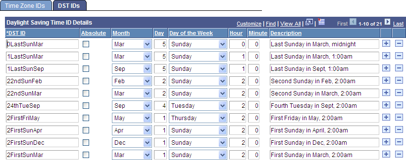

Access the DST IDs page ().
This example illustrates the fields and controls on the DST IDs page. You can find definitions for the fields and controls later on this page.
Field or Control |
Description |
DST ID |
Displays a unique identifier for the combination of date and daylight saving start time. For example, 22ndSunFeb represents the second Sunday in February at 2:00 am. |
Absolute |
Clear this check box to indicate a relative date, such as the last Sunday in October. |
Month |
Displays the month. |
Day |
For absolute dates, displays the day of the month. For relative dates, the numbers 1, 2, 3, and 4 represent the first, second, third, and fourth occurrence of the day of the week—for example, to describe the second Sunday in February, enter 2. Use the number 5 for a relative date to indicate the last occurrence of the specified day of the week, even if that day of the week occurs only four times in the month. |
Hour |
Displays the hour at which the time switch occurs. |
Minute |
Displays the minute at which the time switch occurs. |
Description |
Provides a description of the DST ID. |

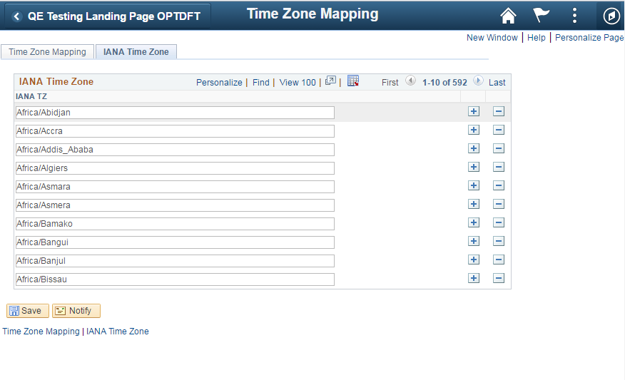

Access the Time Zone Mapping page ().
PeopleSoft has a mapping table to the industry standard IANA time zone IDs that is managed from the Time Zone Mapping page.
This example illustrates the fields and controls on the Time Zone Mapping Tab in the Time Zone Mapping Page. You can find definitions for the fields and controls later on this page.
Term |
Definition |
IANA TZ |
IANA TZ: Specify the IANA time zone in the format from the tzdata file. This value should match the IANA time zone detected by the JVM running on the application server or process scheduler server. Note: The IANA time zone is listed in the server logs as Detected IANA timezone. |
Time Zone |
Specify the PeopleSoft time zone ID this IANA time zone maps to. |
Default |
Set this to indicate that this is the default for reverse mapping from PeopleSoft time zone ID to IANA time zone ID. This reverse mapping is used in XMLP. See Using Time Zones in BI Publisher Reports |
This example illustrates the fields and controls on the IANA Time Zone Tab in the Time Zone Mapping Page. You can find definitions for the fields and controls later on this page.
Term |
Definition |
IANA Time Zone |
The time zone listed in tzdata. When the application server or process scheduler starts, it will be running in one of these time zones. These are the lookup values for the Time Zone Mapping page. |
Base Time Zone and Server Time Zone
The base time zone, database server time zone, and application server time zone should all match. This is the reference time zone where all data is stored. The process scheduler time zone can be set to a time zone which is often the same as the base time zone, but can also be set to any local time zone.
When the application server and process scheduler server start up, they map the IANA time zone, as reported by the JVM, to a PeopleSoft time zone ID. This mapping is used by the Query Export to Excel function, and the reverse mapping is used by XMLP.
