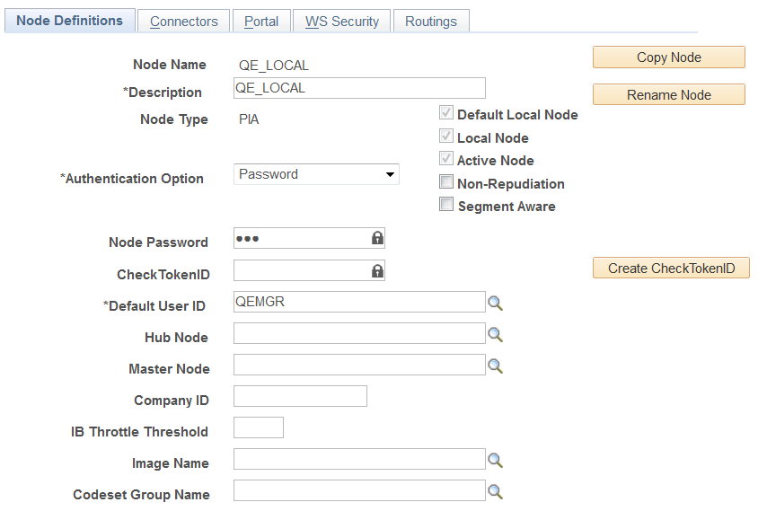

Access the Node Definitions page (PeopleTools > Integration Broker > Integration Setup > Node Definitions.)
This example illustrates the fields and controls on the Nodes - Node Definitions page for the default local node. You can find definitions for the fields and controls later on this page.
Nodes - Node Definitions page (Default local node)
The previous example shows the node definition for the node QE_LOCAL, the default local node.

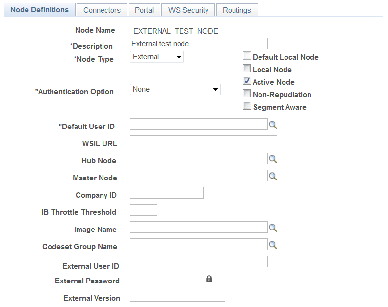

When the definition is for an External type node, additional fields appear on the page.
This example illustrates the fields and controls on the Nodes - Node Definitions page for an external node. You can find definitions for the fields and controls later on this page.
Nodes - Node Definitions page (External node)
The previous example shows the node definition for the node EXTERNAL_TEST_NODE, an External type node.
Field or Control
Description
Description
Enter a descriptive name for the node.
Node Type
Select from:
PIA: Designates the node as a PeopleSoft database that uses PeopleSoft Integration Broker. This is the default for a new node.
External: Designates the node as an entity that doesn’t use PeopleSoft Integration Broker.
ICType: A portal-specific setting that PeopleSoft Integration Broker doesn’t use.
Authentication Option
Select from:
  • Certificate: The current node uses a digital certificate to sign the messages it sends, and expects messages it receives to be signed by a complementary digital certificate. When a PeopleSoft Pure Internet Architecture node receives a service operation, PeopleSoft Integration Broker extracts the distinguished name from the certificate and validates it against the sending node's distinguished name retrieved from the default local node’s keystore. Service operations sent by the default local node have the digital certificate automatically inserted by Integration Broker. An external node is expected to respond to certificates outwardly the same way as a PeopleSoft Pure Internet Architecture node.
  • None: No authentication is required. This is the default value.
    Warning! Single signon is not compatible with this option. If you select None for the default local node, and implement single signon on the same system, all transactions will fail. You must select either Password or Certificate when implementing single signon.
  • Password: Two new fields appear:Password and Confirm Password. Enter your password in the first edit box, and confirm it in the second edit box. With a PeopleSoft Pure Internet Architecture node, PeopleSoft Integration Broker expects service operations, both outbound to and inbound from the current node, to include a password, which it validates against the password entered here. An external node is expected to respond to passwords outwardly the same way as a PeopleSoft Pure Internet Architecture node.
See Implementing Node Authentication.
Default Local Node
Indicates whether the current node represents the database to which you are assigned.
Local Node
Indicates that the current node is either a portal node or the default local node.
You cannot change this setting for the default local node.
Active Node
Select to make the current node definition active, so it can be used by PeopleSoft Integration Broker.
Clear the box to inactivate the node.
Note the following points about inactivating a node:
Non-Repudiation
Select to activate nonrepudiation for the current node.
Note that to activate nonrepudiation for the current node you must also activate nonrepudiation in the service operation definition for which you want this feature.
Segment Aware
Check the box to configure the node to handle message segments.
See Working With Message Segments.
Node Password
Displays when the Authentication Option is Password.
Enter a node password. The limit for this field is 88 characters.
Confirm Password
Reenter the node password you entered in the Password field.
Create CheckTokenID
This control appears only when the Authentication Option type is Password or Certificate.
Click the button to create a system-generated check tokenID for use in conjunction with single signon among PeopleSoft systems.
When you click the button, the system populates the Check TokenID field with the generated value.
See Implementing PeopleSoft-Only Single Signon for more information about check token IDs.
Check TokenID
This field appears only when the Authentication Option type is Password or Certificate.
This field contains the check token ID value generated after clicking the Create CheckTokenID button. This ID is used in conjunction with single signon among PeopleSoft systems.
Alternatively, you can create a custom ID up to 256 characters.
Note: Copy the value in the field before saving the page. You must provide this value to other PeopleSoft partners/nodes participating in single signon, as they must define this value on their database on the remote node definition that represents your database. After you save the page, the field becomes masked.
Default User ID
On inbound integrations, this is the user ID that the sender must specify to invoke a service operation, unless you have set up an external user ID for this purpose.
On outbound integrations, this is the default user ID sent with the service operation.
WSIL URL
This field appears only when working with an External node type.
This field is used in conjunction with using introspection to create routing definitions.
Enter the WSIL URL for the target system to include in the routing definition.
Hub Node
Select the name of a node that will serve as a “gatekeeper” for the current node. You can select any existing PeopleSoft Pure Internet Architecture node for this purpose.
Not all node types are appropriate as hub nodes. Nodes of type ICType are portal-specific, and aren’t used by PeopleSoft Integration Broker. A node of type External typically isn’t an Integration Broker system, so it might not be usable as a hub node unless you’ve explicitly configured it to be compatible with Integration Broker.
Master Node
This field is for information only. If the current node is used as a hub, you can indicate the target node with which it’s associated. If the current node represents a subordinate database, you can indicate the primary database.
Company ID
Enter the name of the company or organization associated with the current node.
IB Throttle Threshold
Set this parameter on a remote node definition to limit the number of requests sent to the node per dispatch. The setting is in minutes.
For slow-processing systems, this option can help to prevent saturating the targeting system with requests.
This parameter is used only for asynchronous integrations.
Image Name
Select an image from the system database. Any application that uses images can use the selected image to represent the current node.
Code Set Group Name
Select the codeset group to which you want the current node to belong. Transform programs invoked by service operations use this association to search for message data requiring translation.
See Performing Data Translation.
Copy Node
The Copy Node button displays after you have saved the initial node definition.
Click to define a new node with the same properties as the current node. The Default Local check box is cleared for all new nodes.
Note: If you copy a local node, the new node will be local as well. You must clear the Local Node check box to use it with PeopleSoft Integration Broker.
Rename Node
The Rename Node button displays after you have saved the initial node definition.
You can rename only the default local node.
Additional information about deleting nodes is contained elsewhere in this topic.
See Renaming or Deleting Nodes.

External ID
This field is used for outbound integrations in conjunction with implementing WS-security.
See the Specifying External User IDs and Password section in the Implementing Web Services Security topic.
External Password
External Version
This field is currently not used.

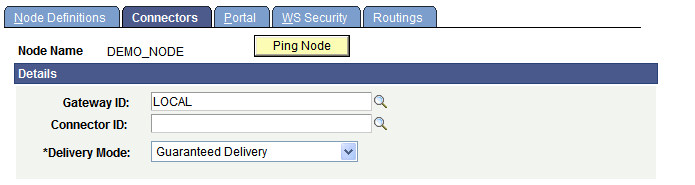

Use this page to specify the integration gateway and target connector the node uses for integrations.
At least one gateway with at least one target connector must be defined and configured. If the current node is remote, it can use the default local node’s gateway or any other installed gateway as its local gateway. If the current node has its own gateway installed, the default local node’s database must contain a definition for it, configured as a remote gateway.
Specifying a Gateway and Target Connector for the Current Node
To specify a gateway and connector for the current node:
  1. From the Gateway ID field, click the Lookup button to select the gateway ID for the gateway you want the current node to use.
    When the default local node sends a message to any other node, the message first goes to the default local node’s local gateway through its PeopleSoft listening connector, regardless of the gateway ID you select here.
    • If you specify a remote gateway ID, the local gateway uses its default remote gateway connector (specified in the integrationGateway.properties file) to route messages to the remote gateway through the remote gateway’s PeopleSoft listening connector. The remote gateway sends the messages directly to the current node, using the connector you specify in the next step.
      Note: The default remote gateway connector setting initially specifies the HTTP target connector, which is unlikely to change unless you develop a custom target connector.
    • If you specify the local gateway ID, the local gateway sends messages directly to the current node, using the connector you specify in the next step.
  2. From the Connector ID field, select a connector ID from the list of connectors registered with the selected gateway.
    Specify the target connector appropriate to the communication method preferred by the current node. If the node is a PeopleSoft application with Integration Broker installed, select PSFTTARGET. If the node is a PeopleSoft 8.1x application, select PSFT81TARGET.
    The rows on the Properties and Data Type/Description tabs are automatically populated with the connector’s properties that are designated Required in the gateway definition. The fields on these tabs are the same as those on the Connector Properties page. If the connector has multiple instances of a required property defined, only the instance designated as Default appears.
    See Editing Connector Properties.
  3. From the Delivery Mode drop-down list box, select a delivery mode. The options are:
    • Guaranteed. (Default.)
    • Best Effort.
    These options are discussed in detail elsewhere in this PeopleBook.
    See Setting Target Connector Delivery Modes.
  4. Click the Save button.

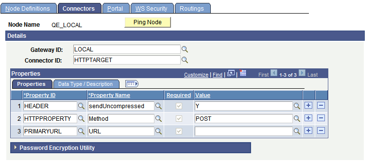

Working With Connector Properties
Properties that appear on the Nodes – Connectors page are copies of the specified connector’s required properties.
This example illustrates the Node – Connectors page with the HTTP target connector defined. The default properties for this connector appear in the Properties grid.
Nodes - Connectors page
You can use this page to:
  • Add an instance of a non-required property.
  • Add a new instance of a required property.
  • Modify the value or description of a property instance.
  • Remove a property instance.
Information about appropriate modifications might come from PeopleSoft, from the connector’s developer, or from your own experience and requirements.
Important! Don’t remove a required property unless you replace it with another instance of the same property. Without all of its required properties, the connector is unlikely to work correctly.
You must encrypt any password connector property values. The Connector tab features access to the Password Encryption Utility that enables you to encrypt a password value and paste it into the appropriate field on the page. To access the utility, click the Password Encryption Utility arrow.
