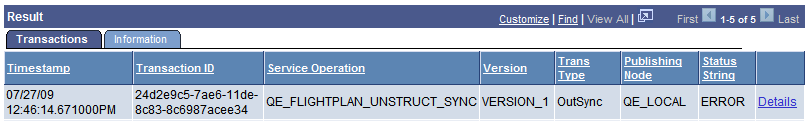

After you filter and search for synchronous service operations data on the Synchronous Services page, the output displays in a Results grid at the bottom of the page.
Use the Transactions tab on the Synchronous Services page to view information about the transactions, such as the time of the transaction, transaction ID, general service operation information, and more.
This example illustrates the fields and controls on the Transactions tab. You can find definitions for the fields and controls later on this page.
You can view the following data in the section:
Field or Control |
Description |
Timestamp |
Identifies the date and time that the service operation instance was last processed. |
Transaction ID |
Displays the transaction ID, the unique identifier that the system assigns to each transaction. |
Service Operation |
Indicates the name of the service operation. |
Version |
Indicates the version of the service operation. |
Trans Type |
Identifies the transaction type. Values are:
Publishing Node |
Indicates the sending node. |
Status String |
Displays the status of the transaction. |
Details |
Click the link to open the Synchronous Details page for the service operation to view more in-depth data about the transaction. |
