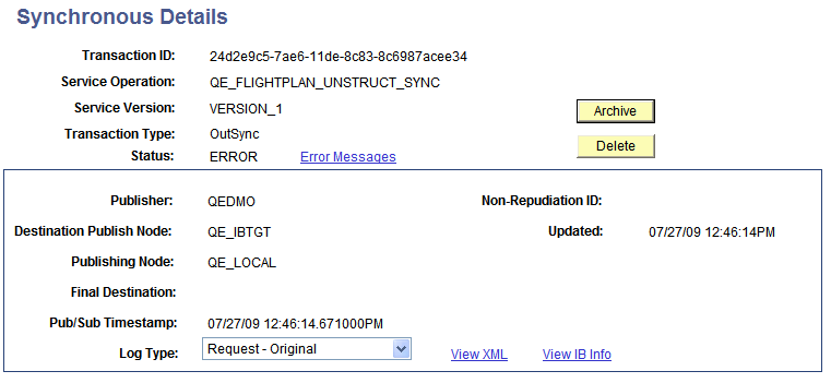

Viewing Synchronous Service Operation Details
The Synchronous Detail page provides read-only information about synchronous service operations in the system. It also enables you to view signature information for a service operation if it was processed with nonrepudiation logic.
To access the page, select
This example illustrates the fields and controls on the Synchronous Details page. You can find definitions for the fields and controls later on this page.
The page displays data in the following page elements:
Field or Control |
Description |
Archive |
Click the button to archive the synchronous service operation. |
Delete |
Click the delete button to delete the transaction from the database. |
Destination Publish Node |
Identifies the name of the node where the service operation was sent. |
Error Messages |
Click the link to view error messages associated with the processing of the service operation. |
Final Destination |
Identifies the name of the node of the final destination for the service operation. |
Log Type |
Select a value from the drop-down list box and click the View XML link to view the corresponding information. Note: For synchronous service operations, to view full service operation details in XML you must set a parameter in the routing definition for the service operation. On the Routing-Routing Definitions page, from the Log Detail drop-down list box select Header and Detail. Values are:
Non-Repudiation ID |
Identifies a unique number used to associate a service operation instance with the nonrepudiation log. |
Publisher |
Publisher of the service operation. This is usually the user ID of the person in the publishing system who triggered the publication. |
Pub/Sub Timestamp |
Identifies the date and time that the service operation instance was last processed. |
Service Operation |
Identifies the name of the service operation published. |
Service Version |
Identifies the version of the service operation published. |
Signature |
If a service operation is sent with a signature, a Signature link appears next to the Non-Repudiation ID field. When you click the Signature link, the service operation signature appears in XML format. |
Status |
Identifies the status of the service operation. Descriptions of the possible service operation statuses are described elsewhere in this topic. |
Transaction Type |
Identifies the transaction type. Values are:
Unique Identifier |
Displays the transaction ID, the unique identifier that the system assigns to each transaction. |
Updated |
Identifies the date and time the service operation was last updated. |
View IB Info |
Click the link to view IB info in XML format for the service operation, such as transaction ID. |
View XML |
Click to view the service operation content in XML format. |
