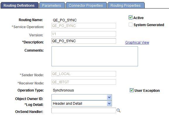

When you add a routing definition from a service operation record, the PeopleSoft system automatically populates some of the data on this page based on the data in the service operations record from which you created the routing. Automatically populated data includes the service operation name, version, and routing type.
Field or Control
Description
Routing Name
Indicates the name of the routing definition. This name is specified when you add a routing definition to the system.
Service Operation
Enter the name of the service operation that will use the routing.
If you access the Routings component from the Service Operations – Routings tab, PeopleSoft Integration Broker automatically populates this information.
Active
(Optional.) Select the check box to activate the routing.
By default, new routing definition are active.
If any of the referenced nodes are inactive, you cannot activate the routing.
System Generated
When selected, indicates that the PeopleSoft system generated the routing definition.
Version
Indicates the version of the service operation selected.
Description
Description of the routing definition. If you do not enter a description, this value defaults to the name of the service operation associated with the routing definition upon save.
Graphical View
Click this link to view saved routing definitions in graphical format.
See Viewing Routing Definitions in Graphical Format.
Comments
(Optional.) Enter comments about the routing definition.
Sender Node
Enter the name of the sending node.
Receiving Node
Enter the name of the receiving node.
Unordered Segments
(Optional.) Select the check box to indicate that system should process the service operation messages in parallel.
The Unordered Segments check box appears only under the following conditions:
  • The local node is the receiving node.
  • After you save the initial routing definition
This feature is frequently used in conjunction with the OnPreNotify Handler and OnPostNotify Handler fields to perform pre- or post-processing on segmented messages.
Operation Type
Indicates the service operation type. PeopleSoft Integration Broker automatically populates this information when you select the service operation.
User Exception
The User Exception check box displays only for synchronous service operations.
(Optional.) Select the check box to enable exception handling using PeopleCode.
When enabled and an error occurs you can handle any errors in the calling PeopleCode.
If not enabled any errors that occur cause the program to stop.
Object Owner ID
(Optional.) From the drop-down list box, select the owner of the definition.
The owner ID helps to determine the application team that last made a change to the definition. The values in the drop-down list box are translate table values that you can define in the OBJECTOWNERID field record.
OnPreNotify Handler
(Optional.) From the drop-down list box, select an OnPreNotify handler to perform pre-processing on segmented messages being processed in parallel by the system.
This page control appears only when the Unordered Segments check box is selected.
(Optional.) From the drop-down list box, select an OnPostNotify handler to perform post-processing on segmented messages being processed in parallel by the system.
Accept Compression
(Optional.) The Accept Compression check box displays only for inbound synchronous non-REST service operations.
Setting compression for REST service operations is discussed elsewhere in the product documentation.
See Setting Compression for REST Service Operations.
Select the check box for the system to send the response to the consumer compressed.
You must compress the response before sending, using PeopleCode or by setting the Min Message Size Compression parameter in PSAdmin.
You can override the compression of the response using PeopleCode by setting the CompressionOverride property on IBInfo. The following example shows sample PeopleCode to override compression of the response message:
&MSG.IBInfo.CompressionOverride = %IntBroker_Compress;
Set/Get property for Compression override.  Valid parms : %IntBroker_Compress, %IntBroker_UnCompress, %IntBroker_Compress_Reset
Log Detail
The Log Detail drop-down list box displays only for synchronous service operations.
This option enables you to set the level of information logging for synchronous messages that is viewable in the Service Operations Monitor.
The valid values are:
  • Header.
    Log header information only. With this option, you can view synchronous message header information in the Service Operations Monitor.
  • Header and Detail. Log header and message detail information. With this option, you can view synchronous message header information and XML message content on in the Service Operations Monitor.
    When you select this option for a consumer REST service operation routing, a Service Operation Security link appears and you can add permissions to the service operation. Doing so enables access to service operation details in the Service Operations Monitor.
  • No Logging. (Default.) Turn off all logging. No information is available to view in the Service Operations Monitor.
A Service Operation Security link appears when the selected routing definition is for an outbound REST-based service operation
Click the link to access the Web Service Access page and to add permissions to the view details for the service operation in the Service Operations Monitor.
OnSend Handler
This field displays when an OnSend handler is defined for the service operation and the sending node is the local node. It also displays when the system is serving as a hub, and neither the sender nor receiver are local.
Select a handler from the list. This handler runs when a message is sent or received to perform processing logic.
Schema Validation Details
This field displays only when working with any-to-local routing definitions.
(Optional.) When this check box is selected and a schema validation error occurs the raw schema parser errors are returned to the consumer within the default message CDATA tag. If the check box is not selected (Default) then if a schema validation error occurs the systems uses the standard message set/ ID framework to generate the error.
OnReceive Handler
This field displays when an OnReceive handler is defined for the service operation and one of the following conditions exists:
  • The sending node is the local node, or
  • The service operation type is asynchronous request/response where the sender is not local and the receiver is local, or.
  • The system is serving as a hub, and neither the sender (initiator) nor final receiver are local.
Use Secure Target Location
This check box appears only when you are working with an outbound asynchronous request/response service operation.
Select the check box to use the secure target location as the endpoint for the response. If the check box is not selected, the (unsecured) target location is used.

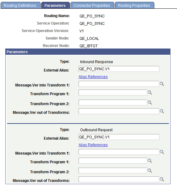

Defining Routing Parameters for Requests and Responses
Use the Routings-Parameters page (IB_ROUTINGDEFNDOC) to view and define parameters for requests and responses associated with a service operation. Information you define includes, routing external aliases for inbound and outbound requests and responses, as well as any inbound or outbound transformations to invoke.
To access the Routings - Parameters page, select PeopleTools > Integration Broker > Integration Setup > Routing Definitions and click the Parameters tab.
This example illustrates the fields and controls on the Routings – Parameters page. You can find definitions for the fields and controls later on this page.
The following page elements display on the Routings-Parameters page:
Field or Control
Description
Type
Specifies the routing direction and the type of message (request or response) associated with the service operation. This information is automatically populated from the service operation definition.
External Alias
This alias is used as a SOAPAction attribute in the WSDL binding to identify the service operation in the Integration Broker metadata.
The routing external alias defaults to <ServiceOperationAlias>.<Version>, if present. Otherwise it defaults to <ServiceOperation>.<Version>.
In an asynchronous request/response any-to-local routing, the outbound routing alias format is <Alias Name>_CALLBACK.<Version>.
For inbound transactions you can fire multiple service operations for one invocation when external aliases on the routing definition are the same for each service operation. This is called service operation mapping.
See Service Operation Mapping.
Duplicate external aliases are not allowed for synchronous operations.
See Searching for Duplicate External Routing Aliases.
Alias References
Click the link to view other routing definitions with the same external alias.
WS Security
This link appears on the Parameters page when you are working with:
Message.Ver into Transform 1
Displays the name of the request or response message associated with the service operation before any transformations are applied.
For inbound transactions, this is the message name and version as it arrives from the integration partner system, before any transformations are applied.
For outbound transactions, this is the message name and version directly from the PeopleSoft system, before any transformations are applied.
Transform Program 1
(Optional.) Enter the name of the transform program to invoke on the message listed in the Message.Ver into Transform 1 field.
Transform Program 2
(Optional.) Enter the name of the transform program to invoke after the transform program in the Transform Program 1 field has completed processing.
When you invoke two transform programs, the output from the first transform program (Transform Program 1) is used as the input into the second transform program (Transform Program 2).
Message.Ver out of Transforms
(Optional.) Enter the name of the message after all transform program have completed processing.
For inbound messages, this is the message name and version that the PeopleSoft system is expecting.
For outbound messages, this is the message name and version that the integration partner system is expecting.
When the Routings-Parameters page first displays values for the Message.Ver into Transform 1 and Message.Ver out of Transforms fields display values to assist you in choosing transform programs. After you save the page, values do not appear in these fields unless the transform programs have an input/output messages associated with them.
Note: Based on the transform selected, the message.version of the inbound request or response and the message.version of the outbound request or response that the system populated on the page can be different then those specified on the component. Should this occur a warning message displays and you can accept or reject the message.version information populated on the Routings - Parameters page. If you reject the message.version information populated on the page, you can modify the fields with the appropriate message.version information, or change the information that is specified on the component.

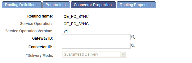

This example illustrates the fields and controls on the Routings – Connector Properties page. You can find definitions for the fields and controls later on this page.
Routings-Connector Properties page

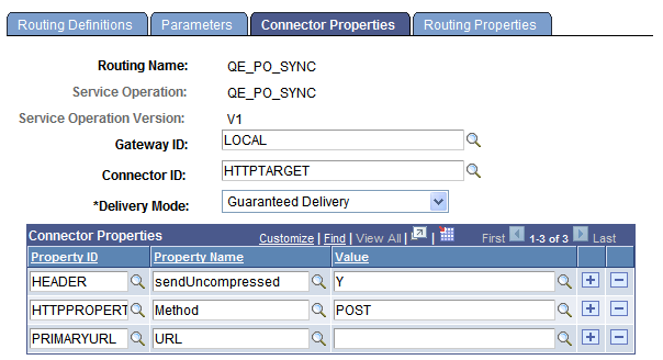

After you select an integration gateway and target connector with which to work, the system displays the required properties for the connector that you can set and override. To set or override additional properties add them to the properties list with the desired values.
This example illustrates the Routings – Connector Properties page. The example shows the properties for the HTTP target connector.
Routings - Connector Properties page
The Routings-Connector Properties tab features the following controls:
Field or Control
Description
Gateway ID
Click the Lookup button to select an integration gateway.
Connector ID
Click the Lookup button to select a target connector that resides on the gateway entered in the Gateway ID field.
After you select a target connector, its required properties appear.
Delivery Mode
Select one of the following options:
  • Guaranteed. (Default.)
  • Best Effort.
These options are discussed in detail elsewhere in the product documentation.
See Setting Target Connector Delivery Modes.
Save
Click the Save button to save your changes.
Overriding Default Integration Gateways
To override the default integration gateway, use the Gateway ID field Lookup button to select a gateway. You must also select a target connector on the new gateway to use and define properties for that connector.
Overriding Default Target Connectors
To override the default target connector on the default integration gateway, use the Gateway ID field Lookup to select the default gateway. Use the Gateway ID field Lookup to select a different target connector that resides on the gateway and then define properties for the new connector.
For REST-based services the connector ID default to HTTPTARGET and cannot be changed.
Overriding Default Connector Properties
To override the default target properties for the default target connector, use the Gateway ID field Lookup button to select the default gateway. Use the Connector ID field Lookup to select the default target connector and then adjust the gateway properties as appropriate.
HTTP header properties, those with the property ID of HEADER, are the only properties you can add for routings for outbound REST-based service operations.

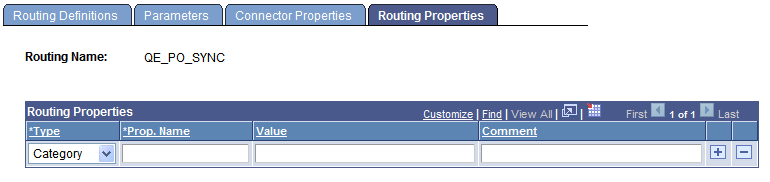

Use the Routings-Routing Properties page (IB_ROUTINGDEFNPROP) to add routing properties to a routing definition. To access the page select PeopleTools > Integration Broker > Integration Setup > Routing Definitions and click the Routing Properties tab.
This example illustrates the Routing Properties page.
