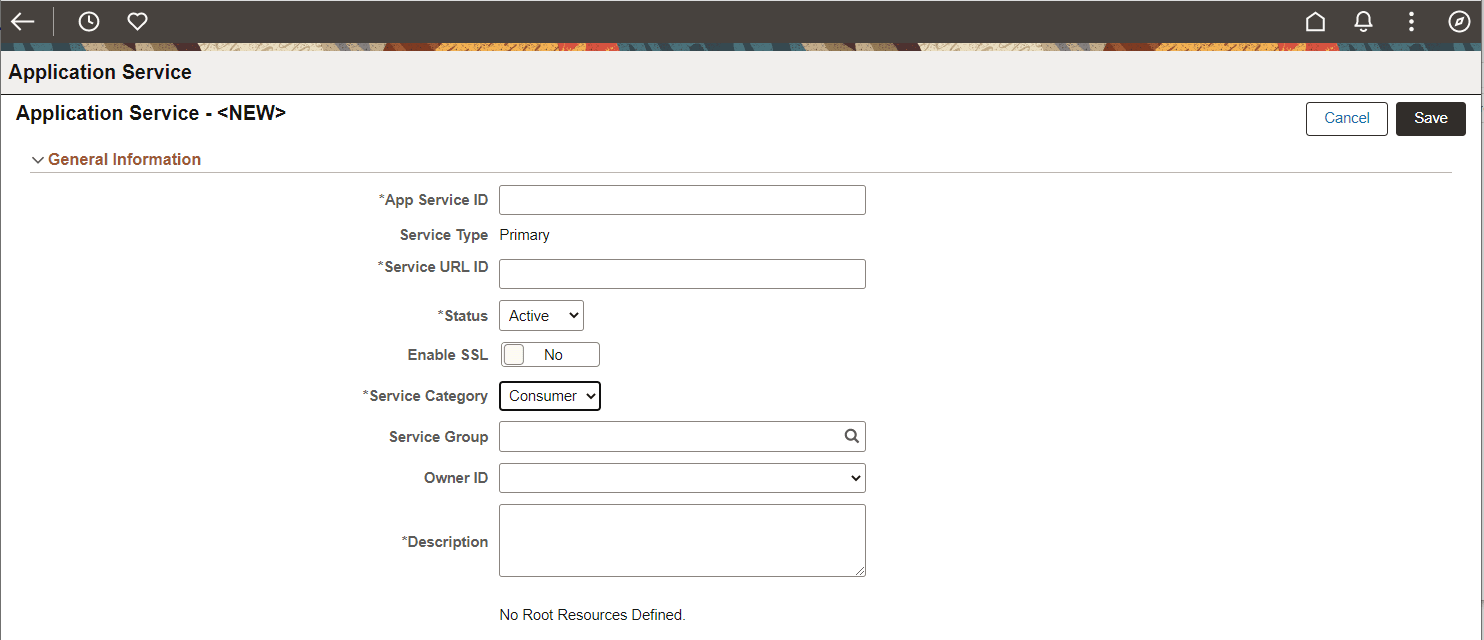

To create a new Consumer Application Service:
Select
Select Create Application Service.
This example illustrates the fields and controls on the Application Services – General Information page to create a new Consumer Application Service. You can find definitions for the fields and controls later on this page.
                                 Field or Control  |
                                 Description  |
                                 App Service ID  |
                                 Service ID for the Application Service.  |
                                 Service Type  |
                                 When you create a new Consume Application Service, the Service Type is Primary only.  |
                                 Service URL ID  |
                                 Service URL ID forms a part of the endpoint URL. It identifies the service to be executed.  |
                                 Status  |
                                 Status for the Application Service. When you create a new Application Service, the default Status is Active.  |
                                 Enable SSL  |
                                 Requires SSL for the Service to be invoked.  |
                                 Service Category  |
                                 Select Consumer.  |
                                 Service Group  |
                                 Used to group services together for search.  |
                                 Owner ID  |
                                 Owner of the Application Service.  |
                                 Description  |
                                 A description for the Application Service.  |
The Save action will perform the following:

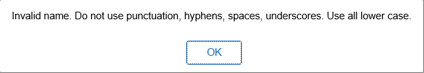

Verify that the Service URL ID value meets the Oracle standard for an URL value. If valid, the value will then be checked against Integration Broker Service Alias's to insure it is unique. If the value does not meet this criteria, a pop up message will be displayed.
This example illustrates the Service URL ID validation message.
                    Correct the Service URL ID and save the application service.

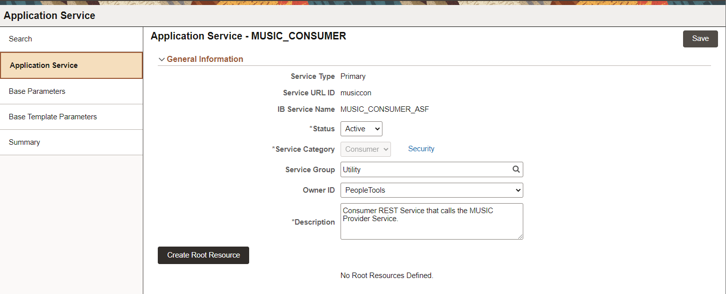

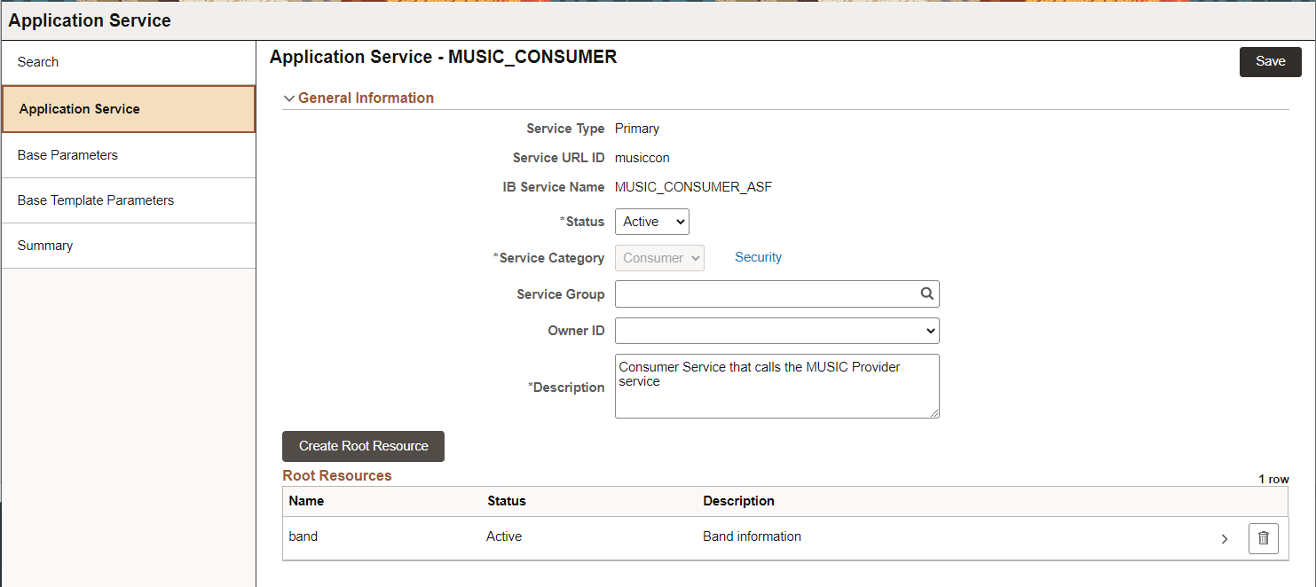

When the Service URL ID is valid, save processing will generate the necessary IB metadata, update the Service Name and enable the Create Root Resource button.
This example illustrates the fields and controls on the Application Service page for Consumer Application Service after Save. You can find definitions for the fields and controls later on this page.
                                 Field or Control  |
                                 Description  |
                                 Security  |
                                 Select this link to set the Security details.  |
                                 Create Root Resource  |
                                 Select this button to create a new root resource.  |
The Security link at the Service level can be used to update the security for all defined methods of the Service.

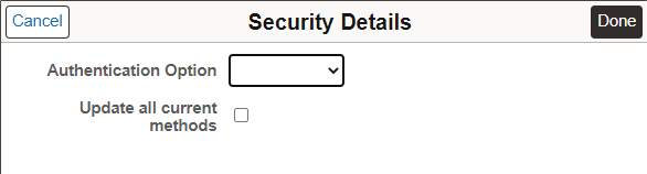

The provider of the integration will define what security will be required to invoke their integration(s). This can be Basic Authentication, oAuth2 or no security at all. For each method (integration) the appropriate security can be set by selecting the Security link. The developer can then select the Authentication Option.
This example illustrates the fields and controls on the Security Details page. You can find definitions for the fields and controls later on this page.
                                 Field or Control  |
                                 Description  |
                                 Authentication Option  |
                                 Authentication Option are Basic Auth or oAuth2  |
                                 Update all current methods  |
                                 Select this check box to propagate the security information to all the methods.  |

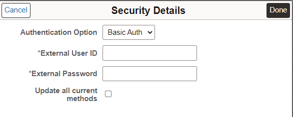

This example illustrates the fields and controls on the Security Details page when Basic Auth is selected. You can find definitions for the fields and controls later on this page
                                     Field or Control  |
                                     Description  |
                                     Basic Authentication  |
                                     External User ID  |
                                     User ID  |
                                     External Password  |
                                     User ID password  |

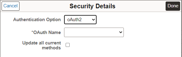

oAuth2
3rd party Authorization Service information should first be registered on the oAuth2 security pages see Creating a Service Application.
This example illustrates the fields and controls on the Security Details page when oAuth2 is selected. You can find definitions for the fields and controls later on this page.
                                     Field or Control  |
                                     Description  |
                                     Authorization Option  |
                                     oAuth2  |
                                     OAuth Name  |
                                     Select the OAuth name from the drop down list. All registered Service Applications are available from the drop down list.  |

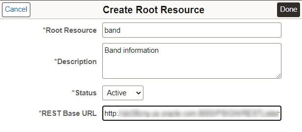

Use the Create Root Resource page to create a new root resource.
Select the Create Root Resource button from the Application Service page.
This example illustrates the fields and controls on the Create Root Resource page for a Consumer Application Service. You can find definitions for the fields and controls later on this page.
                                 Field or Control  |
                                 Description  |
                                 Root Resource  |
                                 The name of the Root Resource defined by the Provider.  |
                                 Description  |
                                 A description of the root resource.  |
                                 Status  |
                                 Status for the root resource. When a root resource is created, the default status is Active.  |
                                 REST Base URL  |
                                 The base URL as defined by the Provider Integration to be called.  |
Note: For the cases where a root resource cannot be established then any root resource name will do as long as it complies with the Oracle naming standards.

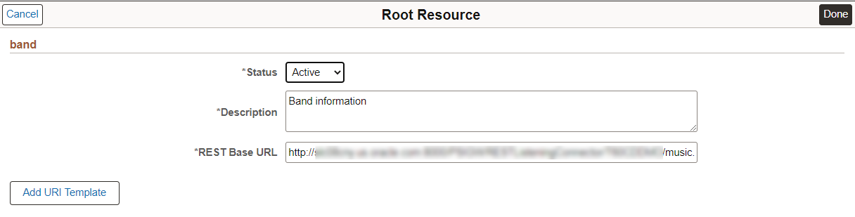

Once the root resource is created for the Application Service it is displayed on the page.
This example illustrates the fields and controls on the Application Service page after root resource is created.
            Select the Root Resource name to open the Root Resource page.
This example illustrates the fields and controls on the Consumer Root Resource page.
            Select the Add URI Template button to define the URI templates for this resource. See Adding URI Templates.
