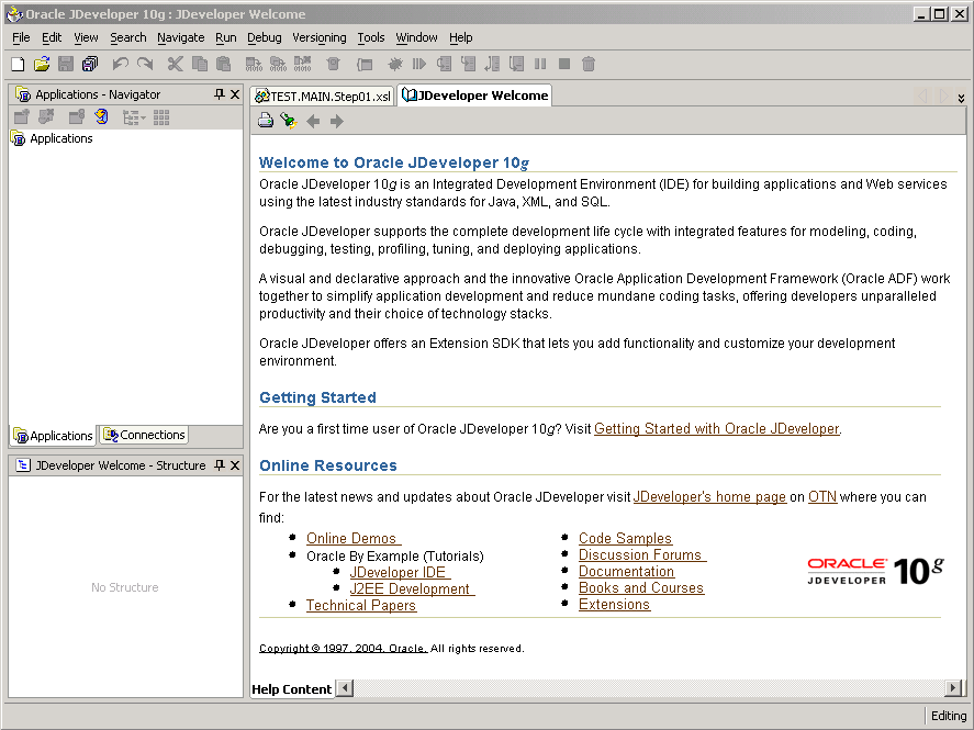

The first time you launch the mapper, the Oracle JDeveloper Welcome window appears.
This example shows the JDeveloper Welcome window.
Note: The first time you launch Oracle XSL Mapper a Configure Tile Type Associations dialog box appears. While using the mapper you do not work with any Java files and you can disregard the dialog box.
The Oracle JDeveloper Welcome window displays only the first time you access JDeveloper. When you subsequently open Oracle XSL Mapper, the transform program appears in the Design view.

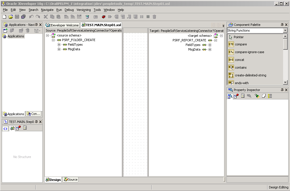

This example illustrates the Oracle XSL Mapper – Design view.

To access the Design view of Oracle XSL Mapper, click the Design tab at the bottom of the mapper.
This example illustrates the fields and controls on the Oracle XSL Mapper – Design view. You can find definitions for the fields and controls later on this page.
Use the Design view to map records and fields.
A few of the key areas of the Design view are discussed here. For additional information on Design view features, see the Oracle XSL Mapper documentation.

Source |
The Source pane in the Oracle XSL Mapper main development view provides a hierarchical view of the source or input message and schema. Click the Expand button (+) button and the Collapse button (-) to expand and collapse data shown. Drag the edges of the pane in or out to adjust the viewing area. |
Target |
The Target pane in the Oracle XSL Mapper main development view provides a hierarchical view of the target or output message and schema. Click the Expand button (+) button and the Collapse button (-) to expand and collapse data shown. Drag the edges of the pane in or out to adjust the viewing area. |
Design (tab) |
Located at the bottom left-side of the window, click the tab to display the area where you map records and fields. |

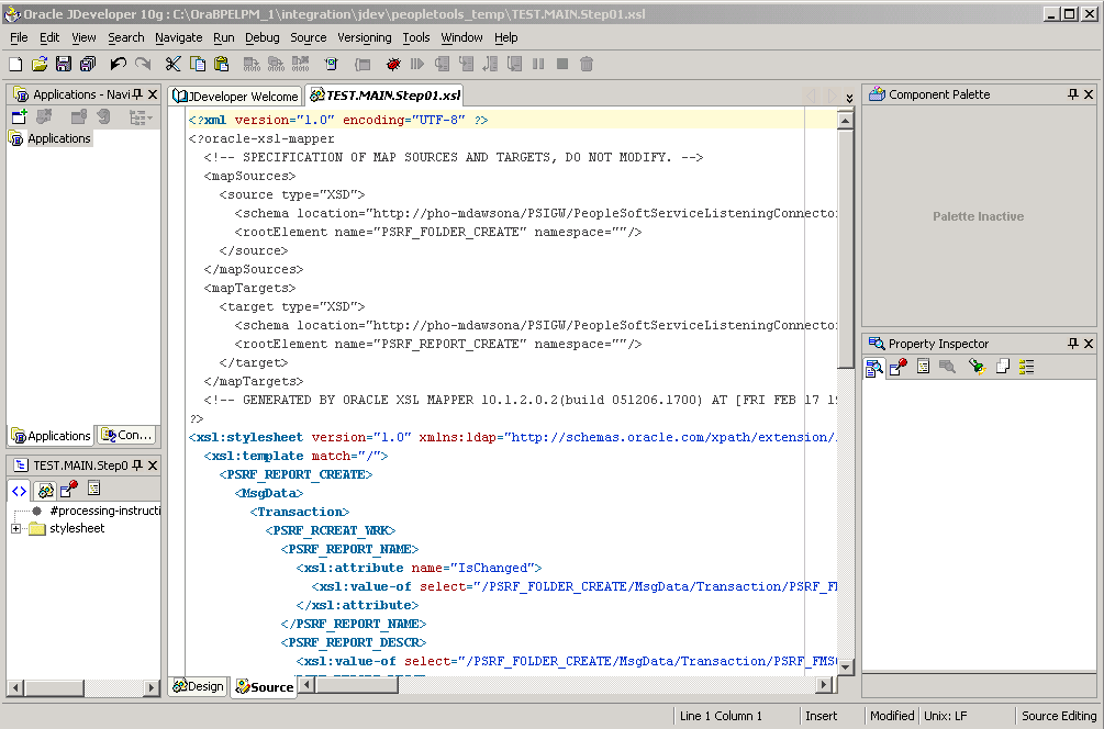

Navigating in the Source View
To access the Source view of Oracle XSL Mapper, click the Source tab at the bottom or the mapper.
This example illustrates the Oracle XSL Mapper–Source view.
Use the Source view to view and edit the raw XSL code generated by the mapper.
For additional information on Source view features, see the Oracle XSL Mapper documentation.

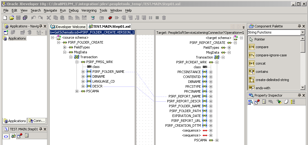

To map records and fields, use the Oracle XSL Mapper – Design view to drag record names and field names from the source pane to the target pane in the mapper.
A solid green line appears as you drag the cursor from the source pane to the target pane. When you release the cursor, the line turns blue to show the association.
To map records and fields:
Open the Design view of Oracle XSL Mapper.
Expand the contents of both the source and target panes.
Click the Expand button (+) to expand each level or section until all records and fields appear.
Note: When working with rowset-based messages the content to map is located in the MsgData section.
In the source pane, click on the icon to the left of a record or field name and drag it to the name of the record or field in the target pane to which you want to map.
Repeat this step for each record or field to map.
Click the Save button.
If you have not saved the program and want to delete the last map you made, simply right click in the Design view and select Undo Link. Otherwise, follow the instructions in this section.
To delete a record or field map:
In the source pane, click the record or field name.
From the Edit menu, click Delete.
Save the changes.

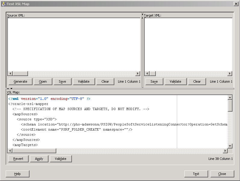

You can test XSL maps for validity that you generate in the mapper using the Test XSL Map window. To access the Test XSL Map window, right-click anywhere in the code area and select Test.
This example illustrates the Test XSL Map window.
The code created by the record and field mapping displays in the bottom portion of the window.
Note: This Oracle XSL Mapper test feature tests the validity of the XSLT map code. It does not test the transformation. To test a transformation, use the Transformation Test tool in the PeopleSoft Pure Internet Architecture.
To test XSLT code:
Access the Oracle XSL Mapper–Source view.
Right-click anywhere in the code area and select Test.
The Test XSL Map window appears.
In the XSL Map section of the window, click the Validate button.
A validation success or error message displays.

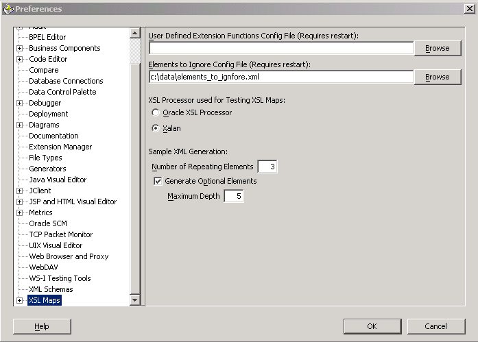

Specifying Elements to Ignore Configuration Files in Oracle XSL Mapper Preferences
Once you create the file of PeopleSoft elements to ignore, enter the file location and name in the mapper Preferences dialog box.
This example illustrates the Preferences dialog box in the Oracle XSL Mapper.
To specify an elements to ignore configuration file in Oracle XSL Mapper preferences:
In Oracle XSL Mapper, from the Tools menu, select Preferences.
The Preferences dialog appears.
In the list on the left-side of the window, click XSL Maps.
In the Elements to Ignore Conf. File (Requires Restart) field, enter or browse to the location of the elements to ignore configuration file that you created.
Click the OK button.
You must restart Oracle JDeveloper for the system to recognize the configuration file.
