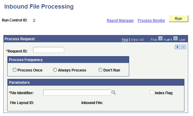

Use the Inbound File Processing page (PSIBFILERUNCNTL) to initiate flat file processing. Select .
This example illustrates the fields and controls on the Inbound File Processing page. You can find definitions for the fields and controls later on this page.
Field or Control  |
Description  |
Request ID  |
 Enter a unique identifier to track the request.  |
Process Frequency  |
 Select the frequency for processing the file. The options are:
File Identifier  |
 Select or enter the name of the file identifier that you set up in the Inbound File Loader Rules. page. The file identifier is tied to the publish rules.  |
Index Flag  |
 A read-only field that indicates if the file being processed is an index file or a data file. When checked, the Inbound File Loader utility is processing an index file.  |
File Layout ID  |
 A read-only field that displays the file layout ID associated with the file in the Inbound File Loader Rules page.  |
Inbound File  |
 A read-only field that displays the name of the file being processed.  |
